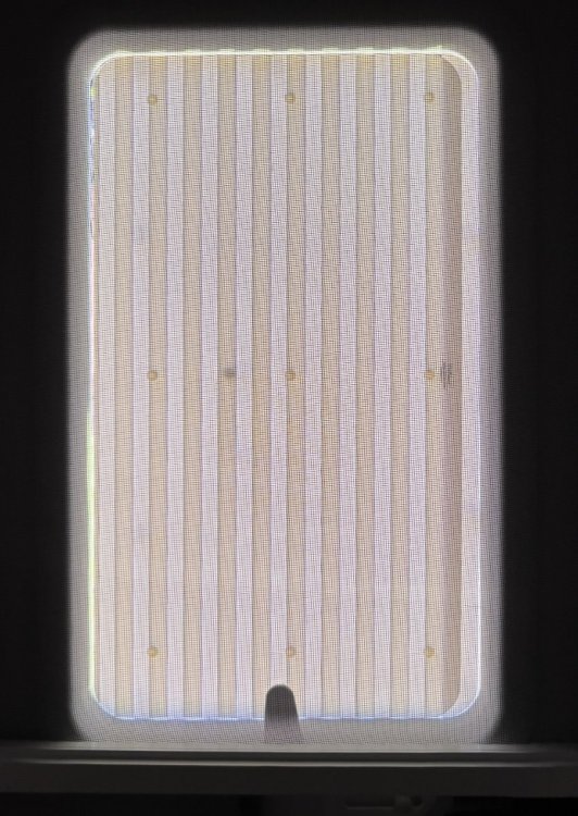

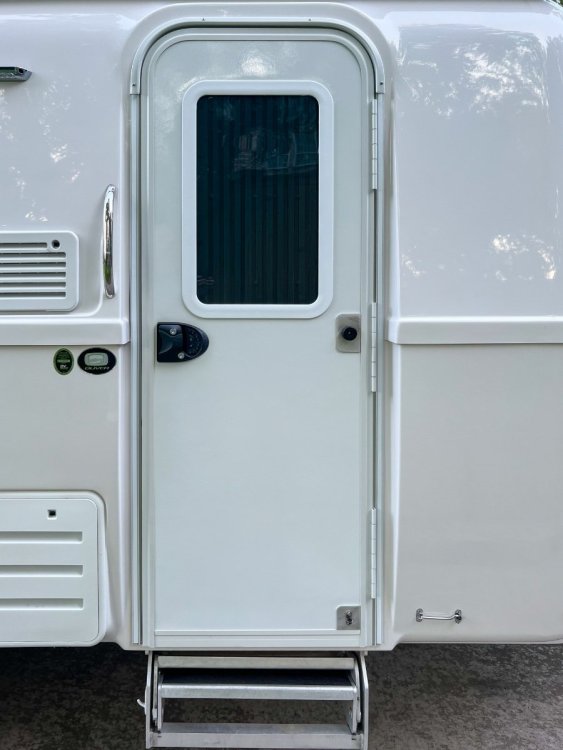

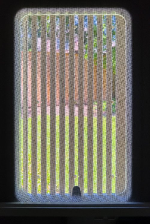

On Friday, I took our LEII to the Zarcor Solutions facility in Addison, TX (a burb north of Dallas) for installation of a tinted window for our entry door and Zarcor's Closures Shutter Blind and the video recording of the installation.
John Harder, President of Zarcor, had previously sent me a sales receipt showing the cost of the parts as $149.00 and installation labor of $120.00, for a total of $269.00.  The sales receipts also showed a discount of $269.00 for allowing Zarcor to use our trailer to make an installation and sales video.  Thus the cost to me was $0.00.
John's team demonstrated their experience by carefully removing the inner trim from our entry door to remove the standard textured glass.  I had previously seen photos posted on the OTT Forum where the fastener tabs which retain the inner trim had been broken during removal.  Javier, the primary installer, carefully inserted the plastic release tabs into the slots around the inner trim.  Several fastener locations could not immediately be released.  Javier's experience became evident as he continued to work the release tabs until all of the fasteners released, undamaged.  The RVLock 4.0 which I had installed post delivery had to be removed to permit access to the slots to free the fasteners on the lower right corner.
Once the inner trim was removed, the textured glass was easily removed and the new clear,  tinted glass inserted, with new sealing caulk around inside of the frame.  The outer window trim was not removed, retaining its factory seal.
Once the tinted glass was in place the Clozure Shutter blind, consisting of two sheets of acrylic, was fastened to the inside of the glass with small Velcro disks.  Each acrylic sheet is coated with vertical white stripes approximately 3/4" wide, alternating with clear stripes.  The acrylic sheet against the glass is fixed, while the other sheet slides approximately 3/4" left/right to open/close the shutter. Moving the acrylic sheet causes its white stripes to cover the clear areas of the fixed acrylic sheet, preventing light from entering.  A plastic handle attaches to the movable acrylic sheet and rides on two screw mounted glides to move left and right.  The two acrylic sheets which form the shutter are easily removed for cleaning.
A minor interference problem was encountered, with the open/close handle not able to move fully due to the position of the RVLock.  Zarcor will modify the handle slightly to eliminate the interference issue and provide a replacement handle.  The entire installation, with video recording, took approximately one and a half hours.
We are pleased with the new window and the operable shutter.  We now have visibility through the window in the entry door and a means of controlling entry of light to the cabin.  The tinted window closely matches the other windows in the trailer.  During the day there is little or no visibility into the cabin through the new tinted glass.  At night, with lights on in the cabin, there is some visibility from the outside.  With the shutter closed there is no visibility into the trailer and nearly all light is blocked.
Although we have owned the trailer a short time, we quickly learned the textured window admitted a lot of light from the early morning sun.  It also admitted light at night from nearby campground lighting.  These problems are solved by the Clozures Shutter Blind.
The Zarcor team indicated the processing of the installation video would take a couple of weeks before it is posted to the Zarcor website.  I will post an update when the installation video is available.  Below are photos from the completed installation.
Exterior view of door with shutter blind open
Interior view of closed shutter blind
Interior view of open shutter blind
