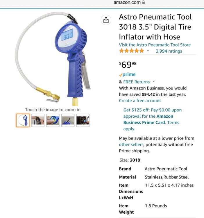

John E Davies Posted August 16, 2022 Share Posted August 16, 2022 I assume you mean one that inflates as well as has a gauge….. you are correct, most are garbage. You have to pay for a decent one. I have had this for four years and it has been great. Highly recommended, if mine broke or disappeared I would buy another one without hesitation. These inflators are bulky and not great for travel, mine hangs from a hook on the wall directly over my shop air compressor. I carry a cheaper analog gauge when on the road, to use with my Smittybilt high volume (almost 6 cfm) low pressure compressor. Astro Pneumatic Tool 3018 3.5" Digital Tire Inflator with Hose I have a couple of other Astro tools, they seem to be a good combination of value and quality. John Davies Spokane WA 3 SOLD 07/23 "Mouse": 2017 Legacy Elite II Two Beds, Hull Number 218, See my HOW TO threads: Tow Vehicle: 2013 Land Cruiser 200, 32” LT tires, airbags, Safari snorkel, Maggiolina Grand Tour 360 Carbon RTT. Link to comment Share on other sites More sharing options...

Guest Posted August 17, 2022 Share Posted August 17, 2022 1 hour ago, John E Davies said: have had this for four years and it has been great. Highly recommended I have that one also! It has worked great. I have had it for over 2 years. Link to comment Share on other sites More sharing options...

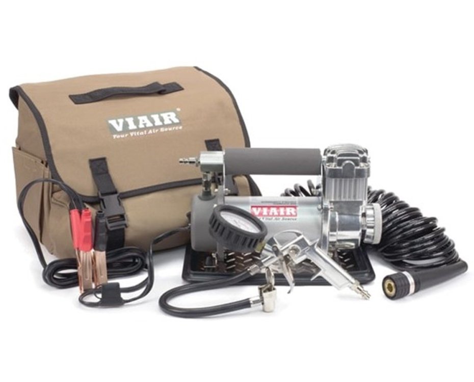

Steve Morris Posted August 17, 2022 Share Posted August 17, 2022 The Viair 400P-Auto is recommended on many off road and travel forums for a portable compressor/inflator. I have the 450P auto. The 450 has a 200% duty cycle while the 400 has 33%. But the 400 pumps 2.3 cubic feet of air per minute, while the 450 does only 1.8. So either works fine. both have auto power at the nozzle, so when you release the lever the compyturns off. The non-auto versions only have the switch on the compressor itself. https://www.amazon.com/dp/B000X9B32M/ref=emc_b_5_mob_t 4 ----- Steve - Northern Ohio, USA Wandering around on occasion, always lost. 2021 Toyota Land Cruiser - 2023 Oliver Elite II Twin Hull #1360 “Curiosity” Facebook - Instagram Camped in Curiosity = Green —— Visited with Curiosity = Gray Link to comment Share on other sites More sharing options...

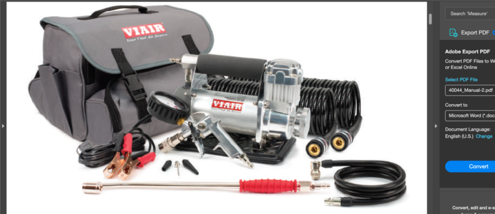

MobileJoy Posted August 17, 2022 Share Posted August 17, 2022 8 hours ago, Steve and Deb said: The Viair 400P-Auto is recommended on many off road and travel forums for a portable compressor/inflator. I have the Viair 400P-RVS and it works very well. If your goal is to air down and reinflate, it seems the 450 version might be better for you. My goal is to maintain tire inflation (i.e., top off) and to handle emergencies, so the 400 works well enough for me. The RVS version comes with an extension hose so it will reach all tires on the Oliver and the F250 when powered from the truck battery. 5 2021 Elite II Twin #850 "Mojo", 2020 F250 Lariat 7.3L FX4 3.55 Link to comment Share on other sites More sharing options...
Patriot Posted August 17, 2022 Share Posted August 17, 2022 9 hours ago, Steve and Deb said: The Viair 400P-Auto is recommended on many off road and travel forums for a portable compressor/inflator. I have the 450P auto. The 450 has a 200% duty cycle while the 400 has 33%. But the 400 pumps 2.3 cubic feet of air per minute, while the 450 does only 1.8. So either works fine. both have auto power at the nozzle, so when you release the lever the compyturns off. The non-auto versions only have the switch on the compressor itself. https://www.amazon.com/dp/B000X9B32M/ref=emc_b_5_mob_t I have a ViaAir and carry it full time in my TV. It has served us well. If you have an SUV and are short on cargo and storage capacity just know this will take up a fair amount of room. Shop around for the best price. 2 2020 OLEII - Hull #634 aka- “XPLOR” TV 2021 F350 6.7 liter Diesel Lariat Ultimate Tremor Retro upgrades - Truma Aventa 13.5 AC, Alcan 5 leaf pack, Alcan HD shackles & HD wet bolts, 5200lb axles. XPEL 10 mil PPF front both front corners, 30 lb LP tanks, Sea Biscuit Front Cargo Storage box. North Carolina 🇺🇸 Link to comment Share on other sites More sharing options...

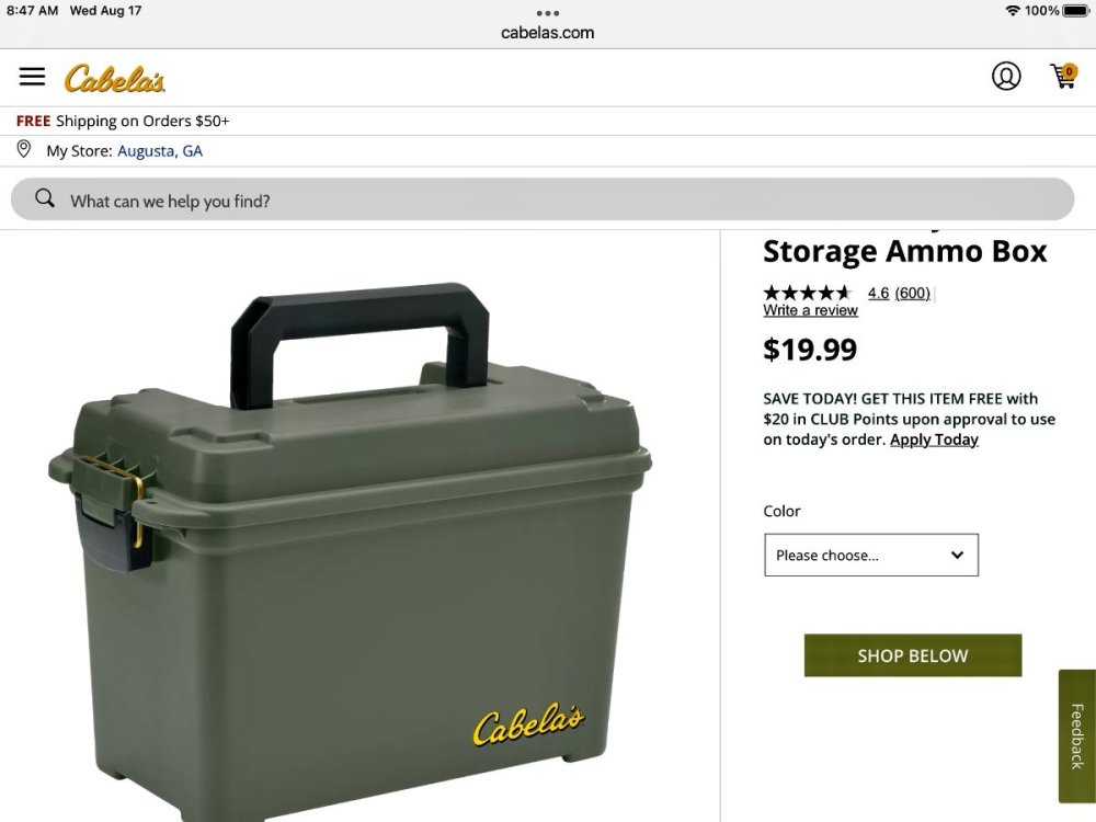

Steve Morris Posted August 17, 2022 Share Posted August 17, 2022 42 minutes ago, Patriot said: If you have an SUV and are short on cargo and storage capacity just know this will take up a fair amount of room. In the supplied bag, yep! The 450P, hose, power cord, and nozzle/gauge fit nicely in a Cabela’s plastic ammo can. Still occupies the same volume, but easier to stack. A tip I found a few years ago on the Toyota 4Runner forum. 5 ----- Steve - Northern Ohio, USA Wandering around on occasion, always lost. 2021 Toyota Land Cruiser - 2023 Oliver Elite II Twin Hull #1360 “Curiosity” Facebook - Instagram Camped in Curiosity = Green —— Visited with Curiosity = Gray Link to comment Share on other sites More sharing options...
Moderators mossemi Posted August 17, 2022 Moderators Share Posted August 17, 2022 20 minutes ago, Steve and Deb said: In the supplied bag, yep! The 450P, hose, power cord, and nozzle/gauge fit nicely in a Cabela’s plastic ammo can. Still occupies the same volume, but easier to stack. A tip I found a few years ago on the Toyota 4Runner forum. Is this the ammo can you are referring to? Mossey 2 Mike and Krunch Lutz, FL 2017 LEII #193 “the dog house” Link to comment Share on other sites More sharing options...

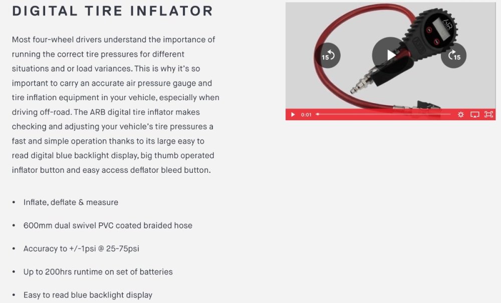

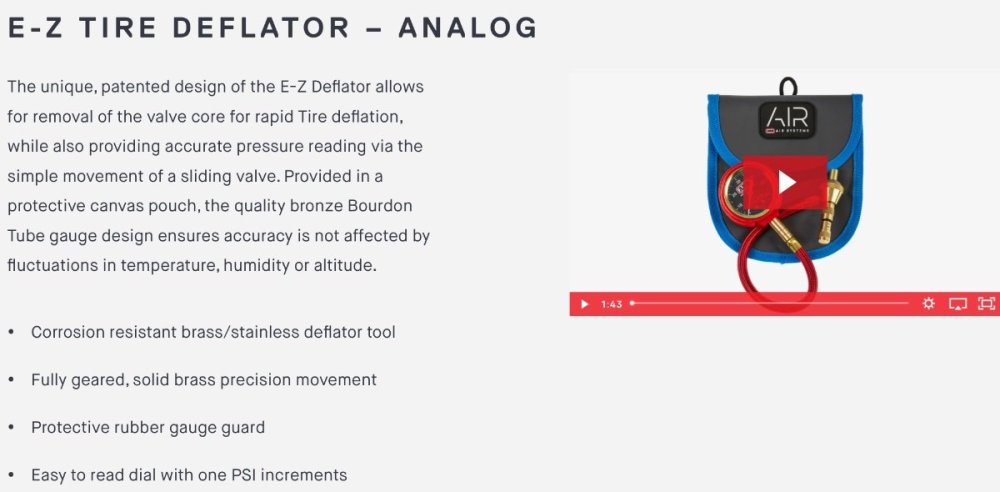

BBL Posted August 17, 2022 Share Posted August 17, 2022 (edited) I have used the Viair 400 RV model for over three years now and it is an awesome setup. However, and this is just personal preference, I don’t use their inflator. I use an ARB digital inflator/deflator that I have had since my off-roading days. I also have a dedicated ARB deflator with an analog gauge. What I like about the deflator is that it will rapidly deflate a tire in a controlled environment by removing the valve stem and keeping it captured in a sleeve. The advantage of this is that you can reduce the air in your tires quickly and then ensure your valve stem is seated properly each time. Edited August 17, 2022 by Brian and Brandelyne Lewis Spelling 1 Link to comment Share on other sites More sharing options...
John E Davies Posted August 17, 2022 Share Posted August 17, 2022 Brian, what precision does the ARB inflator have, does it read tenths of a psi? The Astro does, and is super easy to over inflate slightly, then drop the pressure exactly from say 42.1 to 42.0 psi. I quite like the ARB one and might have bought it instead, I am a huge ARB fan though their stuff is really over-priced. An overland rig with ARB parts all over and inside it represents an owner with very deep pockets. This thread is drifting way off topic because we still don't know what John C Marsh Jr actually wants to do with it.... from the picture in his post I can guess he isn't going off-road. 😉 John Davies Spokane WA 2 SOLD 07/23 "Mouse": 2017 Legacy Elite II Two Beds, Hull Number 218, See my HOW TO threads: Tow Vehicle: 2013 Land Cruiser 200, 32” LT tires, airbags, Safari snorkel, Maggiolina Grand Tour 360 Carbon RTT. Link to comment Share on other sites More sharing options...

Steve Morris Posted August 17, 2022 Share Posted August 17, 2022 3 hours ago, mossemi said: Is this the ammo can you are referring to? Yep! Note that I don't have the RV version, so I don't know if the additional hose length would fit. I also have one with tools in it. I use the included Viair inflator and gauge to inflate my Land Cruiser and current Hiker trailer tires, but usually overinflated a bit. Then bring them down to the desired pressure using an accurate gauge from my autocross days. I also have auto-deflation gizmos for off-roading. Screw them on and they drop to the pre-selected pressure. 3 ----- Steve - Northern Ohio, USA Wandering around on occasion, always lost. 2021 Toyota Land Cruiser - 2023 Oliver Elite II Twin Hull #1360 “Curiosity” Facebook - Instagram Camped in Curiosity = Green —— Visited with Curiosity = Gray Link to comment Share on other sites More sharing options...
BBL Posted August 17, 2022 Share Posted August 17, 2022 59 minutes ago, John E Davies said: Brian, what precision does the ARB inflator have, does it read tenths of a psi? The Astro does, and is super easy to over inflate slightly, then drop the pressure exactly from say 42.1 to 42.0 psi. I quite like the ARB one and might have bought it instead, I am a huge ARB fan though their stuff is really over-priced. An overland rig with ARB parts all over and inside it represents an owner with very deep pockets. This thread is drifting way off topic because we still don't know what John C Marsh Jr actually wants to do with it.... from the picture in his post I can guess he isn't going off-road. 😉 John Davies Spokane WA John, I agree with you on a couple of points. First, the ARB is expensive but built very well. These are the only two ARB products I own, for that reason. It does do tenths of a PSI, so I like that aspect of it. Batteries last a long time and there is an indicator. The built-in deflator button (most have this feature) is handy as well. I like the ARB fridge but, dollar for dollar, my Truma 60 QT is a better value though not cheap by any measure. Yeah, anyone fully equipped with ARB and Old Man Emu products has very deep pockets. Second point, it is getting way off track. Brian 3 Link to comment Share on other sites More sharing options...
