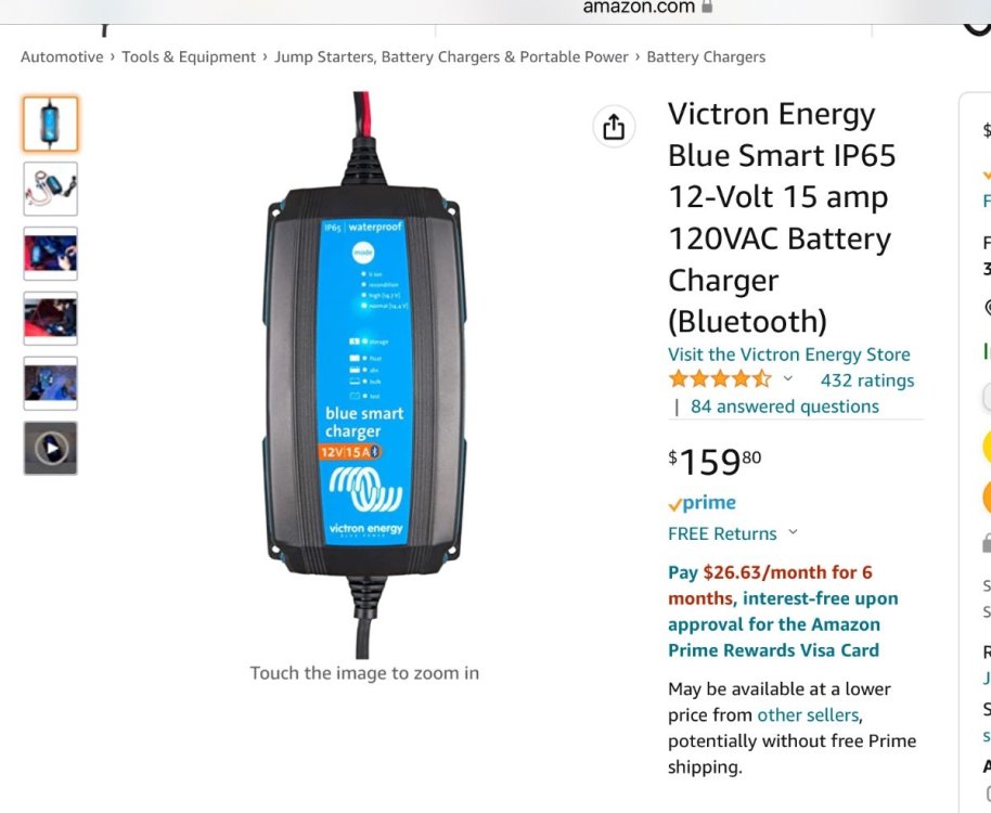

MobileJoy Posted October 26, 2022 Posted October 26, 2022 On 10/15/2022 at 1:15 AM, Rivernerd said: Reuben, the helpful gentleman from Lithionics who called me in response to my email message, was not sure. But he did advise that one of the KF series chargers Lithionics sells would keep the G31 batteries safe over the winter, in conjunction with the external battery heater installed by Oliver. He recommended the KF12V20DL, which is a 20A, 12V Lithium battery charger. I opened a case with Oliver parts asking if they carry the Lithionics KF12V20DL charger. Ryder told me they do not list this as a part that they carry. I also have sent an email to Lithionics asking about it, no response yet. Their website does list a number of "where to buy" websites. The only price I saw is $299. 2021 Elite II Twin #850 "Mojo", 2020 F250 Lariat 7.3L FX4 3.55
John E Davies Posted October 26, 2022 Posted October 26, 2022 1 hour ago, MobileJoy said: I opened a case with Oliver parts asking if they carry the Lithionics KF12V20DL charger. Ryder told me they do not list this as a part that they carry. I also have sent an email to Lithionics asking about it, no response yet. Their website does list a number of "where to buy" websites. The only price I saw is $299. There is no need to spend $300 (!!!) on a Lithionics charger, any name brand lithium capable one will do, I personally would steer well clear of any $50 no-name Chinese clone. I would pick this Guide: …. Blue Smart Charger John Davies Spokane WA 5 SOLD 07/23 "Mouse": 2017 Legacy Elite II Two Beds, Hull Number 218, See my HOW TO threads: Tow Vehicle: 2013 Land Cruiser 200, 32” LT tires, airbags, Safari snorkel, Maggiolina Grand Tour 360 Carbon RTT.
