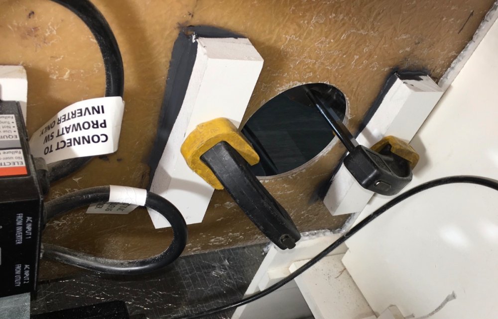

You may want to try unscrewing the cover from the street side hole in front of the inverter and see if you experience the same improvements in basement temperatures that I did.

A 4" deck plate hatch is available from Amazon for about $12.
https://smile.amazon.com/gp/product/B08VJ1S1KC/ref=ox_sc_saved_title_1?smid=A2QJ57U0XMN4Q0&psc=1

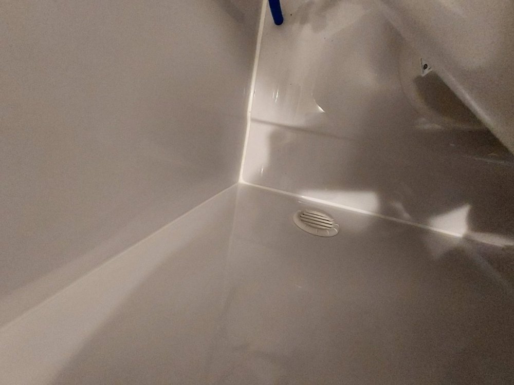

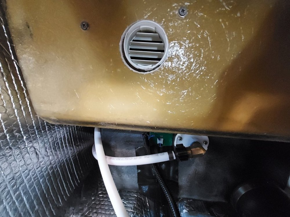

Attached is a photo of what I believe to be a bathroom return air vent in our new Hull #1291 Elite II.  It is on the back side of the aft bathroom wall, right above the black tank flush/check valve, and therefore accessible from underneath the front dinette seat.
The second attached photo is shot from the bath side.   I suspect the return air is expected to make its way back to the furnace through the area under the floor.
You will note that the forced air vents are smaller than in previous models.  I believe this is because we were the third Elite II upgraded to the Truma AC/VarioHeat furnace package.  The air ducts are smaller diameter, but much more substantial than I have seen in photos previously posted on this forum.  Maybe Oliver added return air vents as part of this upgrade?
For what it's worth, a cold front moved into Tennessee last night.  It has been in the high 30's today, with lows for tonight forecast to be in the mid-20's.  We have run the furnace most of the day, with the bathroom door closed, yet it has been only a bit cooler in the bath than in the main cabin.  I suspect that small return air duct has helped balance the flow of heated air to the bathroom.

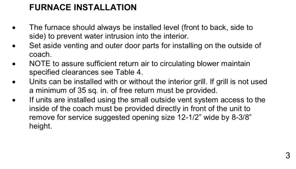

The reason Oliver installs that huge vent right beside the furnace fan is because that is specifically required by the manufacturer’s installation instructions. You can go ahead and add return air paths far away, just be sure the total square inches is equivalent to that big grill. I plan to do this, I will be removing my Dometic fridge for maintenance and I am going to see about making a return grill at the entry door down low, forward of the fridge.
Once you have plenty of air return, from different areas of the hull, then you can block off and sound insulate the existing air return, which will dramatically quiet the furnace. This is a future How To article, assuming it works out.

There are basic rules that apply in almost all mechanical air movement (think physics.)  You need more return air available than air supplied (think sizing of vents/ducts.)  The further the return from the unit, the more resistance in that returning air (think restriction similar to water/hydraulic piping.)  Supplied air that cannot return requires the unit to seek that missing air from elsewhere (shutting the bathroom door stops the bathroom circulation and if the bathroom vent/window is open it then requires the unit to suck air from around cabin windows, doors, weeps, etc.)  And then the one that everyone is complaining about...  "short cycling" refers to air that returns to the unit from a supply vent located too close to the return air - perhaps the simple solution to that is using a 12v fan on low to stir/mix the cabin air - that works.

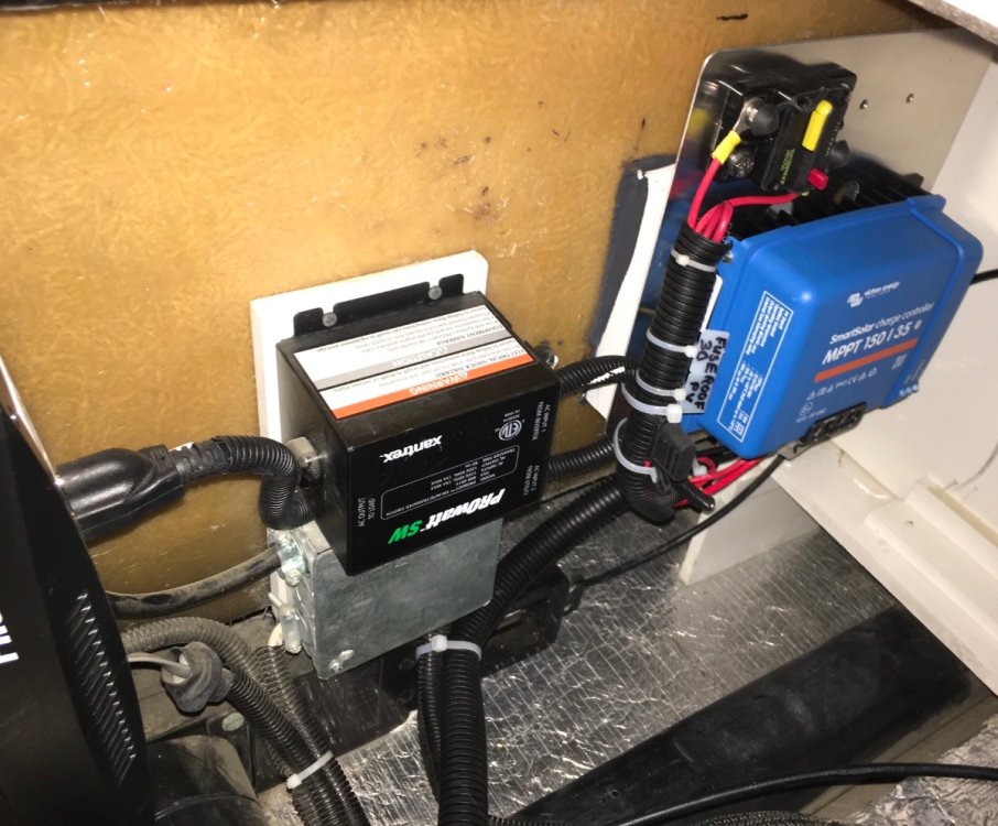

I wanted ventilation for that HOT compartment in warm weather. This also functions as another furnace return air path.
https://olivertraveltrailers.com/forums/topic/5329-how-to-victron-mppt-solar-charge-controller-underneath-the-street-side-bed/
