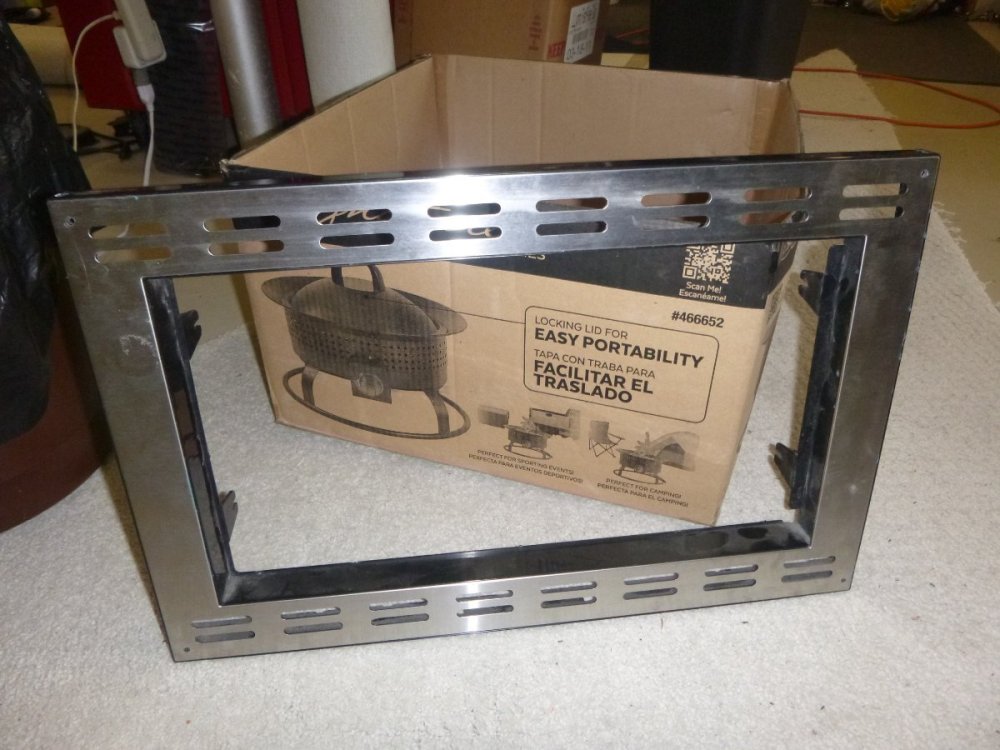

I have an 2018 Elite.  The trim/fascia for the microwave  sheared apart in the middle on the right side and I need to replace.  Any ideas?  Don't want my microwave  falling out when I am on the road.
If your microwave trim is like this one then it actually does not "hold" the microwave in place - it is basically just a trim piece.
However, if this trim piece had cracked or become notably loose then it just might indicate that your microwave is not held in place as it should be.  And/or you have been down some very rough roads.
This microwave is actually held in place (basically) by being attached to the upper cabinet via the screws that go through the two holes (barely seen in the photo below) at the rear of the metal piece that approximately spans the middle of the microwave.
Once you remove the trim piece then reach in, grab the microwave and try to move it from side to side.  If you can move it without too much force then it is likely that either this support attachment has come loose or isn't there at all.  Jason Essary can assist you in making repairs - just open a Service ticket.

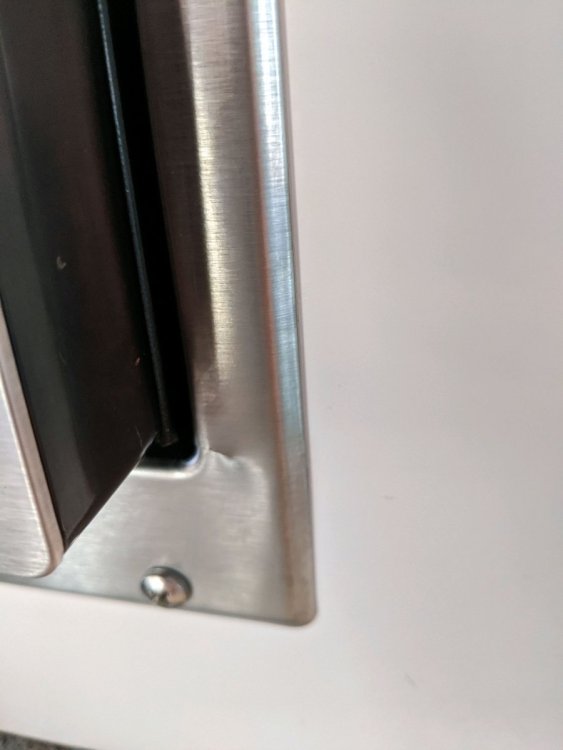

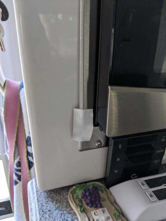

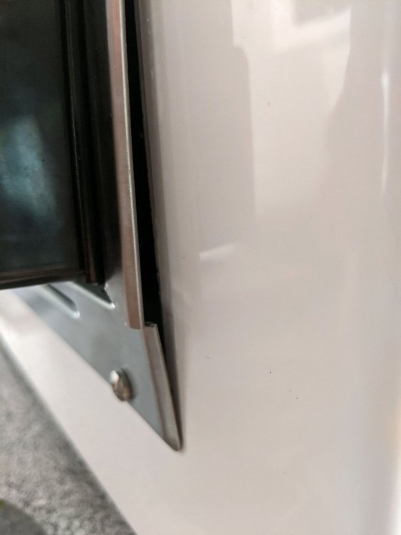

*Hull #1045, 2022 Picked up 3/10/22
*Noticed 3 corners of microwave skirt split, 6/10/22
*Oliver sent a replacement
* By Fall of 2022 at least 2 corners split again
*3rd one installed by Oliver on 2/20/23 under warranty. Oliver installed some type of shims
*2/27/23 the bottom right corner split, so one week after being replaced for the 3rd time
My brain is a bit hazy as to whether I communicated this to Oliver or just kind of gave up.
Picture #1 taken in June 2022
Picture #2 taken in June 2022
Picture #3 taken 2/27/23, on week after it was replaced for the 3rd time.
I'm guessing that Oliver Service would be able to tell you - assuming that you opened or added to a Service ticket.
Good luck!
Bill.
p.s.  We do not have the same type of installation as you do. but, when I was having similar issues with my 2016 I wound up taking the facia trim off, shimming (with scrap pieces of wood) the microwave in such a manner that a earthquake would not move it and replaced that trim. Haven't had a problem since.
Went back through this thread. It was October they shorted up theicrpwave and replaced the trim for the 3rdntime, not this past February
So I went from late October 2022 until 2/27/23 when I discovered the new crack. I need to check and see if I started another ticket in February, which O would have been still iny 1 year
 Not really concerned either way.
JD
