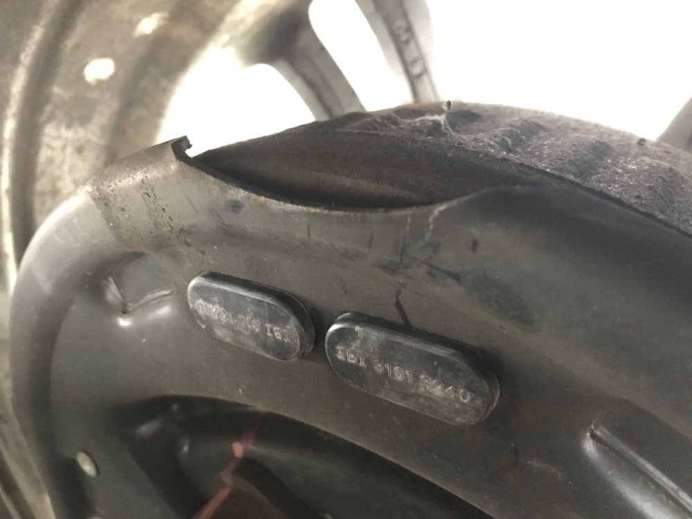

The drum brake backing pads do not have rubber plugs to protect the adjustment mechanism from road grit.
I just ordered two sets of 4 rubber brake backing plate adjuster plugs from Amazon for a total of $13.50.  Link below:
https://smile.amazon.com/gp/product/B002EP9U50/ref=ppx_yo_dt_b_asin_title_o00_s00?ie=UTF8&psc=1
Apparently, Oliver's choice to not provide these plugs with the Dexter drum brakes is not unique.  I found reviews noting that other folks' RVs did not come with these either.  It's a cheap and easy preventive measure.

What do they do and is there a picture of a before and after placement of these plugs?

There are access holes on the backside of the brakes that allow you to adjust the brake shoes.   Inserting rubber plugs  in the holes help prevent water and dirt from getting in.   See snip from Dexter Manual.    I haven’t had a chance to crawl under mine to look to see if I have them or not.   If not, I’m going to order some.

Thanks.  Would there be any reason to not have them covered?  If no good reason, then it seems like a no brainer to cover the hole.

No reason I can think of, except maybe to save a few $.   All cars and trucks with drum brakes had them from the factory.

All of the brake drums that I've ever dealt with are not "sealed" by any stretch of the imagination.  Therefore, water, dirt, etc. can fairly easily enter into virtually any of the working parts of these brakes - with or without the plugs.  Having said this - I think that keeping as much of this out of the inner workings as possible can only help make the performance and longevity better.  Yes, these holes were originally designed as a port to be used to manually adjust the brakes.  And, some engineer (hopefully with a much better understanding of all the details surrounding these brakes) also designed a plug to cover that hole.  Without any firm evidence to the contrary it seems prudent to plug the holes.

I  hope the ones I ordered fit our new Ollie.  One of the comments on Amazon advised they are "universal fit," but you never know until you install them.   Mine are scheduled to arrive Tuesday.
I will post if they don't fit....

Rest assured Rivernerd they do fit. A beautiful sunny 60 degree Western North Carolina day had me outside laying under Hull #634 installing all four sets. I think it took me 10 minutes including me getting up and down and off the concrete slab in the Ollie Hangar. 😄
Thanks for the post and the link to the caps!
Patriot 🇺🇸
Please excuse the inverted photo 😎. That’s how it landed when I uploaded it. You get the idea, they fit fine. I see a dirty wheel interior wow that won’t pass muster, I better get busy. 😄
