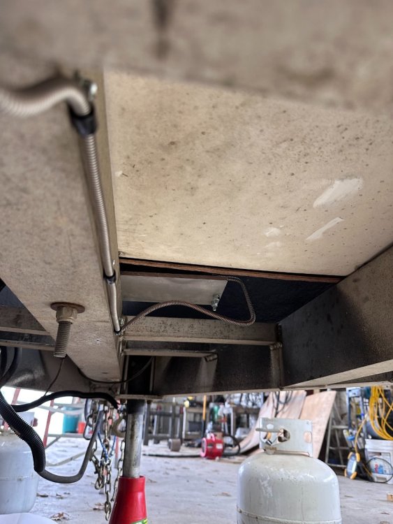

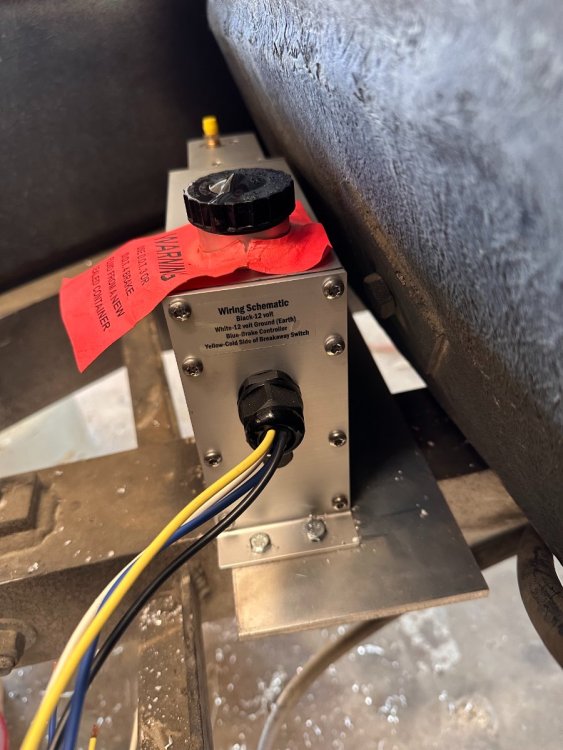

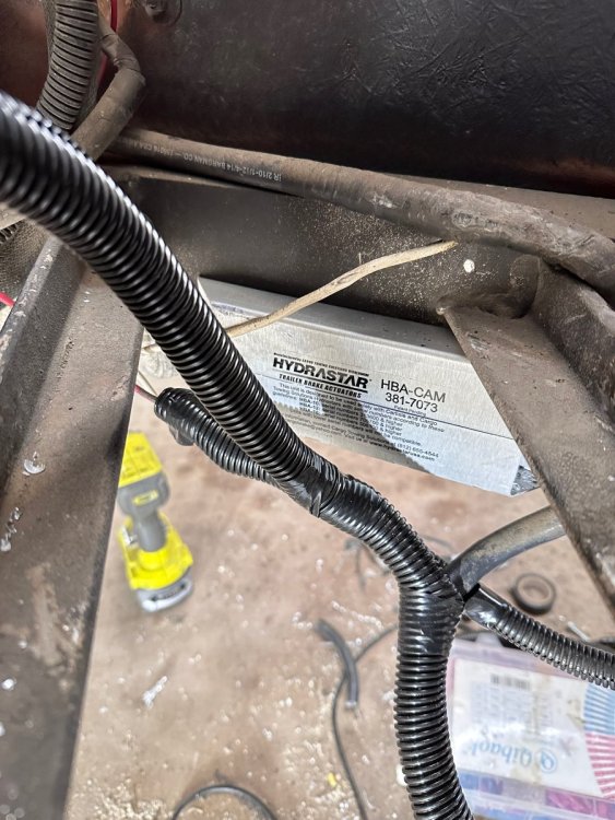

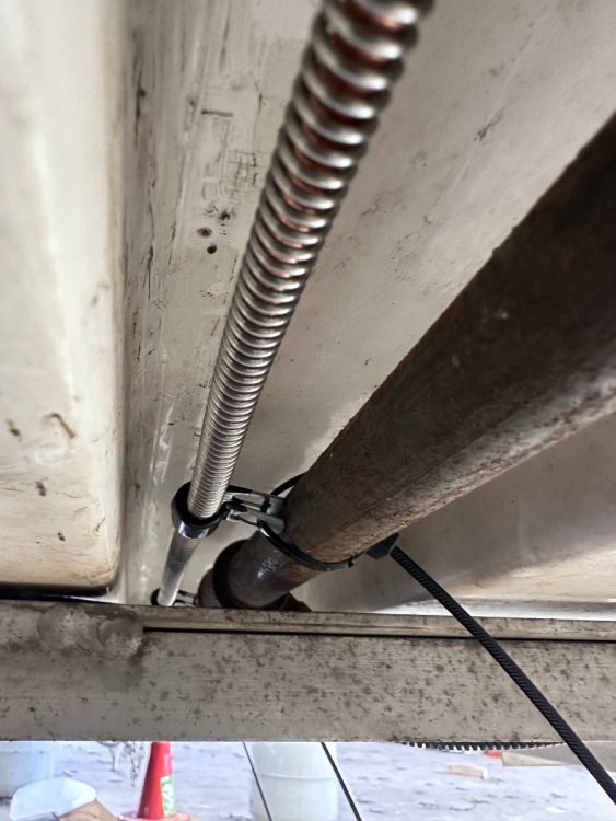

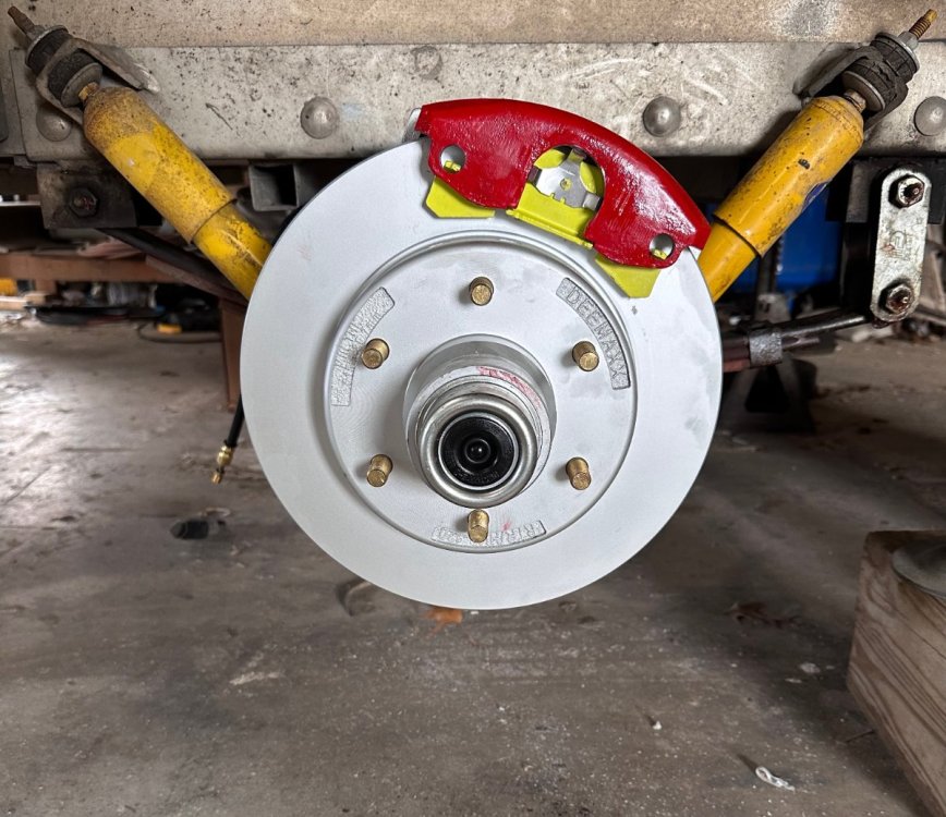

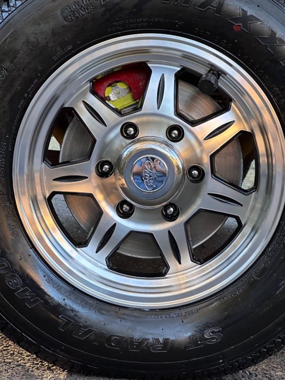

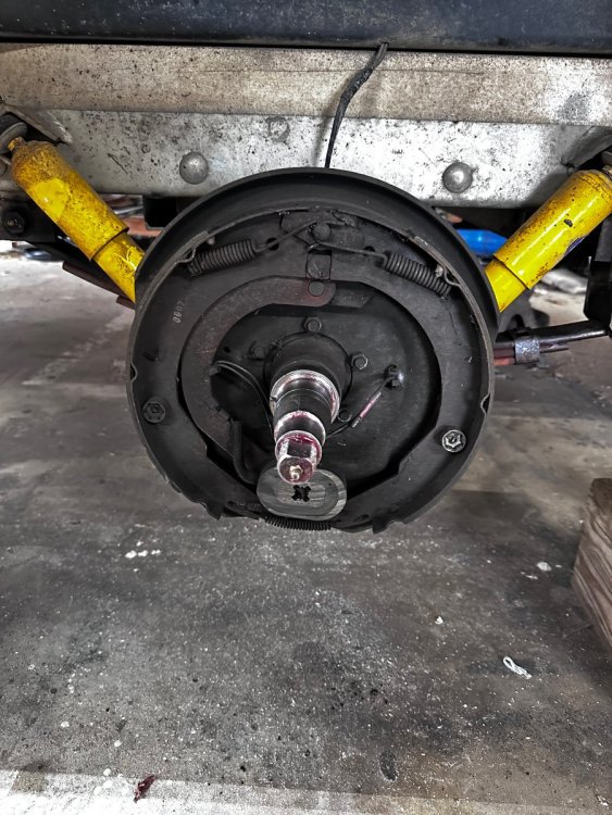

Moderators Popular Post bugeyedriver Posted December 15, 2022 Moderators Popular Post Posted December 15, 2022 Well, she may be a "vintage" Oliver Elite with almost 140,000 miles, but she's had a NEW upgrade to her list of many, many improvements over the years. Following ScubaRX's template from 2017, with some minor modifications, the old tired drum brakes have been retired to the history bin and have been replaced with disk brakes. Woohooooooo . . . Took her for a test run today and I'm very pleased with the result. If anyone is near San Antonio and desires the same modification (5200 lb axles required) contact Ron at Boerne RV - Eight 30 - 8 one 6 - 388 three and he will take good care of you. 1 14 Pete & "Bosker". TV - '18 F150 Super-cab Fx4; RV - "The Wonder Egg"; '08 Elite, Hull Number 014. Travel blog of 1st 10 years' wanderings - http://www.peteandthewonderegg.blogspot.com

Moderators SeaDawg Posted December 16, 2022 Moderators Posted December 16, 2022 Gotta love the red calipers.bling, bling. Nice wheels, too, btw. 2008 Ram 1500 4 × 4 2008 Oliver Elite, Hull #12 Florida and Western North Carolina, or wherever the truck goes.... 400 watts solar. DC compressor fridge. No inverter. 2 x 105 ah agm batteries . Life is good.
ADKCamper Posted December 16, 2022 Posted December 16, 2022 Congrats! Looks like a nice job! We have a 2018 Elite and have been contemplating just such an upgrade for a while. I have successfully done this on a boat trailer in the past. One thing that I haven't been able to figure out... where did you put the electric-over-hydraulic controller? There's not very much room in or on an Elite for a unit of that size, that doesn't hang down too low, with routing opportunities for electrical cables and brake line... It looks like you have a different spindle than the more recent Elites, with a zerk fitting for greasing the bearings. Is that original? Tom & Holly 2018 Oliver Legacy Elite #409 - 320W rooftop solar, 300Ah Epoch LiFePO4, Victron BMV-712 & Smart Solar MPPT 100/30, Progressive Dynamics PD4060CVS 60Amp Lithium-capable Converter, Xantrex PROwatt SW 2000 inverter, Bulldog HD1213-0656 Shocks, Falken Wildpeak H/T02 235/65R16C 121/119R; Tow Vehicle: 2017 Silverado 1500, 5.3L Gas, 4x4, Dbl Cab, Std Bed.

Moderators bugeyedriver Posted December 16, 2022 Author Moderators Posted December 16, 2022 8 hours ago, ADKCamper said: Congrats! Looks like a nice job! We have a 2018 Elite and have been contemplating just such an upgrade for a while. I have successfully done this on a boat trailer in the past. One thing that I haven't been able to figure out... where did you put the electric-over-hydraulic controller? There's not very much room in or on an Elite for a unit of that size, that doesn't hang down too low, with routing opportunities for electrical cables and brake line... It looks like you have a different spindle than the more recent Elites, with a zerk fitting for greasing the bearings. Is that original? I purchased a 5" X 13" X 1/4" sheet of aluminum for mounting the actuator and asked Ron to ensure the fill port was mid-center, between the propane tanks. It is tight, but does not interfere with the tanks or make contact with the fiberglass shell. The actuator adaptor module which allows it to interface with modern in truck brake controllers is mounted on the inside of the street-side A-frame. One major change I asked Ron to do from ScubaRX's design is to enclose the entire run of the copper-nickle brake line in a protective stainless steel brake line protector from Summit Racing https://www.summitracing.com/parts/ops-gg31616ss It slips right over the brake line to protect it from stones. The line is run on the side of a frame member until it enters the fiberglass channel housing the propane line where it is well secured and away from anything that might chafe it over the long term. The grease bearing zerk fitting came with my 5200 lb axle. I never used it because one day a brake shop owner told me about all the extra work he was seeing because customers were applying too much grease, which squirted out of the seals, which then fouled up the brakes. 1 2 Pete & "Bosker". TV - '18 F150 Super-cab Fx4; RV - "The Wonder Egg"; '08 Elite, Hull Number 014. Travel blog of 1st 10 years' wanderings - http://www.peteandthewonderegg.blogspot.com
CRM Posted December 16, 2022 Posted December 16, 2022 3 hours ago, rideandfly said: Pete, Absolutely beautiful! Been thinking about eventually replacing the drums & brakes on our 2015 LE2's 5200lb axles. There are very few 5200lb axles on LE2's in case some are wondering, Oliver installed a few on LE2's when they ran out of 3500lb axles. Will give Ron a call when ready to pull the trigger on that project. Thanks for posting! I'm one of the lucky ones with 5200 axles, but not sure if the upgrade is worth the $3k to me as I have no problems whatsoever with the braking on my LE2. Maybe single axle trailers see more of a performance boost? 2010 Elite II Hull #45, the first LE2 sold. 2020 Toyota Tundra TRD Off Road 4WD 5.7 with 38 gallon tank, 4.30 axle and tow package.

rideandfly Posted December 16, 2022 Posted December 16, 2022 4 hours ago, CRM said: I'm one of the lucky ones with 5200 axles, but not sure if the upgrade is worth the $3k to me as I have no problems whatsoever with the braking on my LE2. Maybe single axle trailers see more of a performance boost? When it's time to rebuild our 5200lb axle brake assemblies including installation of new bearings/races, will probably install disc brakes instead. The 5200lb axles have larger drum brakes compared to the 3500lb axles and do a good job stopping our LE2 Ollie, too. 2 Bill 2015 LE2 #75 2024 F350 6.8L
Moderators bugeyedriver Posted December 16, 2022 Author Moderators Posted December 16, 2022 My drum brakes performed admirably for over a decade with regular annual maintenance . . . I was traveling 9 to 10 thousand miles a year then. Lots of braking events . . . and then . . . COVID! No travel at all for one year, and two years only going 700 miles into the mountains and sitting for 3 months with lots of friends in the cool air. Well. the dust and debris of normal travel had gotten into the drums and sort of solidified, causing the left drum to cease working altogether and the right one to be cantankerous. My TV is an F150 which has abundant braking power for my 3900 lb Wonder Egg. But that's not the point. I need to ensure safety at ALL times, even when going down 9 miles of 12-15° down slopes in the mountains. So that was the impetus for my move to disk brakes. Plus . . . they look COOL! $1600 in parts, $900 in labor. For me, where I am in life at this time, it is worth every buckaaroo. I hope to return to my long wanderings again this year. Woohooooo 5 Pete & "Bosker". TV - '18 F150 Super-cab Fx4; RV - "The Wonder Egg"; '08 Elite, Hull Number 014. Travel blog of 1st 10 years' wanderings - http://www.peteandthewonderegg.blogspot.com
ADKCamper Posted December 17, 2022 Posted December 17, 2022 Thanks so much for the additional details... Nice retrofit, and well thought out! Tom & Holly 2018 Oliver Legacy Elite #409 - 320W rooftop solar, 300Ah Epoch LiFePO4, Victron BMV-712 & Smart Solar MPPT 100/30, Progressive Dynamics PD4060CVS 60Amp Lithium-capable Converter, Xantrex PROwatt SW 2000 inverter, Bulldog HD1213-0656 Shocks, Falken Wildpeak H/T02 235/65R16C 121/119R; Tow Vehicle: 2017 Silverado 1500, 5.3L Gas, 4x4, Dbl Cab, Std Bed.
Moderators bugeyedriver Posted December 17, 2022 Author Moderators Posted December 17, 2022 14 hours ago, ADKCamper said: Thanks so much for the additional details... Nice retrofit, and well thought out! I give credit to ScubaRX for detailing his disk brake modification back in 2017 and Ron for his mechanical prowess. 1 Pete & "Bosker". TV - '18 F150 Super-cab Fx4; RV - "The Wonder Egg"; '08 Elite, Hull Number 014. Travel blog of 1st 10 years' wanderings - http://www.peteandthewonderegg.blogspot.com
