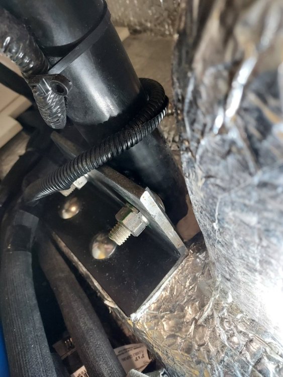

Are you sure that this steel not simply been bent and/or molded/extruded in this manner versus "welded"?
No, I'm not sure.  What made me think it is welded is the appearance of weld penetration at the L joint on one of the unpainted, cut sides.  See photo below.
What do you think?
Regardless of whether it is welded or extruded, if the jack fails, that junction is much too solid to be the failure point.
2147174846_SideViewofAngleIronJackBracket.thumb.jpg.b7df8d6a20487a4d062ebf8907d7829b.jpg
While I was there, I got a better photo of the weld connecting the cylindrical jack housing to the vertical bracket which bolts the jack to the L bracket.  That weld looks pretty stout to me.   This examination left me with ample confidence that the jacks in Hull #1291 will perform up to their 3K lb. rating.

20 hours ago, topgun2 said:
I always thought that they were simply reasonably heavy "L" channel.
This is what I think the steel brackets are.  Under this application I don't believe that there is a snowball's chance in .... that they will fail.

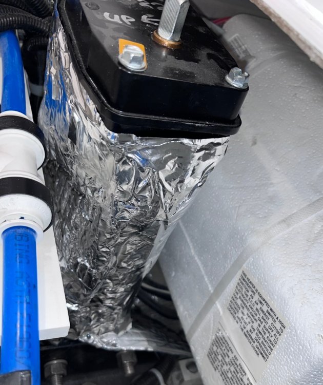

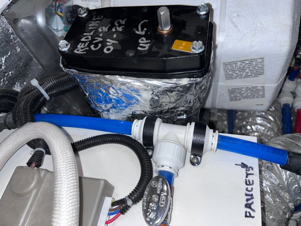

GJ
Jack shaft up. I encountered a frozen jack once, it would not budge in either direction. Knowing which way to relieve the load might be useful next time. The problem was actually (really) loose mounting bolts through the frame.
 I consider up and down to be in reference to the jack’s foot. I fixed all the switches to be the same. Push the switch up and the jack goes up (trailer goes down.)
But, to be perfectly transparent, my switches are all positioned where I can actually see the jack when I'm operating it.
I too really like the idea of using a silver paint marker to indicate the jack input for trailer raise/lower.  Makes sense to have it right there during an problem.
in 2018, when Phil toured my OE2 on delivery, he stumbled on describing which way to push the rear jack rocker switches.  He by habit raised the trailer when he wanted to, but describing the logic of his habit was a problem.  I stated, "So push the upper button to raise the trailer!"  He commented that that was an easy way to remember it!
So I continue to this day, every time I am about to reach down to those buttons, I think: "Trailer UP push upper button", and "Trailer DOWN push the lower button".

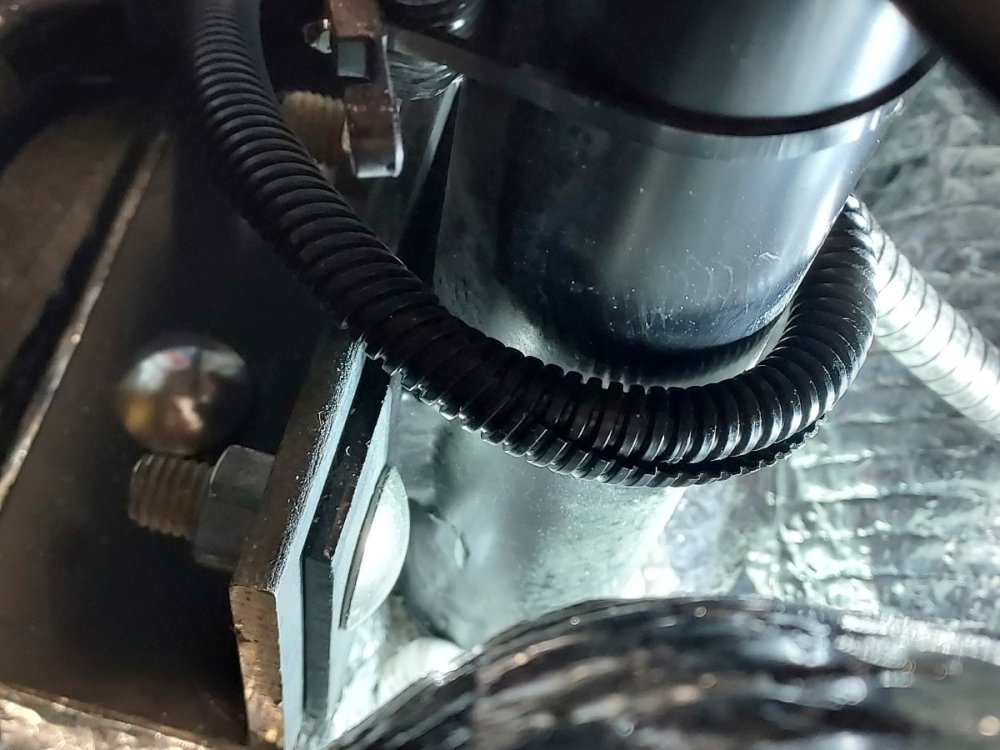

I have hull 98.  Noticed while getting ready for my upcoming trip that one jack bracket, curb side,  ( aluminum) appears to be fully welded on both sides of the bracket.  On the street side, the visible side has a small spot weld, the hidden side is fully welded as best as I can tell without a bore scope.
I was told by service that it was normal for this production year.
