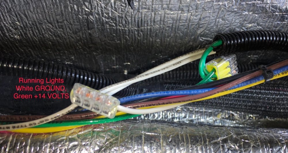

John E Davies Posted March 9, 2023 Share Posted March 9, 2023 https://olivertraveltrailers.com/forums/topic/5271-how-to-junction-box-for-the-7-wire-trailer-harness-under-the-front-dinette-seat/ From that thread, here are the outside running light connections for the left front (LF) ones (I THINK both top and bottom lights connect here.). The LR and RR will be reasonably easy to access. The RF one is buried under the closet floor I believe. If you do open up that wire loom cover for a look inside, please make sure Oliver did not mess up like this: FYI, Oliver’s color coding for the 7 pin wires inside the trailer is wacky and nowhere close to the industry standard. John Davies Spokane WA 1 SOLD 07/23 "Mouse": 2017 Legacy Elite II Two Beds, Hull Number 218, See my HOW TO threads: Tow Vehicle: 2013 Land Cruiser 200, 32” LT tires, airbags, Safari snorkel, Maggiolina Grand Tour 360 Carbon RTT. Link to comment Share on other sites More sharing options...

John E Davies Posted March 10, 2023 Share Posted March 10, 2023 26 minutes ago, Geronimo John said: Now we add to the problem that OTT has used a 12 Ga/10 Ga crimp connection for a 14 Ga wire. Is this mistake common for all or just some of the OE2's? John How much white 12 GA wire did you need to replace the 14, and which connector did you use? See the thread above, I rewired that whole circuit, I used 10 AWG charge and ground wires back to the Oliver bus. I moved those buried splices to above the sewer pipe and secured them up high for easy future access. FYI it is “possible” to make a secure splice of a too small wire into a larger butt splice, you strip it extra long and fold the wire back on itself. But that is the redneck way, I would not endorse it. John Davies Spokane WA 3 SOLD 07/23 "Mouse": 2017 Legacy Elite II Two Beds, Hull Number 218, See my HOW TO threads: Tow Vehicle: 2013 Land Cruiser 200, 32” LT tires, airbags, Safari snorkel, Maggiolina Grand Tour 360 Carbon RTT. Link to comment Share on other sites More sharing options...
