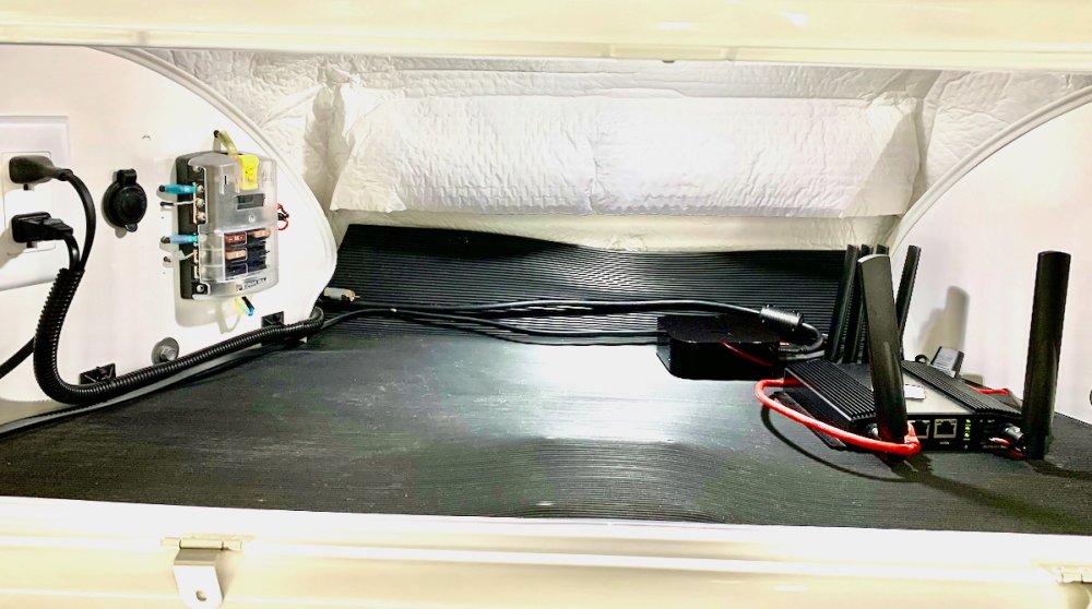

Steve Morris Posted July 25, 2023 Posted July 25, 2023 I added the funky panel. 🤣 It is fed from the 12ga wire that used to go to the 12V cigarette outlet. Then it feeds the outlet, Sirocco fan, Alexa Echo Dot, and Pepwave router. It will later also feed the second fan and Apple TV. I ran the wires through the holes for the most direct route to the panel. Each has an insulation sleeve on it where it passes through the panel, and all are gathered in a bundle and wrapped in a wire wrap behind the panel. It is actually a much cleaner install behind there than any of Oliver’s jumble of wires. 😉 2 ----- Steve - Northern Ohio, USA Wandering around on occasion, always lost. 2021 Toyota Land Cruiser - 2023 Oliver Elite II Twin Hull #1360 “Curiosity” Facebook - Instagram Camped in Curiosity = Green —— Visited with Curiosity = Gray

jd1923 Posted July 25, 2023 Author Posted July 25, 2023 13 hours ago, Steve Morris said: I added the funky panel. 🤣 It is fed from the 12ga wire that used to go to the 12V cigarette outlet... It is actually a much cleaner install behind there than any of Oliver’s jumble of wires. 😉 Now that I understand this panel is an owner's addition, it's really less funky, and instead it's actually very good work! In a manufacturing environment, it would be odd to work it that way. They would want a full assembly to mount quickly, and I agree yours is a cleaner install. Good use of the 12V outlet feed, since you have multiple 12V DC appliances. I have these cigarette lighter style outlets in the OTT and my TV and do not use any of them. I prefer the ones that have the USB built in. My A/V installation is all 120V AC, but I do plan to disconnect the same 12V DC source to connect a bedroom fan at some point. Thanks Steve. Chris & John in Prescott, AZ | 2016 EII #113 | '01 Ram 2500 Cummins!
Steve Morris Posted July 25, 2023 Posted July 25, 2023 1 minute ago, jd1923 said: it's really less funky, and instead it's actually very good work! Nice save! 😂 1 ----- Steve - Northern Ohio, USA Wandering around on occasion, always lost. 2021 Toyota Land Cruiser - 2023 Oliver Elite II Twin Hull #1360 “Curiosity” Facebook - Instagram Camped in Curiosity = Green —— Visited with Curiosity = Gray

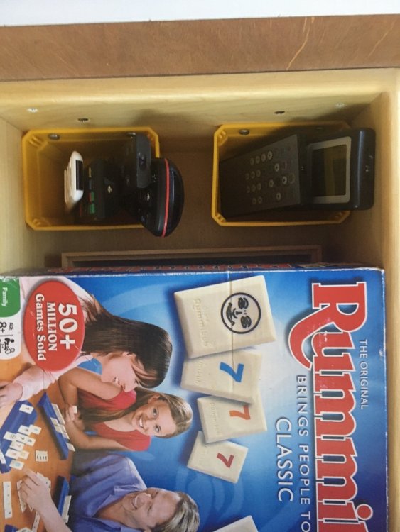

jd1923 Posted July 26, 2023 Author Posted July 26, 2023 Lastly, what about the remotes? There are always too many, right? I mounted a couple of parts bins, I had on-hand. One bin for the Oliver installed remotes, and one bin for the newly installed components (TV, Blu-ray, Dish Wally, and soundbar remotes). The TV remote will change volume on the soundbar, pause a DVD and more. OMG, even our Rummikub game has the perfect place, snug fit top of the nightstand drawer! Best wishes y'all. We love this OTT Forum. You guys are great! Chris & John in Prescott, AZ | 2016 EII #113 | '01 Ram 2500 Cummins!

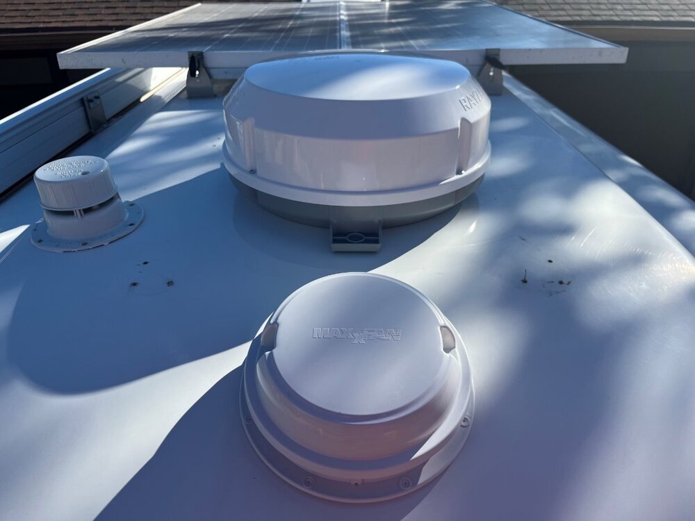

jd1923 Posted November 30, 2024 Author Posted November 30, 2024 (edited) On 7/24/2023 at 9:35 AM, Steve Morris said: A monitor would work except for when we eventually get somewhere without cellular service and I can use the omni-directional antenna for terrestrial TV... I reworked all the "Attic" wiring while adding this antenna. Check out the first picture. It's not funny! The Oliver family should not employ anybody who cannot cut a square rectangular opening! They also used a 1 1/4" hole saw for the 12V outlet that requires a 1 1/8" opening. And look at how the two screw holes at the bottom of the panel are lined up. I used the original hole for the new Winegard antenna controller and drilled a new hole to install the dual USB port. The simple power strip and an HDMI switch (choose between TV tuner or Blu-ray player) are both mounted with VHB tape. Our WHITE and amazing Samsung 32" high-rez monitor, its screen only 1/2" thick, has no internal TV tuner. I added a remote digital HDTV tuner. You cannot see this in the install since it is behind the panel. It's powered by USB and HDMI is the output. Simple, inexpensive and works well: https://a.co/d/7YBYzxw Check out all the wires in the bottom RH corner of the second picture. The TV tuner, the TV power supply and all extra cabling is behind the panel. The Winegard controller has cable inputs and output behind the panel too. The cable TV input you see in front is extra if needed. I should have taken a picture behind the panel. Edited December 1, 2024 by jd1923 2 Chris & John in Prescott, AZ | 2016 EII #113 | '01 Ram 2500 Cummins!
