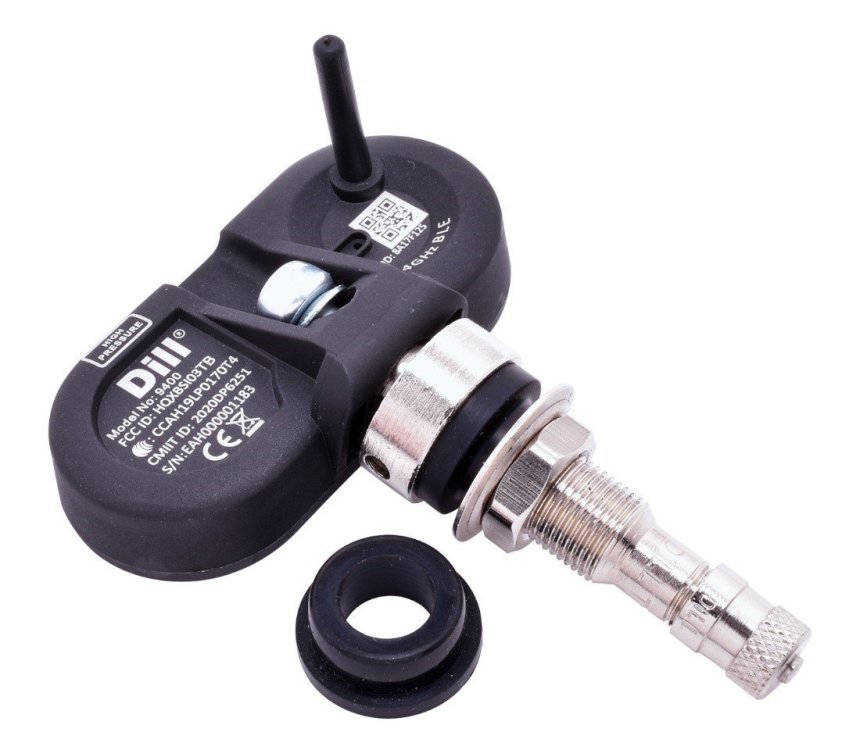

I'm going to purchase and install these from Dill. Our truck is 23 years old, so it did not come with TPMS. You can buy a set of 4, or 8 and monitor pressure via Bluetooth to your phone. I will purchase 8 and install inside of my OTT and TV wheels. Dill's new product will be available late October from Tire Rack (first reseller). For truck and trailer you would buy two sets (pat # 1604-V).
A TPMS is crucial to have.  Check out TST and compare to the one you posted.  It comes with a monitor that you can see on your dash and gives you pressure and temperature readings.  We have that one and even though we haven't set up the booster, we have no problem getting the measurements from the Oliver LE 2.  I have four sensors for the tv and four for the trailer.  Tireminder is another brand.

Thanks @John Welte, @Mike and Carol and @topgun2.
There are several reasons why I'm interested in the new Dill product, vs. TST and other like products. The Dill sensor is installed in the tire on an integrated valve stem vs. small plastic valve-stem-cap devices mounted outside in the elements. Dill sensors, like OEM automotive sensors, advertise a 5 to 7-year battery life. So, you replace the batteries when you replace tires every 5-7 years.
Another feature is not having to mount and wire a proprietary screen! Just read the tire data from your cell phone. Soon I will be mounting a small screen for gauges integrated to the truck computer (OBD II port), to read EGT on the diesel, trans temp, and much more! I have a good place to mount that, down behind the cup holder and really do not want anything on the dashboard. Full specs are not yet out on this new product, to be released by October end, but you must be setup a cell phone alert when tire pressure or temp is outside of control limits. Having the data view portable will also be handy when filling tires. I'm holding off on my new tire purchase until these are released, price and full specs advertised.
You can also get TST sensors to be mounted INSIDE the wheel and, like @Mike and Carol mentioned, the separate display does not depend on your phone to be on and the app to be opened.

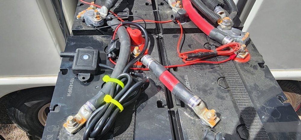

How is the booster installed?  I haven't installed it yet.  Any directions for doing that?  TST phone number?
John

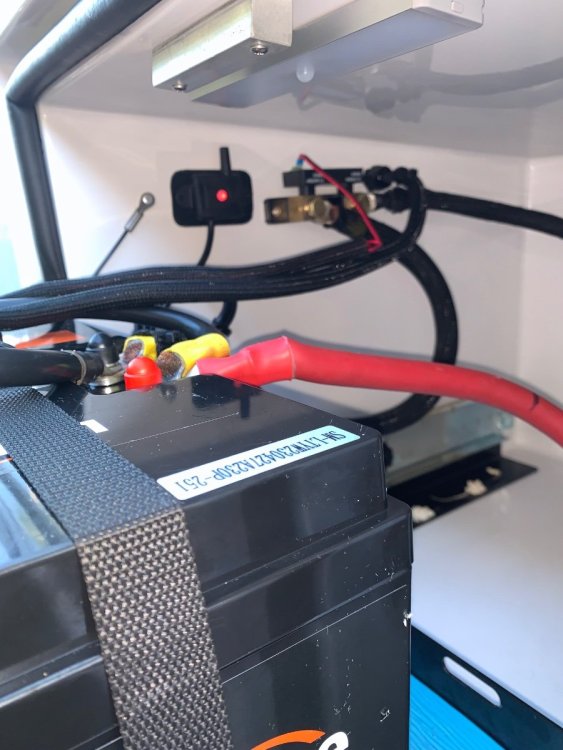

As I recall, the instructions that came with my TST kit recommended installing the booster near the sensors and to connect directly to the battery.  We installed ours in the battery compartment.  It's about as close to the sensors as you can get, and there's no need to route the wires through the hull or under the frame.  It's not a switched connection, but if you're worried about draining the batteries you can just remove the 2 amp fuse for storage.
Steve
Steve & Mary Allyn
San Antonio, TX
2022 LE II Hull #969 "Un Œuf", 2021 MB Sprinter 3500 "Polly", 2008 Pleasure-Way Excel TS "Val", 1975 GMC Glenbrook "Whoosh"
Steve
Same here Steve especially after TST tech support also highly recommend installing the booster that comes with the  it. The Tech support guy was really cool and said you could have interference if the booster or repeater is not installed. One has to ask? What could go wrong?🙄 😄

Steve,
Did you use alligator clips on the battery terminals?
John
Steve
Before we got our newest truck with tire sensors supplied for the trailer, we use the TST system with great success. I did use the booster and I wired it to my camera switch. When the rear camera was on (always during travel) there was power going to the booster. I sold this entire system to a new owner several years ago. I believe it is one of the best aftermarket brands.
