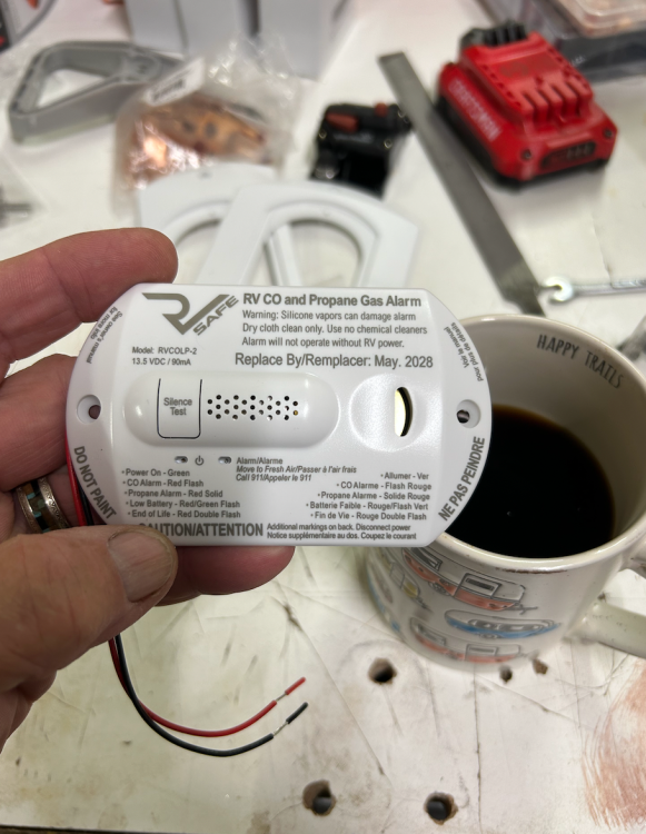

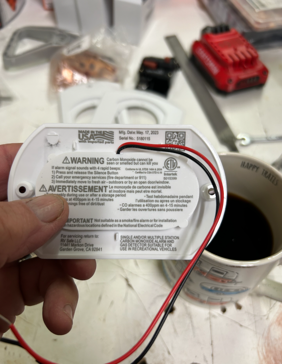

On 10/15/2023 at 10:07 AM, topgun2 said:
The propane/CO detector I received earlier this week from Amazon had a MFG date of May, 2023.
Same here, Bill...  just received from Amazon yesterday:
MFG'd 17MAY23

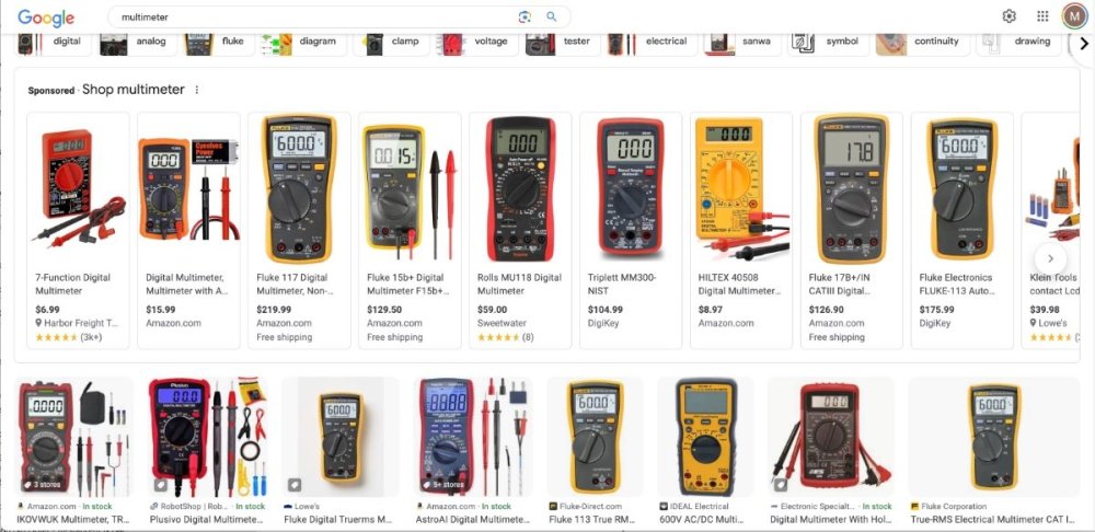

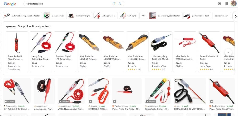

A moving blanket over the solar panels an easy and effective way to stop the panels from producing any energy, thus protecting yourself and the Oliver.  If you have the Lithionic battery package, it may have a switch on the battery that will shut it off.  Do you have tools to test 12v volt equipment such as your truck battery?  A multimeter is a very useful tool for testing 120V AC and 12V DC.  A 12 volt test probe is also a useful tool to verify if voltage is present in a battery or circuit.

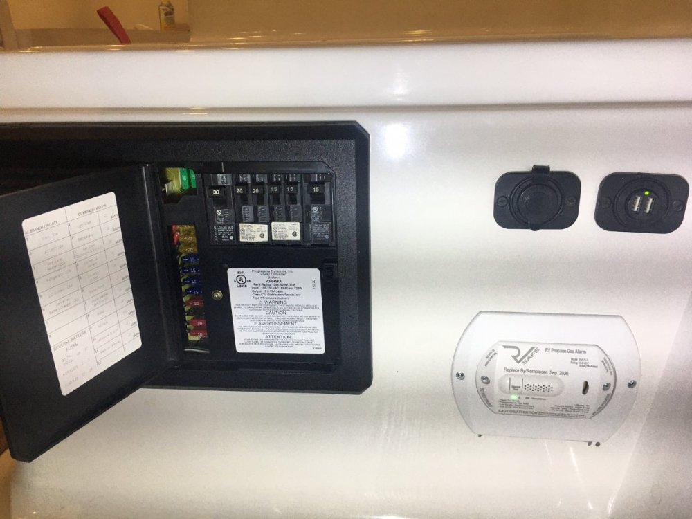

Your 2022 Elite II should have a large red solar panel cutoff switch in the overhead compartment just aft of the pantry.
In addition to cutting solar power, you should remove the CO/LP detector fuse before replacing the detector.  That 1-amp fuse in your 2022 Elite II should be accessible through the forward panel under the bed on the street side.   Just replace the fuse once the replacement is complete.  See photo below.

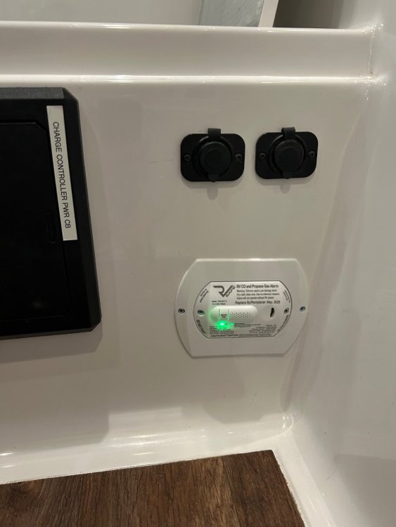

Managed to complete the new detector install yesterday….IMG_0252.thumb.jpeg.7a607e6271d9ae3b193b6196c744f021.jpeg
Now moving on to the Victron DC-DC Charger install…

The RV Safe combo propane & CO detectors seem to have been "upgraded" to just Propane.   See updated response from MFG Below.  GJ

Thank you @Patriot for bringing this to our attention. Previous owner installed this same unit on mine. Hey, if this thing rings loud in the middle of the night, I don't need a switch. Just open the rear seat of the dinette and pull either wire away from the 3M Scotchlok used by OTT to connect it or use a wire cutter!
To install a new one, yes pull the fuse, or if you're careful you can cut the wires, one at a time and wire it hot. That would be me, a low amp 12VDC circuit, just a minor jolt if you ground yourself! Just don't splice the hot (red) until you are ready to crimp it into a new butt connector.
I would not have known these sensors have date codes, likely for legal vs. technical reasons, though I may be wrong on this one (does the sensor age or wear out in some way?). Looks like mine is good for another 2 1/2 years. BTW, the build date is not important, just as long as you are within the expiration date.
Hey, who installed the USB receptacle? OTT did. It sure looks crooked (the pet peeve of the perennial installer)! I cut the flap off the USB ports since the cover just gets in the way (we don't use cigarette lighter outlets).
