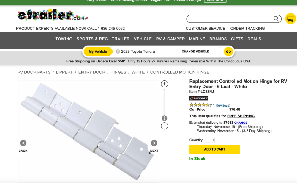

For the exact reason you've described above, we installed Lippert "Controlled Motion" Hinges last April from eTrailer:
We've logged in excess of 7,500 miles since then during much of our windy springtime season and this simple upgrade has saved the bacon on several occasions.  The 2 additional hinges make the door "stiff" to open but makes it stay where you want it - we've not used the exterior door latch at the bottom of the door since installing them.  For us - this was a simple fix for a condition that literally can come out of nowhere...

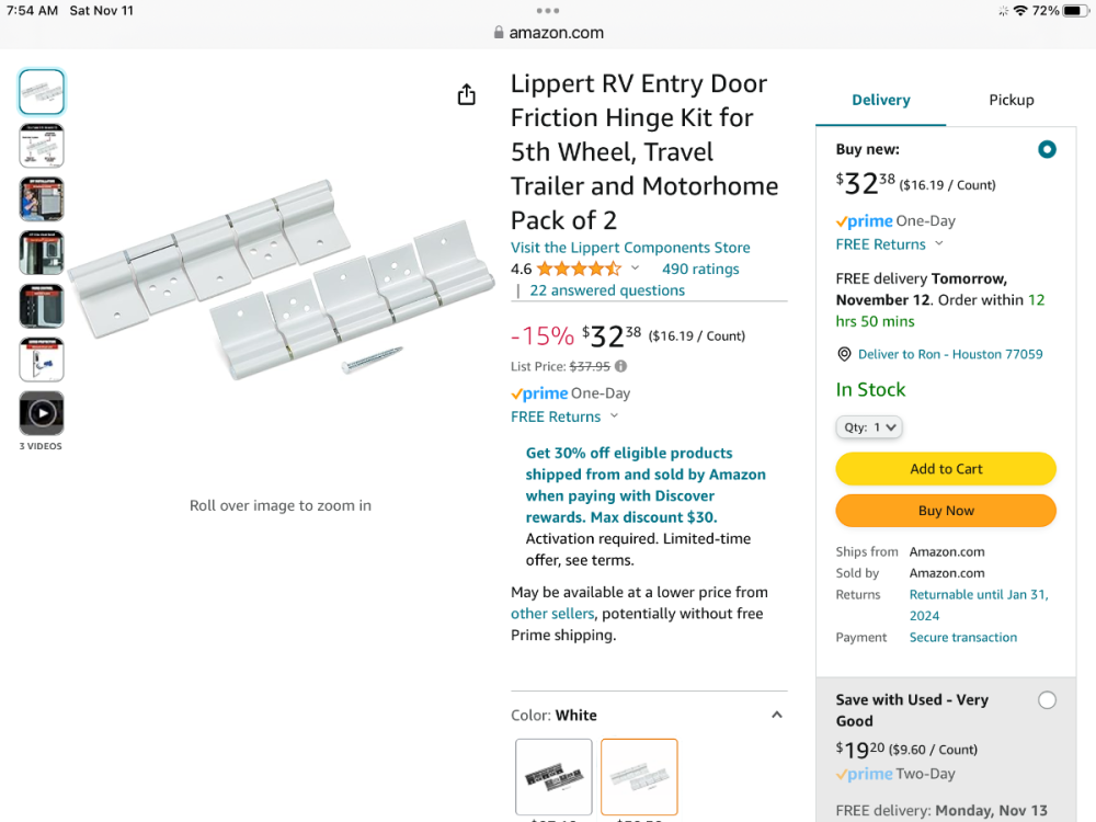

I went “here” and found these to be ‘non-friction hinges’, thus possibly the disparity in price Patriot noted. However, Amazon.us does offer a ‘friction hinge kit’ consisting of a pair. They appear to be the same as those rich.dev purchased from the Amazon.ca site, based on the compatible Lippert door Series listed in the product Description.
Oops good catch, and good find! Still a lot cheaper vs etrailer! I really love these friction hinges!

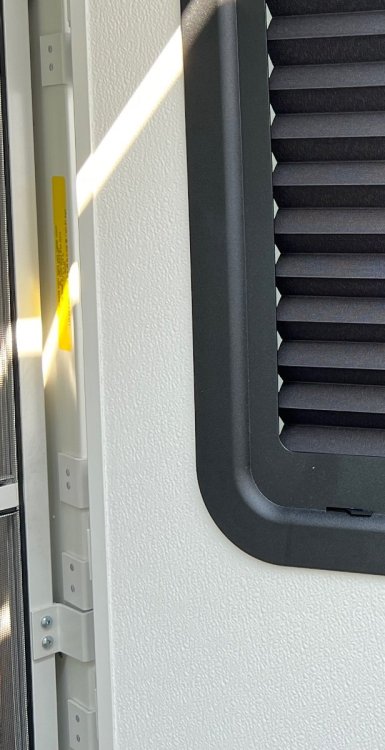

Just curious; how did/does Oliver Inc attach the hinges to the trailer? No screw heads show.
Yah definitely not screws, they look like rivets but I don’t think they are rivets…..or not rivets that I’m familiar with.
Here’s a pic of my door before I installed the friction hinges, should be the same on your 2022.
and here’s a pic of my door with the friction hinge.
