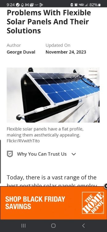

That's interesting because Renogy recommends mounting with silicone adhesive directly to the roof of the boat/RV. And they recommend this to eliminate the need to drill holes in the structure. They also say they are designed to operate normally up to 176 deg. and carry a five year warranty under these recommendations.
I'm not saying they're impervious to heat damage, but according to this company, there flexible panels were designed for exactly this type of application.

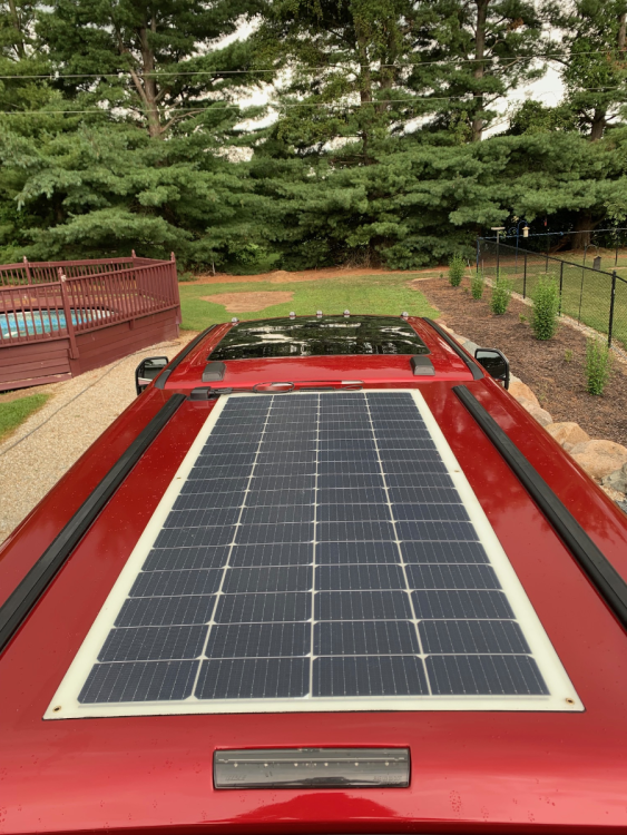

I added 200W of flexible solar panels atop the TV bed cap for the same purpose. Been great for 3.5 years! Since I did not opt for solar in my build, I’m now geared up to install a solar port at the propane tank housing to enable use of said panels to charge the OTT’s house batteries, as boondocking has become more frequent for me. Also adding a solar port outside at the rear basement hatch, inline with the other two ports for sat/cable TV. I plan to get a portable folding solar panel to further increase solar input.
That's my long term plan as well. I've yet to install my Victron DC/DC charging system, a project for next summer. When I do that I'll add trailer front connections as well for the truck solar panel to supplement the Oliver solar. And ours came with the solar port at the battery compartment and we got the portable panel so we would be able to charge at ~800 watts on good days. Can't wait to get it all put together and run some tests.
