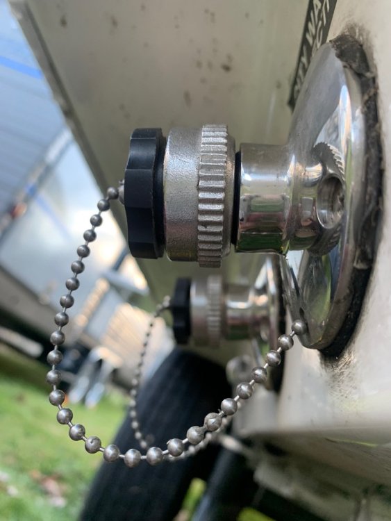

I bought this Eley Quick Connect System product for all hose connections in my setups. Think one-handed operation!
The components.
Water pressure regulator and filter configuration.
Eley installed at Oliver water inlets.
Protective caps in place, utilized chain hardware from original stock caps
Caps purchased.

No doubt, as well as Amazon. However these Eley connectors are commercial grade, made with quality materials to ensure longevity and safe drinking water, of bigger overall size for a full 3/4” unobstructed flow, have serviceable o-rings and a 10-year warranty! You definitely get what you pay for IMO. That said, I also have been very pleased with several of the Gorilla Easy Connect hose terminal ball valves/couplers/nozzles, which I will share with if anyone is interested.

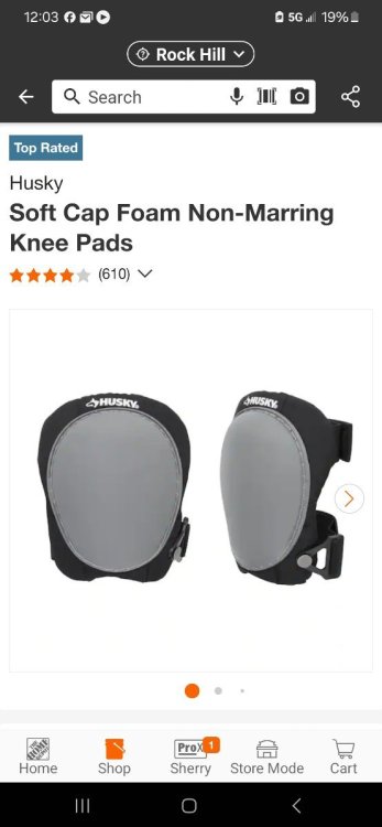

My husband uses knee pads a lot, too , sometimes along with a gardening pad.
Even if you're younger, it's important to protect your knees. And if you're not, like us, well.... it's just that much more comfort.
