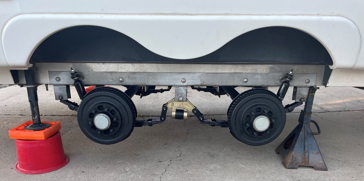

johnwen Posted September 4, 2025 Posted September 4, 2025 7 minutes ago, jd1923 said: I generally prefer working on my own vehicles (and home) vs. contracting trades. However, the reasonable amount Alcan charges for labor is well worth it! This is not as easy as it looks! 🤣 Both axles are in today. Torque the wet bolts and brake wiring yet to do. Friday I have new E-Z Flex equalizers coming. Looking good JD :) 1 2022 Oliver II #996 "Bessie", 2019 Silverado LTZ 5.3, Veterans https://wenandjohnsadventure.com/

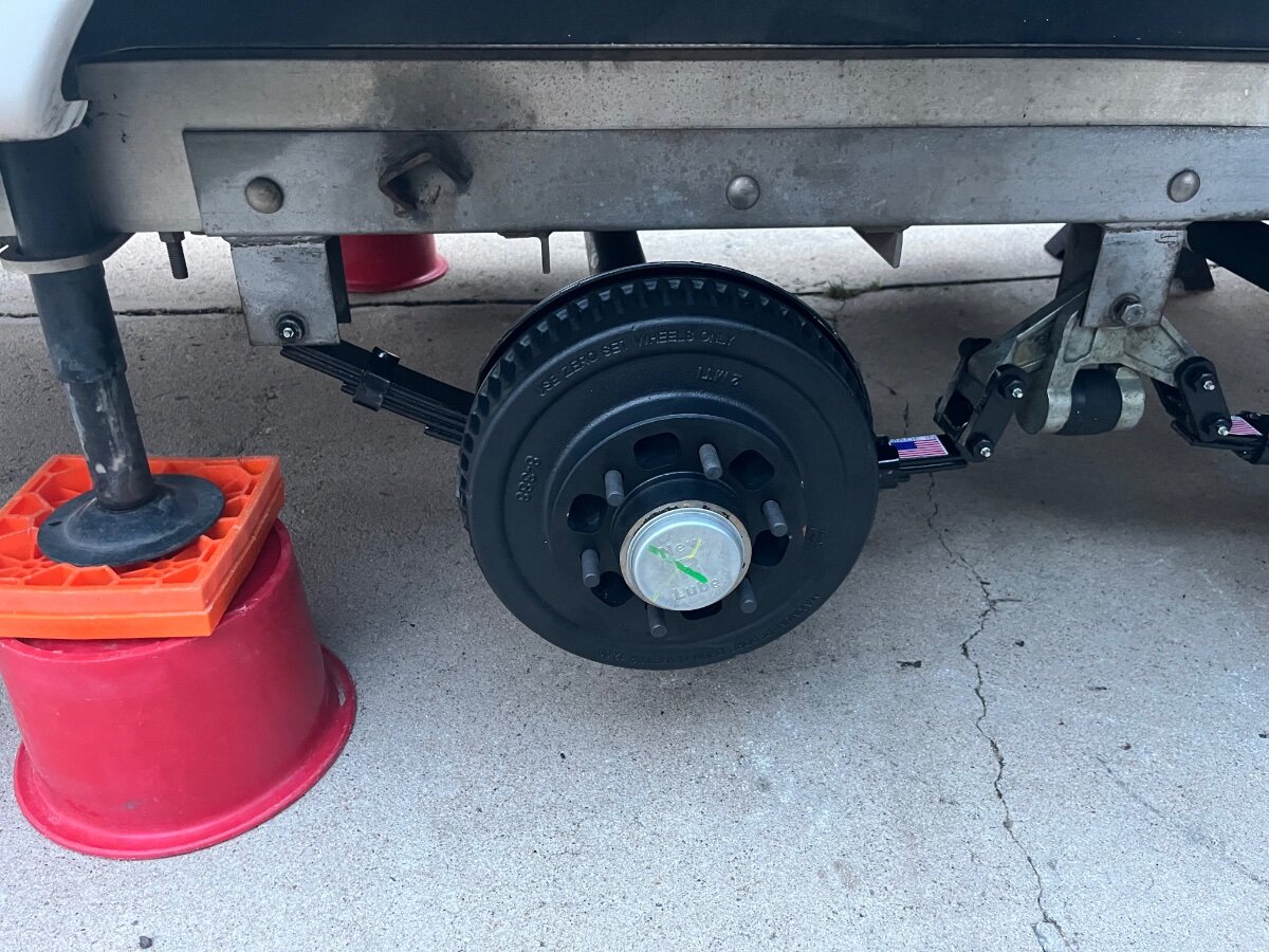

Patriot Posted September 5, 2025 Posted September 5, 2025 (edited) Jd, Nice work on your new running gear. If I am looking at this correctly, I see you installed your wet bolt zerks facing out or towards the inside of your wheel/tire. This makes it a more difficult to get the grease gun in that much tighter space. While having my leaf packs installed, I had the techs at Alcan reverse my zerks for much easier access when greasing them — now facing the opposite direction. Hopefully you are not too far along and can reverse your wet bolt zerks to face the inside for easier access. I promise it will make it super easy greasing those zerks later on. 😊 Patriot 🇺🇸 Edited September 5, 2025 by Patriot 3 2020 OLEII - Hull #634 aka- “XPLOR” 2021 F350 6.7 liter Diesel Lariat Ultimate Tremor aka - “Beast of Burden” Truma Aventa 13.5 AC, Alcan 5 leaf pack, Alcan HD shackles & HD wet bolts, 5200lb never lube axles.XPEL 10 mil PPF front both front corners, 30 lb LP tanks, Sea Biscuit Front Cargo Storage box. ⚡️⚡️11/2025- Lithium upgrade to XPLOR - (2) Epoch 300ah Lithium batteries, Victron 3000W MultiPlus-II, Victron GX Touch 70, Victron Cerbo GX, Victron Smart Solar MPPT, Victron Smart Shunt, Victron Orion XS 1400 DC-DC charger, RV Soft Start. Zamp 90W suit case solar panel for 420W of solar.⚡️⚡️ North Carolina

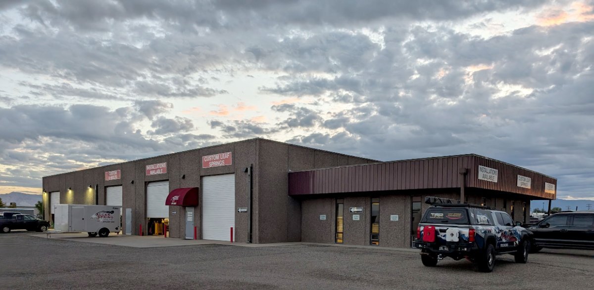

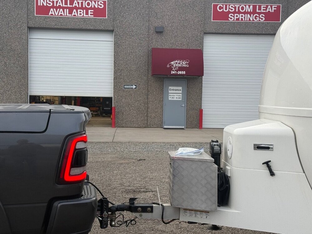

Patriot Posted September 5, 2025 Posted September 5, 2025 4 minutes ago, rideandfly said: Agree, if we install Alcans, this will be a good excuse to head west to Colorado! 🙃 Bill, We dropped our trailer off at Alcan Springs at 0730 and went to breakfast. Approx 2.5 hrs later we got a call from Lew at Alcan that our Oliver was Alcan’d!! 😄 Well worth the trip to Grand Junction and put that new Beautiful Super Duty in the wind! 🇺🇸 4 2020 OLEII - Hull #634 aka- “XPLOR” 2021 F350 6.7 liter Diesel Lariat Ultimate Tremor aka - “Beast of Burden” Truma Aventa 13.5 AC, Alcan 5 leaf pack, Alcan HD shackles & HD wet bolts, 5200lb never lube axles.XPEL 10 mil PPF front both front corners, 30 lb LP tanks, Sea Biscuit Front Cargo Storage box. ⚡️⚡️11/2025- Lithium upgrade to XPLOR - (2) Epoch 300ah Lithium batteries, Victron 3000W MultiPlus-II, Victron GX Touch 70, Victron Cerbo GX, Victron Smart Solar MPPT, Victron Smart Shunt, Victron Orion XS 1400 DC-DC charger, RV Soft Start. Zamp 90W suit case solar panel for 420W of solar.⚡️⚡️ North Carolina
rideandfly Posted September 5, 2025 Posted September 5, 2025 (edited) 53 minutes ago, Patriot said: Bill, We dropped our trailer off at Alcan Springs at 0730 and went to breakfast. Approx 2.5 hrs later we got a call from Lew at Alcan that our Oliver was Alcan’d!! 😄 Well worth the trip to Grand Junction and put that new Beautiful Super Duty in the wind! 🇺🇸 Alcan has a competitive labor charge. It's worth it letting them install the springs when in the area! Already have all the break-in miles needed on the Superduty for towing. Towed Ollie earlier this week with the Superduty, it handles Ollie easily. Have some family commitments this year, not sure if we will make it to CO, but plan to head west next year. Have most of the farkles (accessories) installed, finishing touches this weekend. Edited September 5, 2025 by rideandfly 2 Bill 2015 LE2 #75 2024 F350 6.8L
jd1923 Posted September 5, 2025 Posted September 5, 2025 1 hour ago, Patriot said: Nice work on your new running gear. If I am looking at this correctly, I see you installed your wet bolt zerks facing out I thought about the mod many of you have gone with and decided to go with the standard configuration. The end bolts are easier forward facing and the shackle bolts are easy enough with an elbow fitting and power grease gun. Takes a bit of extra reach or climbing under when the Zerks are facing inwards. Half the time when lubing, I’ll likely have the wheels off anyway to check brakes, adjust the “self-adjusters”, check the tires thoroughly, pressure wash the backsides, and remove all the annoying gravel (when doing so, I’ve found countless nails and other metal objects in tire treads. BTW, pulling and replacing wet bolts is NOT easy, as the bolt alignment is not always there. 🤣 4 Chris & John in Prescott, AZ | 2016 EII #113 | '01 Ram 2500 Cummins!

jd1923 Posted September 6, 2025 Posted September 6, 2025 (edited) Finally done! Worked on this every-other-day this week. Looks great, doesn't she?! Alternate days are for Pickleball. My body can only take one kind of daily trauma! 🤣 Days on the court cannot be combined with hours climbing under truck or trailer! How many times did I get down on the driveway, sitting on a milk crate, craning my neck to fit under the Oliver fenders. or lying down on the ground, and then climbing back up? Way too many times, no matter how well I plan having parts and tools required! UPS came early yesterday allowing me to finish with new E-Z Flex equalizers from eTrailer (2-day ship only $6.50 extra, adding another $316 to the grand total)! You should check your equalizers. Some may have upgraded leaf springs without the equalizers being removed and cleaned up for inspection (it's the right time to do it). Details on this and other concerns soon. Look for a new thread on this subject. All that's left now is to torque and grease the wet bolts (our son Adam will power the torque wrench under the trailer and the DeWalt power grease gun makes this easy). Mount wheels & tires and test drive. I'll tow some miles on local highways and hilly/winding roads, then retorque the U-bolts upon return. Park the Oliver to free up my driveway again. Another trip to Southwestern Colorado is just 3 weeks away! Edited September 6, 2025 by jd1923 1 9 Chris & John in Prescott, AZ | 2016 EII #113 | '01 Ram 2500 Cummins!

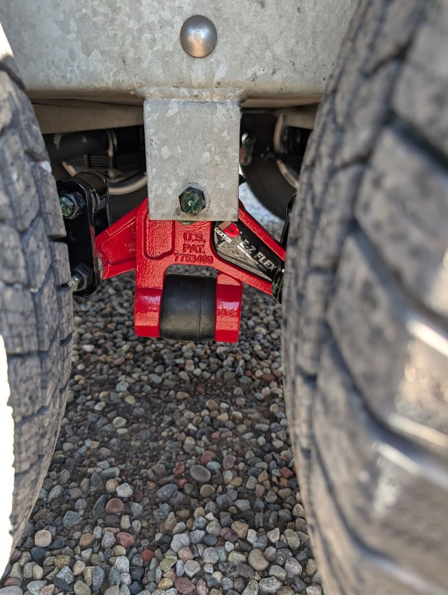

jd1923 Posted September 13, 2025 Posted September 13, 2025 (edited) Doesn't she look pretty?! 🤣 We ran two 30 mile test runs, U-bolts torqued now 3 times. Before the test drive today, I manually pushed the little self-adjuster gears on all 4 wheels. She was braking quite well today, so very nice after so little mileage. New D52 axles, new HD leaf springs, new EZ Flex equalizers, new wet bolts and HD shackles, totally new suspension! 😂 Edited September 13, 2025 by jd1923 1 7 1 Chris & John in Prescott, AZ | 2016 EII #113 | '01 Ram 2500 Cummins!

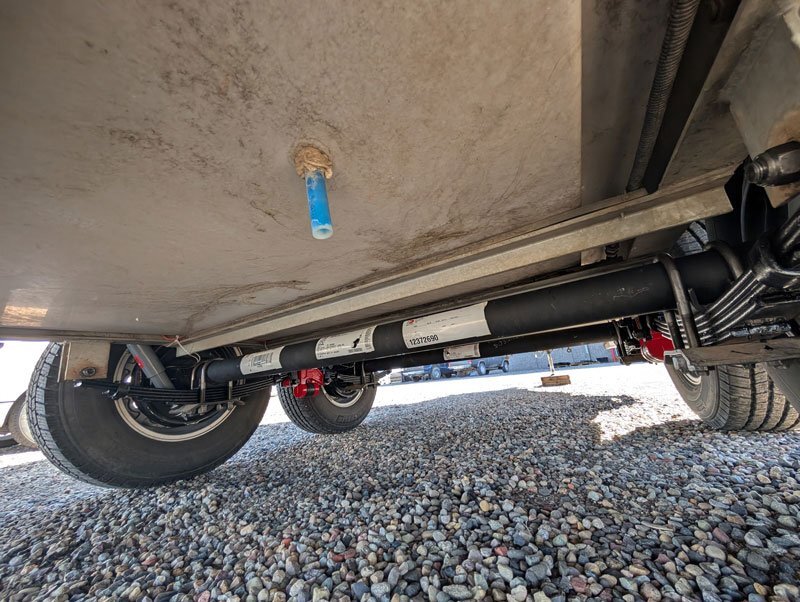

ChristianD Posted September 16, 2025 Posted September 16, 2025 (edited) On 9/12/2025 at 7:22 PM, jd1923 said: New D52 axles, new HD leaf springs, new EZ Flex equalizers, new wet bolts and HD shackles, totally new suspension! Hi John / @jd1923, Did you order these EZ Flex equalizers? https://www.etrailer.com/Trailer-Suspension-Parts/Dexter/K71-655-00.html I'm planning to bring my trailer up to Alcan and do the full Alcan 5200 axel and leaf swap. I just ordered new shocks, so the equalizers would be the only thing extra to buy. I appreciate everyone's discussion and insight into all of this. My wife and I just bought our trailer about a week ago. It's a 2019, so it's sitting on the 3500 # axles with what looks like original shocks. I was told the leafs had been changed out by the original owner but after crawling under, they look original or older. I'll feel better with preemptive replacement. Edited September 16, 2025 by ChristianD 2 Christian, Katie and Benny (our Maltese) | Cave Creek, AZ | 2019 LE II #448 | TV: GMC Sierra 2500

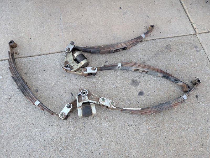

jd1923 Posted September 17, 2025 Posted September 17, 2025 (edited) 4 hours ago, ChristianD said: Hi John / @jd1923, Did you order these EZ Flex equalizers? Christian, it's thorough of you to replace new equalizers too. I observed the internal bushing wear that can only be recognized when disassembled, not sitting mounted. The dual-lever design of the EZ Flex equalizer causes the center sleeve to swivel back and forth with use, ovaling the bushings on each lever. My guess is that any trailer that has run several years, greater than 20K miles should replace this part. I'm happy that ALL hardware has been replaced in working my upgrade. I wasn't sure re the red ones The red ones states 8000 LB and eTrailer does not have a weight spec listed on the gold ones. Our EZ Flex was installed in 2018 and they were gold, so I order the gold ones which comes to a $45 + tax savings. I also purchased two new mounting bolts for the equalizers. Red or Gold are for 35" wheel centers and they both show the same measurements picture showing 7 3/4" center-to-center left-to-right. I ordered two of these and two mounting bolts as well. Congratulations on your new Oliver!!! 😂 https://www.etrailer.com/Trailer-Suspension-Parts/Dexter/013-144-03.html https://www.etrailer.com/Trailer-Suspension-Parts/TruRyde/TRFA73Z916DLNZ.html Edited September 17, 2025 by jd1923 Chris & John in Prescott, AZ | 2016 EII #113 | '01 Ram 2500 Cummins!

Patriot Posted September 23, 2025 Posted September 23, 2025 (edited) On 9/19/2025 at 9:45 PM, Mike and Carol said: We were at ALCAN this morning. They do good work! Nothing like new running gear Mike. Did Lew and crew add the heavy duty shackles and wet bolts? I had them face the new HD wet bolts inward to make it sooooo much easier to grease them.🤔 Congrats. Best 2.5 hrs of install labor we have ever spent on our Oliver. Safe Travels from The Great North Woods! Edited September 23, 2025 by Patriot 2 2020 OLEII - Hull #634 aka- “XPLOR” 2021 F350 6.7 liter Diesel Lariat Ultimate Tremor aka - “Beast of Burden” Truma Aventa 13.5 AC, Alcan 5 leaf pack, Alcan HD shackles & HD wet bolts, 5200lb never lube axles.XPEL 10 mil PPF front both front corners, 30 lb LP tanks, Sea Biscuit Front Cargo Storage box. ⚡️⚡️11/2025- Lithium upgrade to XPLOR - (2) Epoch 300ah Lithium batteries, Victron 3000W MultiPlus-II, Victron GX Touch 70, Victron Cerbo GX, Victron Smart Solar MPPT, Victron Smart Shunt, Victron Orion XS 1400 DC-DC charger, RV Soft Start. Zamp 90W suit case solar panel for 420W of solar.⚡️⚡️ North Carolina
ChristianD Posted October 2, 2025 Posted October 2, 2025 Got back from Grand Junction, Co last night. Took the Oli up to Alcan to have new Dexter 5200lb D52 axels, new Alcan springs, Bulldog HD shocks, and new Dexter E-Z Flex Suspension Kit (K71-653-00) installed. Took my little buddy Benny with for the day there, day back trip. The guys at Alcan met me out front at 7:30am. I dropped the trailer in the parking lot and they took care of everything. During the wait I drove the Rim Rock Drive in Colorado National Monument. After that, I went for a coffee, spent about half hour there and drove back to Alcan. The trailers was finished already! Then loaded up the old axels and springs into my t.v. and drove to Home Depot to get a torque wrench and sockets. Long drive home, but now the Ollie has all new axels and suspension. First time staying in the trailer. Bed is small for me, so I need to figure out a center connector piece and fill it with cushions to increase the leg area. I know about the Foy product, but may come up with something on my own. 1 5 Christian, Katie and Benny (our Maltese) | Cave Creek, AZ | 2019 LE II #448 | TV: GMC Sierra 2500

ChristianD Posted October 3, 2025 Posted October 3, 2025 (edited) 21 hours ago, Allen Lee Rohner said: Christian, Just curious why did you replace the Dexter E-Z Flex Suspension? Allen I probably didn't need to replace those, but I wanted everything to be new and not have any wear and tear on them. My trailer is a 2019 and I don't know how it was treated before I bought it. I'm sure it's a me thing, but I like replacing everything when I'm going this far with replacement parts, so it would not have sat well in my mind if I didn't. Another reason, I brought the old axels, springs and E-Z flex suspension home to later use on a future trailer build so I would have needed to buy another set of E-Z flex suspension if I build the trailer. Better to have the new stuff on the Oliver. Edited October 3, 2025 by ChristianD 2 Christian, Katie and Benny (our Maltese) | Cave Creek, AZ | 2019 LE II #448 | TV: GMC Sierra 2500
Allen Lee Rohner Posted October 3, 2025 Posted October 3, 2025 37 minutes ago, ChristianD said: I probably didn't need to replace those, but I wanted everything to be new and not have any wear and tear on them. My trailer is a 2019 and I don't know how it was treated before I bought it. I'm sure it's a me thing, but I like replacing everything when I'm going this far with replacement parts, so it would not have sat well in my mind if I didn't. Another reason, I brought the old axels, springs and E-Z flex suspension home to later use on a future trailer build so I would have needed to buy another set of E-Z flex suspension if I build the trailer. Better to have the new stuff on the Oliver. Thanks for the response, I am also planning in doing the Alcan upgrade. 2 2021 Oliver Elite II, Hull # 867, Shiloh, IL 2022 GMC Sierra 1500 AT4, 3.0L Diesel, CarbonPro
