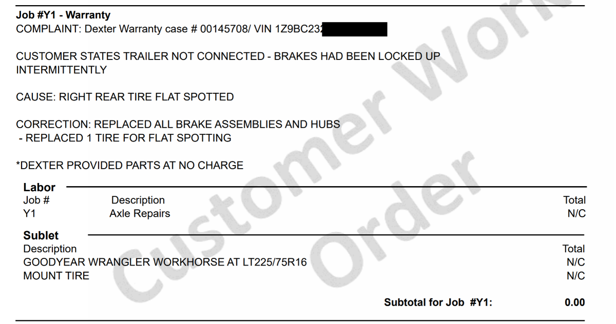

@jd1923 @Tom and Doreen not trying to columbo here - but this conversation made me think about the one thing we did get when we purchased the trailer - the service records. I went back and reviewed them (yay for cloud storage and scanning in all documents) and the plot thickens. There was this notation - and the sellers mentioned that Oliver had done axle work under warranty and replaced tires. See image below. I'm trying to figure out if right means curb, and if they mean all brakes and hubs? Is there possibly a link since it's the rear curb wheel that's having the problem, and that definitely rear regardless or left or right. -

Unfortunately, the original owners were not "detail oriented." After looking at the trailer the first time, Rebecca (who had been talking to one member of the couple) and I (talking to the other one) compared notes and could not come up with a route that would take the stated mileage (5k) and the places visited. Yes - we were really in love with the idea of a LE II and based on our experience with our LE I figured the Oliver build quality could overcome any reasonable maintenance neglect. 🙂 I was wondering about the brakes - especially since (1) the axles had to be removed to put on the new springs and (2) the involved disconnecting and reconnecting the wires (assumption since the brake wires have really well applied new connections which look like Alcan quality work). When were brakes inspected - not since we have had the trailer. Need to do that when we get back to Dallas. I'm sure someone has done an excellent tutorial on it. Suggestions welcome in case my forum search skills are not up to par. - Today

Good thought Tom (and Dudley). Could be the brake shoes, but I would think @DunnYet would have noticed more than a squeak when spinning the wheels if this was true. The shoes, when the self-adjusters are working correctly, should just slightly drag on the drum and you should hear and feel drag as you spin in either direction. Correct the brakes are worn in rolling forward, something to consider for sure. The circular pattern of the shoes is not perfectly round like the drum. If the squeak has some pulsating pattern this could be true. If it's a constant squeal when spinning, then more likely the bearing. A three-year-old trailer should not have bearing or brake issues. IMHO, 3 years would be minimal time for a first inspection. This is supposed to be a 5-year 100K system. Also understand to check the brakes the outer circlip and spindle bolt must be removed. The bolt is on at 150 ft-lb and you must be able to replace it and retighten to this spec. I don't think a buildup of brake dust would do this. If the trailer was dragged through a lot of water on and off, then perhaps. I just lifted our Oliver and spun the two wheels on one side. I heard the constant drag showing the shoes are adjusted nicely. On one I heard a slight chirp in reverse, it went away immediately. Nothing you would call a squeal, but it plays to your hypothesis. Mine are like brand new though. I installed new D52 axles 10 months ago and have only 3,600 miles on them. @DunnYet, next time you do the spin test, try to focus on what kind of sound and where it's coming from, dead center or on the perimeter. You could use the tube in ear approach in lieu of a stethoscope. Constant squeal or something more dragging and pulsating? -

That was my first thought. We have one "Never Adjust" brake that always sets itself a little tighter than the other 2. -

It could just be that one of the brakes is out of adjustment. The drum brakes are 'self adjusting' but it's not always a perfect system. There could also be built up debris, brake dust, etc. that is interfering with the brake shoe or components. I think it's a good sign that the brakes don't squeak in the forward direction. Because the shoes wear-in mostly when applied when moving forward they are less likely to squeak when rotated in that direction. Because your trailer is used, do you have any data as to when your brakes were last inspected and what may have been found at that time in terms of the amount of wear? Your trailer is newer than mine so I suspect that your brake shoes still have a good service life left on them. -
