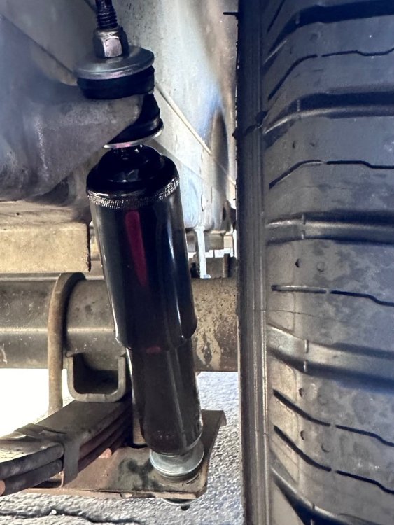

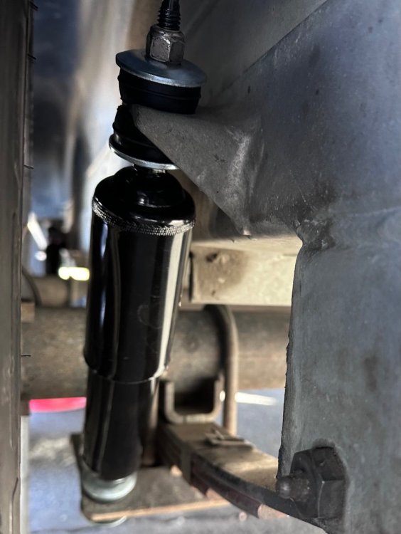

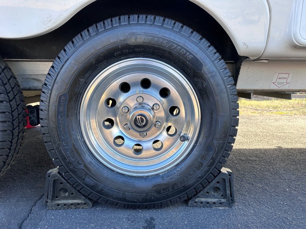

Since we are here for a week, I decided to  Replace all tires and installed 4 new shocks at 50k miles.
 At same time checked springs for wear /cracks and re-lubed all Zerks.
The tires had simply aged out but one in particular had an odd scalloping wear pattern.   (Cause was a slightly loose bearing castle nut on that right/front wheel.)
The shocks were getting a bit rusty and I decided to change as prevention.  ( All 4 seemed functional upon removal.)
Since the original tires  were 16” LT Michelin, I stuck with the brand and now run:
Michelin Agilis Cross Climate
LT225 /75 R16 115R E1 BSW
Shock replacement is:
Monroe Magnum RV 555001
IMG_6183.thumb.jpeg.617294531dc893ac6e789050ac0c95d4.jpegIMG_6184.thumb.jpeg.d78171527cdda8924c5bbca8f6a4502a.jpegIMG_6185.thumb.jpeg.ab5fc9b9d65d6f12686227de9344e463.jpeg
I was able to get the tires at a local Discount Tire in Sierra Vista. ( took 3 in one day and 2 the next as we had chores in town. )
Ordered shocks online and shipped to my sisters who we visited on the way here. Shocks went on quickly once the unit was jacked up so suspension was hanging.
All set for the next stage of our trip where we will  meet up with several owners at Ladybird Johnson for the Eclipse.

I replaced shocks this weekend along with replacing the original wheel bearings and greasing the suspension.  Three of the four shocks had dead spots and were not working correctly.  I don't think we have 50k miles on ours like the OP, but we have at least half of that.  Tires are still looking good, but I know the tires were manufactured in November of 2017 and should be replaced just because of age.  Original wheel bearings looked good, but I replaced them anyway with Timkens because I already had them apart and new bearings were on hand.  This was the first time I'd been into the wheel bearings on this trailer.

Thats what I installed last weekend too.  The Bulldogs are very slightly longer than the Monroes.  I had to compress the bottom rubber mounts just a little bit by tightening up the bottom mounting nut/rubber assembly before the top threaded mount would slide into place in the upper Oliver bracket.  It was much easier to do that than try to compress the new shock and slip the top mount in place.  You'll see what I mean, easy.

Galway Girl , hope you don't mind my posting photos of the Bulldog and original Monroe shocks for a physical comparison, we were curious if they were different builds.
Here's the original Monroe shock next to the new Bulldog shock. The rod cover is longer on the Bulldog and rod end of cylinder is built differently, they are different builds.

Thanks @rideandfly agree they are different builds. Hoping the internal seals and other components are superior. Time will tell. Those of you with these, going on long trips this season, please inspect your shocks afterwards to see if there are any leaks. They can only be better! 😂

Both shock's rods are 3/8" and Monroe barrel 1.64" OD & Bulldog barrel 1.66" OD, probably pistons are close to the same diameter depending on barrel wall thicknesses in each. The Monroe shock weighs 2 pounds 5 ounces and the Bulldog shock weighs 2 pounds 14 ounces.  Have not seen any oil leaks with the Monroe shocks.
