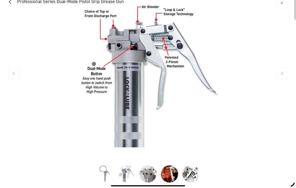

This grease gun with high volume vs high pressure mode works well too
https://locknlube.com/collections/grease-guns/products/professional-series-dual-mode-pistol-grip-grease-gun?variant=40111323349076
