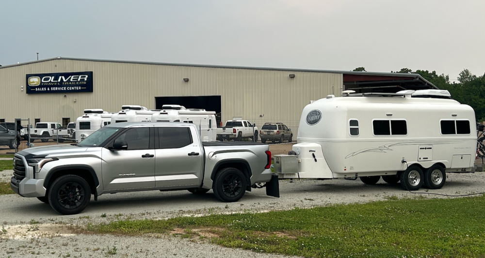

MAX Burner Posted July 5, 2024 Posted July 5, 2024 If you're planning to stay at "Camp Oliver" just outside the perimeter fence at the factory, site #3 is a good one if available.... Enjoy your time there - be sure to get some "swag." Mid-MAY at the factory: 2 Art, Diane, Magnus & Oscar (double-Aaarrf!) (SOLD) 2022 TUNDRA (SOLD) 2017 LE II; Hull #226 "Casablanca" HAM call-sign: W0ABX
