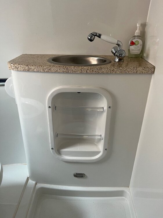

One more thing to check (I speak from experience here), open up the area under the sink in the bathroom.  In the back on the left you’ll see where the vent pipe connects to the black tank.  On our trailer it was not glued, just stuck into the hole on the top of the black tank.  It had come out and was sitting on top of the tank off center so part of the hole was open.  The vent pipe is now epoxied into the black tank.  Mike
Looks like you’re going to have to open it. I put mine back with 4 screws, drill 5/32” holes, rubber washers and a white rubber seal, no caulk. https://a.co/d/5G5pVZd
Edited by jd1923
I was sort of trying to avoid opening that area up.  Looks like I have another mod on my hands!
I've seen your mod and it's truly something that Oliver should consider from stock! It was on my list..Brilliant!
2020 Toyota Tundra TRD Sport 5.7L V8
2017 Oliver Legacy Elite II  Hull #184 ~ "ILOVHER"
It’s on my list too.  I put mine back as original, should have taken the time to do more.  That was 2017, I’ve learned a lot since then.

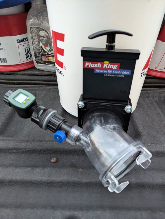

At the Rally I won this clear plastic that connects to a short hose and the connector to the flange on the bumper. It has a hose connection and a counter so I don't over fill the tank. I can do both tanks from the rear. I still like the back flush connection for the black tank. I don't have it handy at the moment. It has a handle to keep water filling the tank from emptying, and once full, I turn off the water at the unit and empty. I then close that tank and open the other and repeat.

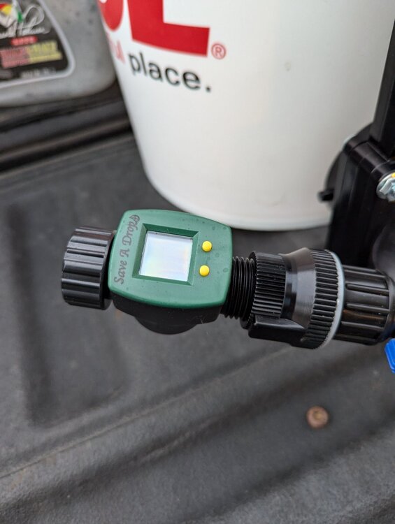

I use the Flush King and connect it to a short Camco hose in the bumper. I connect a hose to the connection on the left. The green thing is a "Save a drop" counter so I don't over fill. I dump each tank first. Empty the black and then the gray. I close the gray tank and reopen the black, turn the water on and watch the counter. There is a knob to turn off the water. Empty and repeat with the gray tank. I still like to use the black flush.
Tank Kleen did our tanks at the Rally. The black tank was spotless, but the gray tank was bad.
I use their Pine-Sol bath beads solution that Tank Kleen recommends, and add 3 gallons of water into the floor drain and 3 gallons into the toilet so it sloshes around while driving. If boondocking or extended camping I will limit adding water.
