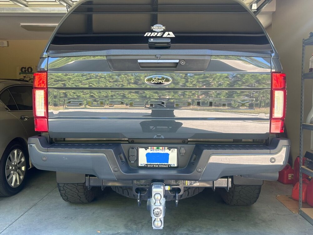

Our Beast of Burden gets a new tail hook ha!

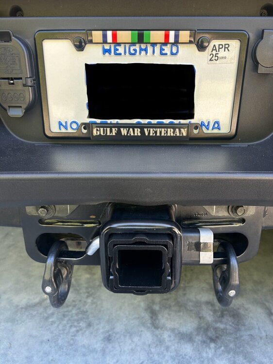

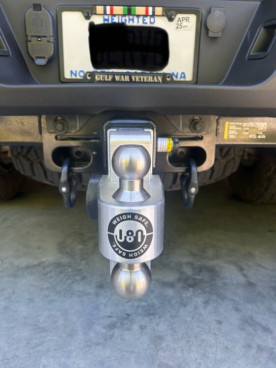

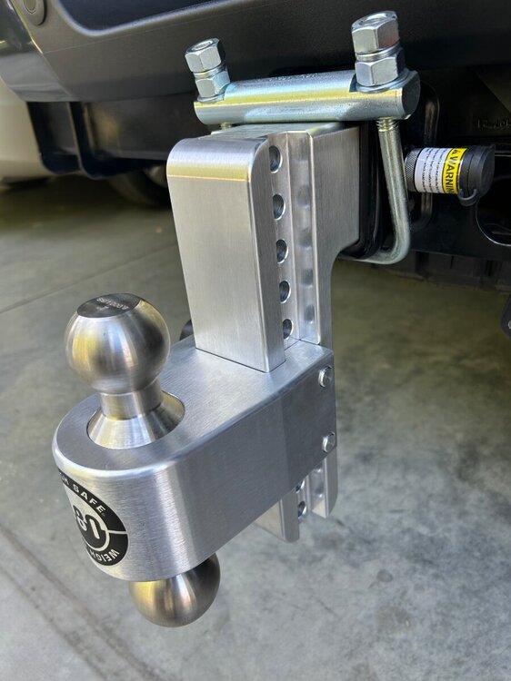

After doing a bit of a deep dive I decided to order up a new weigh safe aluminum 10” drop hitch with a 3” shank. I have been using 2 reducers and have never been a fan of them as they are a bit sloppy and noisy or simply too many moving parts.

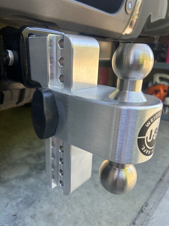

I have to say out of the box I am really impressed with how solid this hitch is engineered. Really well done.  I opted to not go with the tongue hitch weight dial. According to quite a few user reviews, these dials use a rubber seal/oring and at times can fail and then require maintenance by replacing the seal. When the O ring fails you will notice fluid leaking from the hitch 👎🏻. Just not something I ever want to think about….ever especially on a long trip.
I did opt in for the stainless steel 2” and 2 5/16 balls vs chrome plated hitch balls and locking hitch pic all keyed alike . B&W tow and stow is also a good hitch which I was also considering. My  preference has always been aluminum as rust and corrosion will eventually take its toll on steel powder coats so I passed.

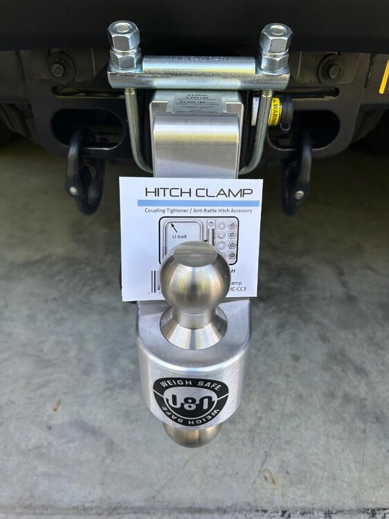

There is very little play with the new Weigh Safe 180 3” shank. That said, I did order this 3” anti rattle hitch clamp to keep everything buttoned up with zero play.
Edit- I ordered my hitch clamp directly their website. Quick shipping and excellent communication.
https://www.hitchclamp.com/collections/3-clamps
My reducers will no longer be used when towing XPLOR.

  • The title was changed to Weigh Safe 180 Aluminum hitch with 3” shank, 10” drop

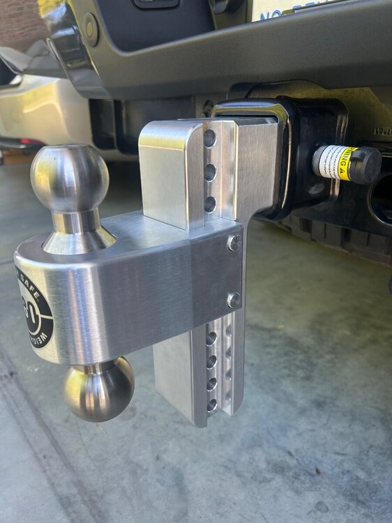

@Patriot questions…
Link for hitch, weight rating?
Also, what are the safety chain connectors we see in your last picture? Link! I need these. it’s difficult getting under there on our TV.
Thank you, JD

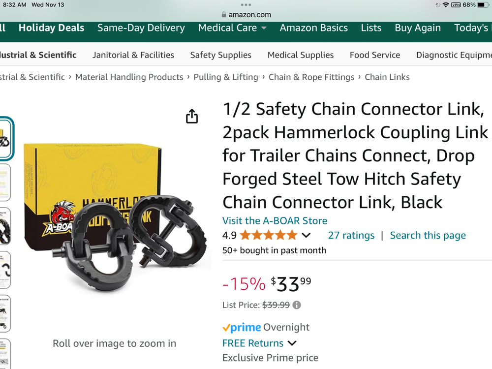

You bet JD, these are called 1/2” hammer locks and are rated for 12000 lbs ea. To your point they make it much easier to attach safety chains.
My Weigh Safe hitch is rated for 21,000 lbs.
link -https://www.weigh-safe.com/product/weigh-safe-drop-hitch/?srsltid=AfmBOoolgTCwKhll9w1HP7E1phPvIgecdRRK__EUlWP7DPInx6CUJx0T

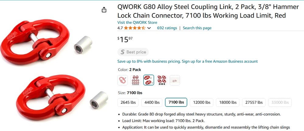

This was a JD discussion several years ago.  Below are what was recommended for our OE2's.  It is not likely, but should these bit the dust I would get the 12,000  pounders vs. the 7100's.  It sure solved the getting under the TV on our F-150.

I'll chime in on the hammer locks:
Patriot put me on to these a couple of years back and they are everything they are supposed to be as both Patriot and GJ state above.
Perhaps the only downside I can think of with these is that they could be a bit of a problem to remove.  But, why remove them?
A vid in the event you need to remove the hammerlocks. (No plans to here).😎
While attached to the receiver as @topgun2 said it could be a little bit of a challenge.
Edited by Patriot
Bill:  You hit the nail square on the head.
I found it a PITA to install, and will find a cutting torch or cut-off grinder to remove them if I ever need to.
Problem is getting the shackle on something under the truck, in a way to allow for pounding a moving target to install the pin, especially if doing this solo.  Would be a PITA for sure.  Like you, mine stay on our TV 24/7.

Found a brand that uses a cotter pin to secure the connecting rod, any thoughts?
2020 OLEll, Twin, 579:
The cotter pin just keeps the connecting rod in place. This model should work fine.
Also wondering on these. Most are rated at 2500#. This one at 11,000# wondering how? Stronger steel. Others are stainless steel which is certainly a weaker steel.
https://a.co/d/aeiJN3k
12,000# working capacity, 46,000# breaking capacity per Amazon’s description. Good enough for me!

My 3” hitch clamp arrived today. I decided to cancel my order with Amazon and order directly from Hitch Clamp for a much quicker delivery. Very impressed with the fit and finish of this product. Zero play or movement with this robust clamp. They also gave me a Veterans discount. 🇺🇸👍🏻
Edited by Patriot
Very nice. I could never decide which way was the correct installation orientation.
Thank you.
I had the same question when I called HC before placing my order. I spoke to a fella named Gabe. I asked him about proper fitment? He said it is designed to put the downward pressure on the shank vs the clamp lifting the down pressure/tongue weight up.
https://www.hitchclamp.com/pages/videos
Edited by Patriot
