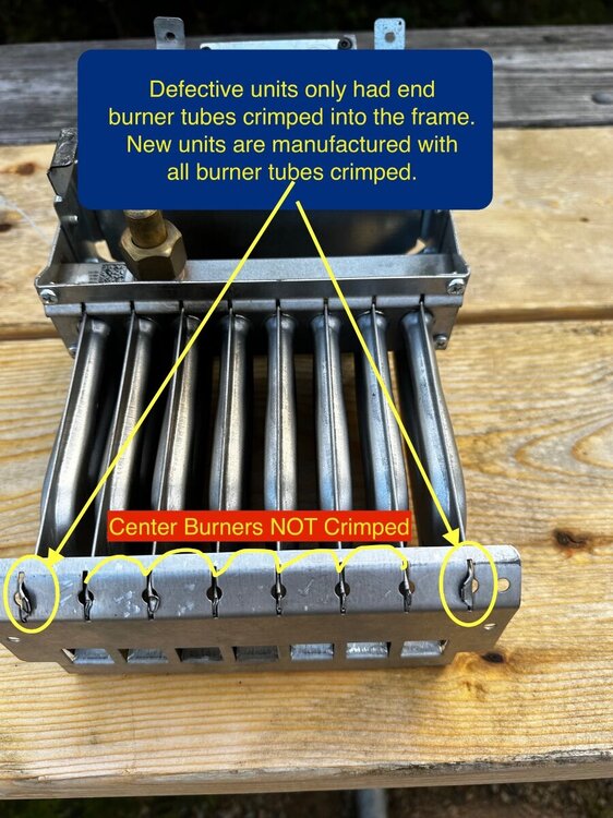

On 1/18/2025 at 9:01 AM, Galway Girl said:
Burner unit shown below only has end 2 tabs bent to crimp unit to frame.  This is the old design being recalled
I'll repost this picture to illustrate the purpose of the recall.
The recall is for water heater burner assemblies manufactured in the date range of the recall.
Those burner assemblies only had the two END burners crimped to the frame.   (See below pix.)
The result is after many miles of vibration or less on rough roads, the burner tubes are susceptible to falling out out of the frame.
When that happens, gas from the feed orfice that is no longer aligned with a burner tube pumps gas directly into the burner chamber.  On ignition you'll hear an explosive (whoosh/pop) type of ignition.
Most commonly that ignition also blows out the burner...and then the unit recycles as it try's again to light the heater.
Owners of units in the recall range should carefully listen and watch for unusual ignition events...which is a sign that a burner tube has fallen off the frame.
All new units being manufactured have ALL the burner tubes crimped in place.
The recalled units are replaced with newer burners with all the burners crimped to the frame.
Oliver is getting units from Truma but at a rate of 10-15/month...so patience is required for repairs.
Follow instructions in the Oliver Recall to get your unit repaired.
They can only send replacement burners to qualified repair centers.

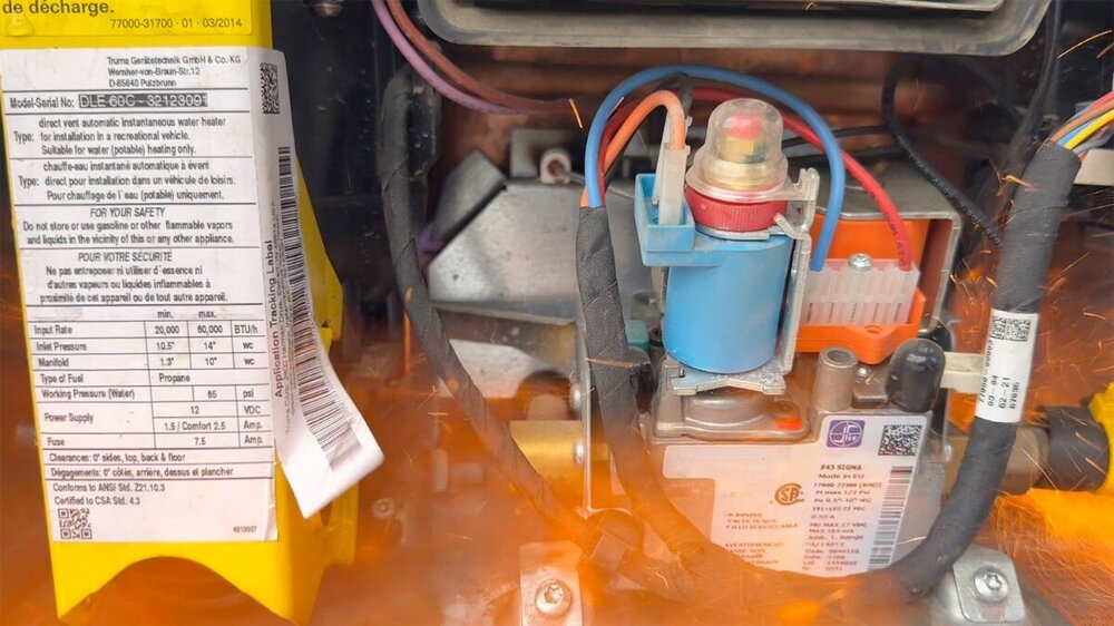

For the curious, here's a pix of an actual "ignition event" when a burner tube has fallen off:
As you see the flame is rather large and extends outside the burn chamber.
