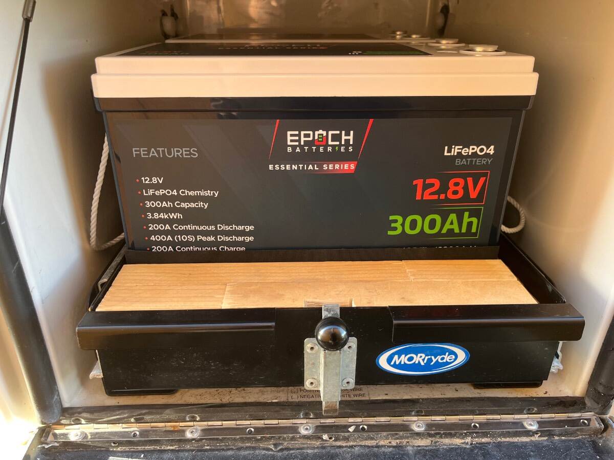

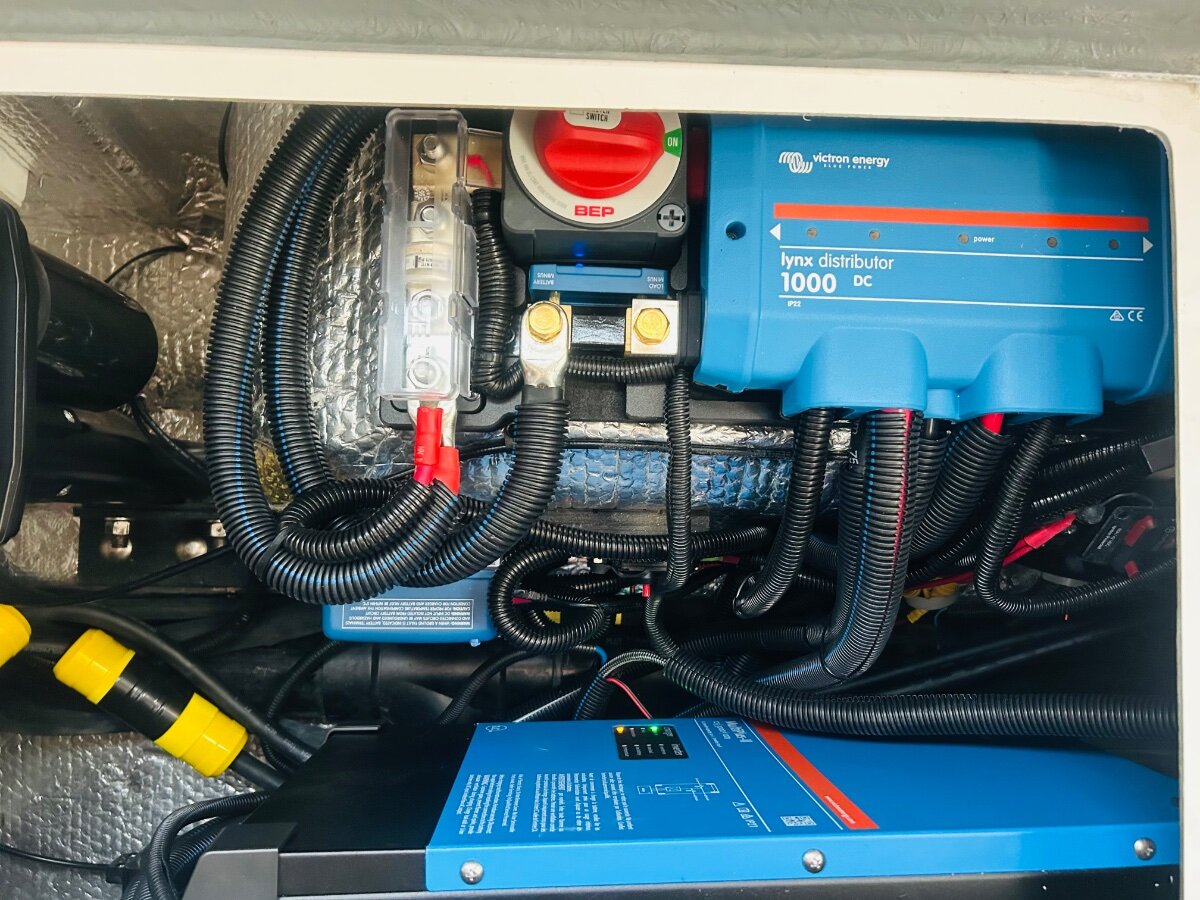

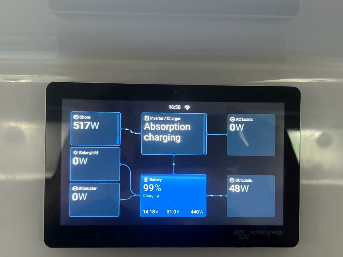

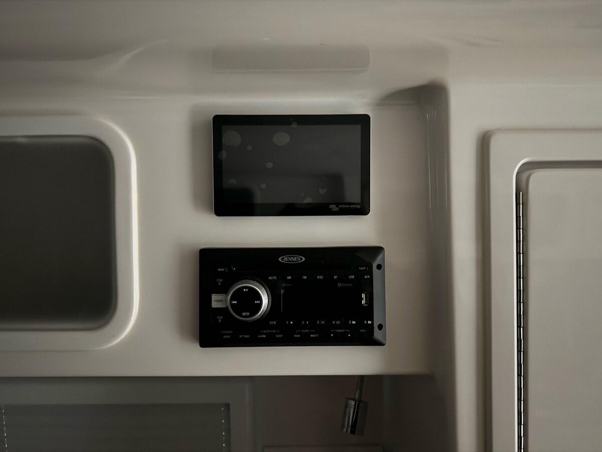

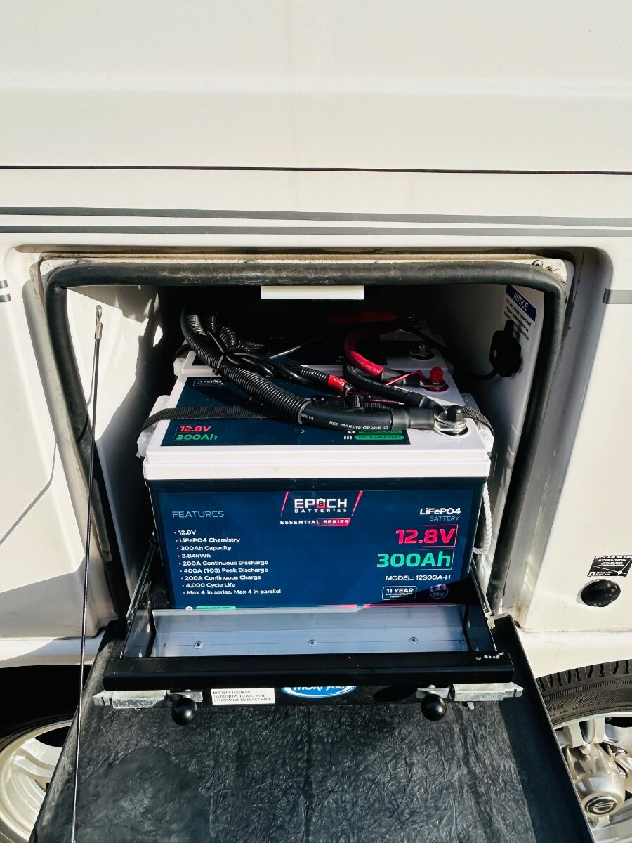

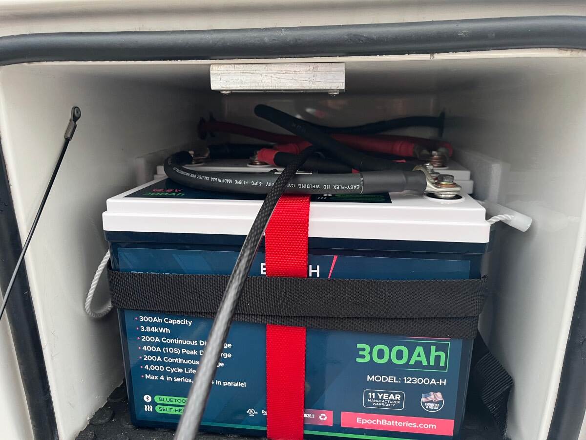

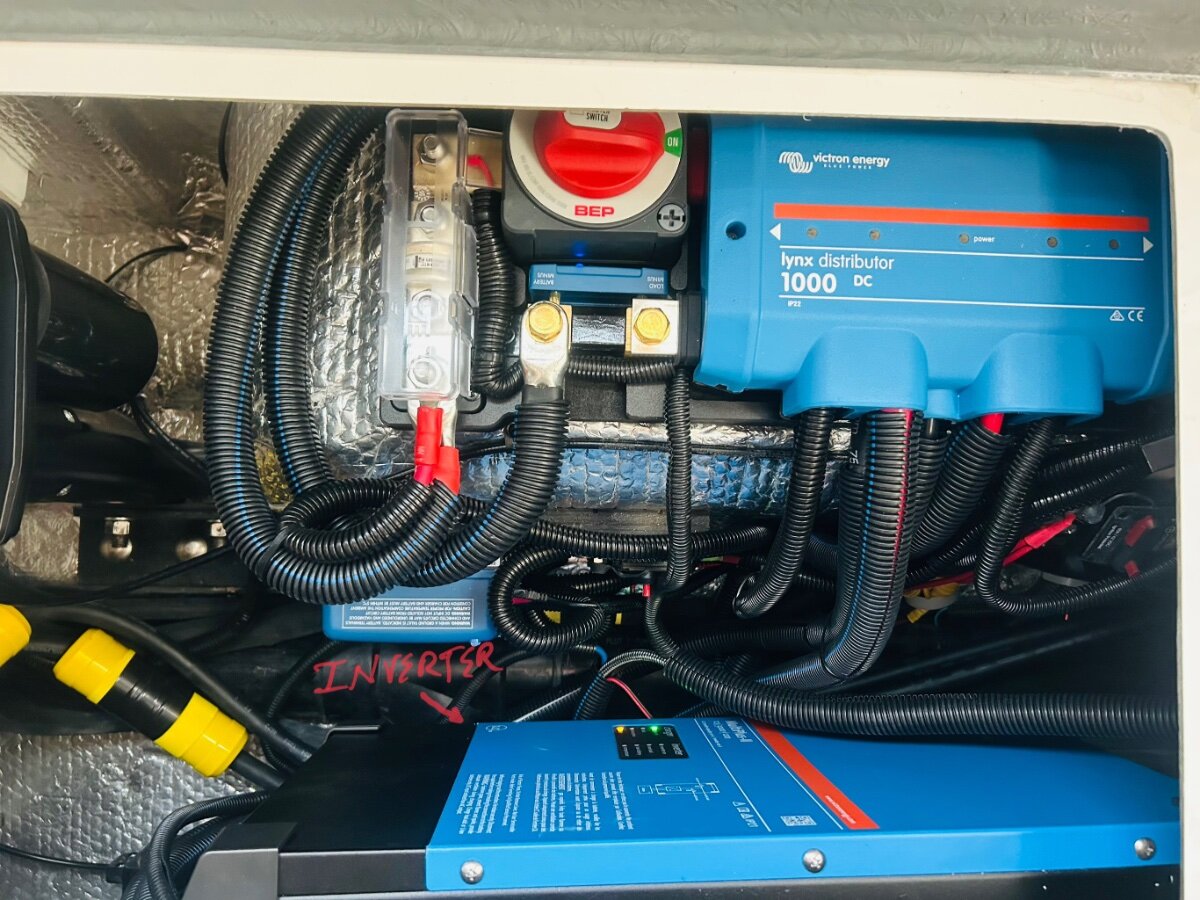

Popular Post Patriot Posted November 15 Popular Post Posted November 15 (edited) ***Long Post*** XPLOR Hull #634 Victron 3000 watt inverter, Victron 12v DC to DC charger and Epoch lithium battery upgrade. Note: To discuss options and pricing, please contact Jordan Hall at Inverter Services, White House, Tenn. Our OEM AGM batteries were getting long in the tooth and it was time to upgrade our batteries to a complete lithium battery system on our 2020 Oliver LE2. Our good friend, and former Oliver owner Jim Posey, highly recommended we speak with Inverter Services in White House, Tennessee. I called and spoke with Service Manager Jordan Hall and discussed our needs and options. Jordan and his team at Inverter Services were excellent to work with and have a lot of experience working on Oliver travel trailers. Our tech/installer, Easton Ford, kept us updated on our install progress with photos and discussions as needed. We found Easton to be extremely detail-oriented and dialed in and focused on our project. We were originally scheduled to have this work done next March. After returning from our 54 day New England and Canada trip, I decided to call Inverter Services and ask if they had any cancellations. They did and we immediately took the cancellation. They are typically booked 6-7 months out. So we hitched op Oliver and headed to White House, Tenn to leave our Oliver with the team for 2 weeks. Important note: Inverter Services supports the RV and Marine industry in ALL things lithium battery and electronics. This is one of the most detailed and thorough, cutting-edge companies we have ever done business with. I chose Inverter Services to do this install because this is not my area of expertise and it absolutely is theirs. These guys are experts in their field and I admittedly am still in the learning process. Based on our excellent experience, we highly recommend Inverter Services in White House, Tenn if you are considering a lithium upgrade. We chose all Epoch & Victron following products for this install. (2) Epoch 300ah lithium batteries (internal heating elements) -https://www.epochbatteries.com/.../12v-300ah-heated... *Victron MultiPlus-II 3000w Inverter/charger *Victron GX 70 Touch Screen *Victron Smart Solar MPPT *Victron Orion XS DC-DC Battery Charger **We also had the RV Soft Start installed on our Truma Aventa AC. Inverter Services provides tech guidance/support/firmware updates as long as we own our Oliver. I cannot stress enough the pride this company takes in their work. As I think most would agree, Victron components are a class all their own and leaders in the Marine and RV industry. Post install, we have on board 600ah of lithium battery power, and with our extra 90W Zamp panel now configured to lithium, we have approx 410 watts of solar. This will certainly give us more options on the roads less traveled and boondocking. Still lots to learn on this new system. Now having the 12v DC -DC charger I don’t think we will see a need to carry a generator any longer. Thanks to all those on the forum who made the Lithium upgrade happen. ⚡️ The information gleaned here helped me decide the direction I wanted to take this install. ⚡️Happy Camping and Safe Travels! ⚡️ A few install pics- The Victron GX 70 touch screen fit the existing opening with no cutting or trimming of the fiberglass. Our system at a glance. The touch screen nice option if no cell service is available for the Victron app. Although with our SL mini that’s not an issue. Very happy with the touch screen and the Victron app. We can set the screen to time out at 5 or 10 min or longer and then go dark for sleep mode. Zamp 90W suitcase. 12v DC to DC Andersen connector. On our way home we camped at Cumberland Mountain SP in Tenn and gave our new system a shake down. It’s nice to not have to plug in. 😊 Edited Sunday at 06:47 AM by Patriot 6 8 1 2020 OLEII - Hull #634 aka- “XPLOR” TV 2021 F350 6.7 liter Diesel Lariat Ultimate Tremor aka - “Beast of Burden” Truma Aventa 13.5 AC, Alcan 5 leaf pack, Alcan HD shackles & HD wet bolts, 5200lb never lube axles.XPEL 10 mil PPF front both front corners, 30 lb LP tanks, Sea Biscuit Front Cargo Storage box. ⚡️⚡️11/2025- Lithium upgrade to XPLOR - (2) Epoch 300ah Lithium batteries, Victron 3000W MultiPlus-II, Victron GX Touch 70, Victron Cerbo GX, Victron Smart Solar MPPT, Victron Smart Shunt, Victron Orion XS 1400 DC-DC charger, RV Soft Start. Zamp 90W suit case solar panel for 420W of solar.⚡️⚡️ North Carolina

Geronimo John Posted November 15 Posted November 15 David: Where did you have the Inverter/Converter installed? John TV: 2019 F-150 SuperCrew Lariat, 3.5L EcoBoost, 10 Speed Trans, Max Tow, FX-4, Rear Locker OLLIE: 2018 OE2 Hull 342, Twin Bed. OLLIE DIY’s: Timken Bearings, BB LiFePO4's, Victron 712 Smart, 350 Amp Master Switch, Houghton 3400, Victron Orion DC - DC, 3000-Watt Renogy Inverter, P.D. 60-amp Converter, Frig Dual Exhaust Fans, Kitchen Drawer Straps. Front Wardrobe Shelves, Snuggle Shelf. TV DIY’s: 2 5/16" Anderson System, Nitto recon’s, Firestone Rear Air Bags, Bilstein 5100’s, Mud Flaps & Weather Tech all, installed Ham Radio (WH6JPR).
Patriot Posted November 15 Author Posted November 15 (edited) 41 minutes ago, Geronimo John said: David: Where did you have the Inverter/Converter installed? John John, Under the rear street side bed right where the former Xantrex 2000 was installed by Oliver. A custom platform was added to secure the longer a heavier Victron Inverter/charger. Edited November 15 by Patriot 1 1 2 2020 OLEII - Hull #634 aka- “XPLOR” TV 2021 F350 6.7 liter Diesel Lariat Ultimate Tremor aka - “Beast of Burden” Truma Aventa 13.5 AC, Alcan 5 leaf pack, Alcan HD shackles & HD wet bolts, 5200lb never lube axles.XPEL 10 mil PPF front both front corners, 30 lb LP tanks, Sea Biscuit Front Cargo Storage box. ⚡️⚡️11/2025- Lithium upgrade to XPLOR - (2) Epoch 300ah Lithium batteries, Victron 3000W MultiPlus-II, Victron GX Touch 70, Victron Cerbo GX, Victron Smart Solar MPPT, Victron Smart Shunt, Victron Orion XS 1400 DC-DC charger, RV Soft Start. Zamp 90W suit case solar panel for 420W of solar.⚡️⚡️ North Carolina

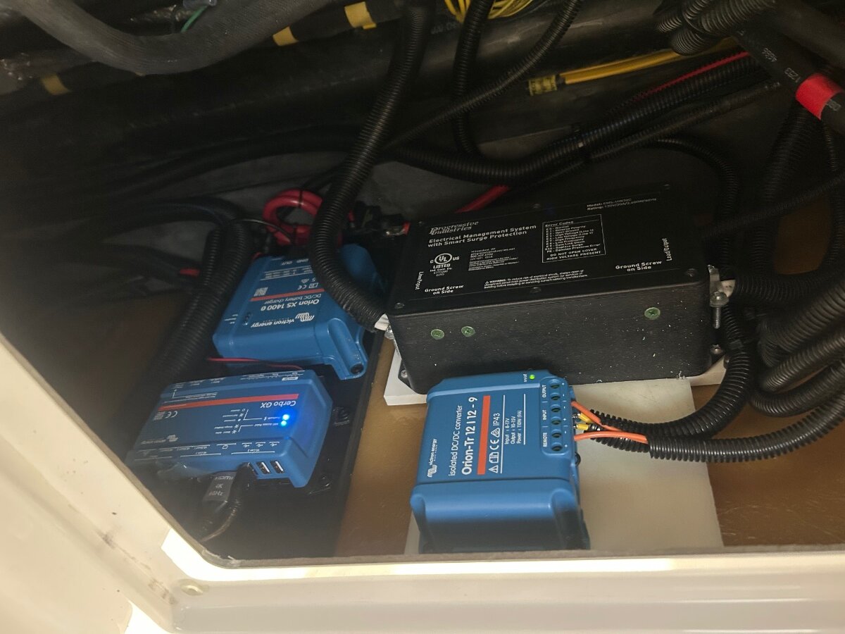

Moderators mossemi Posted November 19 Moderators Posted November 19 @Patriot I have a couple of questions about your Victron/Epoch installation. Do you know what the black material is that they used for mounting the Victron equipment and Andersen connector? I also noticed that you have both an Orion XS 1400 DC/DC charger and an Orion-Tr 12|12 - 9 DC to DC converter. You mentioned that the Orion XS 1400 DC/DC charger was part of the lithium upgrade, so what is the purpose of the Orion-Tr 12|12 - 9 DC to DC converter? Mossey 1 2 Mike and Krunch Lutz, FL 2017 LEII #193 “the dog house”
Patriot Posted November 19 Author Posted November 19 (edited) 5 hours ago, mossemi said: so what is the purpose of the Orion-Tr 12|12 - 9 DC to DC converter? Here are my thoughts: edited- We previously owned an Overland Trailer (which had a Max Air fan). We experienced a voltage issue so I had the Orion-Tr 12/12-9 installed to stabilize and maintain 12v power to the fan. Now I do not have to be concerned about possible spikes or a malfunctioning control board. Max Air Fans operating above 13.8v can damage the fans control board. This will prevent damage to the sensitive control board. The black plastic board material used to secure all components is called Starboard or Black HDPE and I can tell you it’s super tough and used in Marine grade applications. Inverter Services uses lots of this material during their installs. Here - https://www.amazon.com/gp/aw/d/B08M6DJNH4/?_ Open Source info on Max Air Fans- *** MaxxAir fans are designed for a 12 Volt DC system, operating within a voltage range of approximately 10.6–13.6V, with an optimal test voltage of 12.8V. Operating above 13.8V can damage the fan's control board and void the warranty, especially if the system is charging. To prevent issues from voltage spikes, a DC/DC voltage regulator is recommended for stable power, especially when the vehicle's charging system is active. Edited November 19 by Patriot 2 3 2020 OLEII - Hull #634 aka- “XPLOR” TV 2021 F350 6.7 liter Diesel Lariat Ultimate Tremor aka - “Beast of Burden” Truma Aventa 13.5 AC, Alcan 5 leaf pack, Alcan HD shackles & HD wet bolts, 5200lb never lube axles.XPEL 10 mil PPF front both front corners, 30 lb LP tanks, Sea Biscuit Front Cargo Storage box. ⚡️⚡️11/2025- Lithium upgrade to XPLOR - (2) Epoch 300ah Lithium batteries, Victron 3000W MultiPlus-II, Victron GX Touch 70, Victron Cerbo GX, Victron Smart Solar MPPT, Victron Smart Shunt, Victron Orion XS 1400 DC-DC charger, RV Soft Start. Zamp 90W suit case solar panel for 420W of solar.⚡️⚡️ North Carolina
rideandfly Posted November 19 Posted November 19 (edited) 2 hours ago, Patriot said: Let’s see, in my best kitchen english my thoughts as I am not an electrician or electronics wiz, but am learning - 😊 From previous experience from an Overland Trailer we owned which had Max Air fan and we had a voltage issue with, I requested the Orion-Tr 12/12-9 install to stabilize and maintain 12v power to the Max Air Fan and not to be concerned about possible spikes and a fried or wonky control board. Max Air Fans operating above 13.8v can damage the fans control board. This will prevent damage or ward off the potential electrical gremlins to the sensitive control board. Open Source info on Max Air Fans- *** MaxxAir fans are designed for a 12 Volt DC system, operating within a voltage range of approximately 10.6–13.6V, with an optimal test voltage of 12.8V. Operating above 13.8V can damage the fan's control board and void the warranty, especially if the system is charging. To prevent issues from voltage spikes, a DC/DC voltage regulator is recommended for stable power, especially when the vehicle's charging system is active. I'm not familiar with factory solar/lithium systems installed from Oliver and like David, still learning about electrical/electronics. We installed Battleborn Lithium battery with Renogy Solar controller that we use with up to two solar suitcases, and an onboard progressive Lithium charger. We had issues with our MaxxAir fan. It started beeping and a green light on the unit started flashing. Checked internet and found Lithium batteries can cause high voltage issues with MaxxAir fans, when we had the issues we were on shore power, the Progressive lithium charger had our 12V system at 14.4V DC. Also gave MaxxAir/Airxcel technical support a call and they confirmed lithium battery higher voltage can cause the problem we were having with the MaxxAir fan. This had me wondering if the higher lithium voltage would cause issues with other 12V components, checked with Jensen and they said our TV was tested to 16 to 17V without issues. I don't know about other 12V components on Ollie, yet. We installed a DC to DC converter (12.3V output) from Amazon, secured with Velcro. Also replaced the fan's circuit board with one from Amazon, probably unnecessary. It's working OK now. https://www.amazon.com/dp/B081RG8XP5?ref=ppx_yo2ov_dt_b_fed_asin_title&th=1 Found this on YouTube: Edited November 19 by rideandfly 2 3 Bill 2015 LE2 #75 2024 F350 6.8L
Snackchaser Posted November 19 Posted November 19 Interesting! Apparently fans manufactured after Jan 2022 have the new boards which are not impacted by higher voltages from lithium chargers. Fans with a serial number starting with 22 should have the new board. I should be in the clear. . . darn! Thought I had a new project there for a moment! 4
Moderators mossemi Posted November 20 Moderators Posted November 20 @Patriot Thank you for answering my first 2 questions! The Victron Orion 12|12 - 9 installation location confused me, the converter I installed for the MAXXAIR fan voltage issue is in the attic area. I am familiar with Starboard products, as they are produced in Florida and I have used some around the house. I am always looking for different ways to do things and was wondering how Inverter Services attached the Starboard to the Oliver’s fiberglass? Mossey 2 Mike and Krunch Lutz, FL 2017 LEII #193 “the dog house”
Patriot Posted November 20 Author Posted November 20 3 hours ago, mossemi said: how Inverter Services attached the Starboard to the Oliver’s fiberglass? They use a really strong industrial strength glue which I do not recall the name of. I do know that they use this adhesive in ALL their RV and Marine fiberglass installs. The next time I speak to the good folks at Inverter Services, I will try and remember to ask him about the adhesive they use. 👍🏻 1 2 2020 OLEII - Hull #634 aka- “XPLOR” TV 2021 F350 6.7 liter Diesel Lariat Ultimate Tremor aka - “Beast of Burden” Truma Aventa 13.5 AC, Alcan 5 leaf pack, Alcan HD shackles & HD wet bolts, 5200lb never lube axles.XPEL 10 mil PPF front both front corners, 30 lb LP tanks, Sea Biscuit Front Cargo Storage box. ⚡️⚡️11/2025- Lithium upgrade to XPLOR - (2) Epoch 300ah Lithium batteries, Victron 3000W MultiPlus-II, Victron GX Touch 70, Victron Cerbo GX, Victron Smart Solar MPPT, Victron Smart Shunt, Victron Orion XS 1400 DC-DC charger, RV Soft Start. Zamp 90W suit case solar panel for 420W of solar.⚡️⚡️ North Carolina
mountainoliver Posted November 20 Posted November 20 “We previously owned an Overland Trailer (which had a Max Air fan). We experienced a voltage issue so I had the Orion-Tr 12/12-9 installed to stabilize and maintain 12v power to the fan. Now I do not have to be concerned about possible spikes or a malfunctioning control board. Max Air Fans operating above 13.8v can damage the fans control board. This will prevent damage to the sensitive control board.” I also had read about this issue with the Maxxfan control board around the time I changed my batteries to lithium about four years ago. I added the Drok buck/boost circuit to run both the bath fan and the Maxxfan and suggested using the Drok circuit for anyone with lithium batteries as a safety precaution. To my knowledge all other “12 volt” appliances are designed to withstand over the typical lithium battery voltage without any issues. 1 6 2017 Elite II, Hull #208 2019 Chevy HD 2500 Duramax
rideandfly Posted November 21 Posted November 21 4 hours ago, mountainoliver said: To my knowledge all other “12 volt” appliances are designed to withstand over the typical lithium battery voltage without any issues. Appreciate info on the other 12V components! 1 Bill 2015 LE2 #75 2024 F350 6.8L
Patriot Posted November 23 Author Posted November 23 Epoch Lithium Battery Storage Info- I reached out to Epoch Battery Lithium battery customer service (Stockbridge, Georgia) regarding our recent install of (2) of Epoch 300ah (self heating) batteries in our OLE2 and correct SOC during short term winter storage. They responded quickly and this is the guidance they provided. This information is for anyone that now owns or is considering a swap at some point from aging AGMs over to Epoch 300ah batteries. Epoch recommends 1-6 months in storage a 50-70% SOC. Epoch does not recommend leaving the batteries plugged in 24x7 via 30amp power and maintaining the batteries at 100% SOC during storage months. Just passing it forward! 1 1 2020 OLEII - Hull #634 aka- “XPLOR” TV 2021 F350 6.7 liter Diesel Lariat Ultimate Tremor aka - “Beast of Burden” Truma Aventa 13.5 AC, Alcan 5 leaf pack, Alcan HD shackles & HD wet bolts, 5200lb never lube axles.XPEL 10 mil PPF front both front corners, 30 lb LP tanks, Sea Biscuit Front Cargo Storage box. ⚡️⚡️11/2025- Lithium upgrade to XPLOR - (2) Epoch 300ah Lithium batteries, Victron 3000W MultiPlus-II, Victron GX Touch 70, Victron Cerbo GX, Victron Smart Solar MPPT, Victron Smart Shunt, Victron Orion XS 1400 DC-DC charger, RV Soft Start. Zamp 90W suit case solar panel for 420W of solar.⚡️⚡️ North Carolina
Patriot Posted November 24 Author Posted November 24 (edited) A little more detailed info on battery storage I received from Epoch. ⚡ If You Must Leave the Battery Installed Cold climates: • Keep the battery connected to a powered LiFePO₄ charger or maintainer so the internal heater can operate. o The heater only runs when the battery is plugged into an active power source. o Solar panels alone usually can’t provide enough energy at night or during long cloudy stretches. • Do not attempt to charge the battery below 32 °F (0 °C) unless the heater is operating. Temperate or warm climates: • A small solar maintainer can work if days are sunny and parasitic draws are very low. • If possible, connect to shore power or plug in occasionally to ensure a full top-up. • Avoid long periods at 100% charge — this shortens battery life. 🔌 Before Storage 1. Charge to about 50% SOC (roughly 13.1–13.2 V for 12 V systems). 2. Turn off or disconnect all non-essential loads. Even a tiny 50 mA draw can drain 36 Ah per month! 3. Use a battery disconnect switch or pull the main fuse if possible. 4. Confirm heater power if you plan to leave the battery in a freezing location. 🧯 Step 3 – Understand heater and charger operation • Epoch batteries with internal heaters must be connected to an active charger for the heater to receive power. • The heater automatically turns on when the internal temperature drops near freezing and turns off when warm enough to charge. • If no power source is available, the heater cannot run, and charging below freezing must be avoided. ⚠️ Never try to “force charge” a cold battery. Doing so can cause permanent damage. 🧭 Step 4 – Check occasionally • Installed batteries: check voltage or Bluetooth app monthly. • Stored indoors: check every 1–3 months. If voltage falls below about 13.0 V (12 V system) or 26.0 V (24 V system), recharge briefly to about 50% SOC. 🌡️ Summary Table Storage Location Climate Recommended SOC Charger Needed? Heater Power Notes Indoors (best) Any 40–60% No N/A Check every 2 mo. Installed + Shore Power Cold/Temperate 40–60% Yes – active Yes Ideal if removal not practical Installed + Solar Only Temperate 40–60% Possibly Maybe Risky in long cloudy/cold spells Installed + No Charger Any 50% No No Disconnect all loads; check monthly ⚠️ Quick Reminders • Do not charge below 32 °F (0 °C) unless the internal heater is powered. • Avoid storing at 100% charge for more than a few weeks. • Avoid high heat (above 86 °F / 30 °C) during long storage. • Use only LiFePO₄-compatible chargers (Victron, Epoch, or similar). • Always follow Epoch’s voltage and temperature specifications for your model. 🏁 Spring Startup 1. Inspect cables and terminals. 2. Reconnect any disconnect switches or fuses. 3. Bring the battery to full charge before first use. 4. Verify normal operation in the Epoch App or Victron monitor. Questions or Support If you’re unsure which option is right for your climate or setup, contact your authorized Epoch dealer or support team. They can help you confirm heater operation and charger compatibility. Edited November 24 by Patriot 1 2020 OLEII - Hull #634 aka- “XPLOR” TV 2021 F350 6.7 liter Diesel Lariat Ultimate Tremor aka - “Beast of Burden” Truma Aventa 13.5 AC, Alcan 5 leaf pack, Alcan HD shackles & HD wet bolts, 5200lb never lube axles.XPEL 10 mil PPF front both front corners, 30 lb LP tanks, Sea Biscuit Front Cargo Storage box. ⚡️⚡️11/2025- Lithium upgrade to XPLOR - (2) Epoch 300ah Lithium batteries, Victron 3000W MultiPlus-II, Victron GX Touch 70, Victron Cerbo GX, Victron Smart Solar MPPT, Victron Smart Shunt, Victron Orion XS 1400 DC-DC charger, RV Soft Start. Zamp 90W suit case solar panel for 420W of solar.⚡️⚡️ North Carolina
