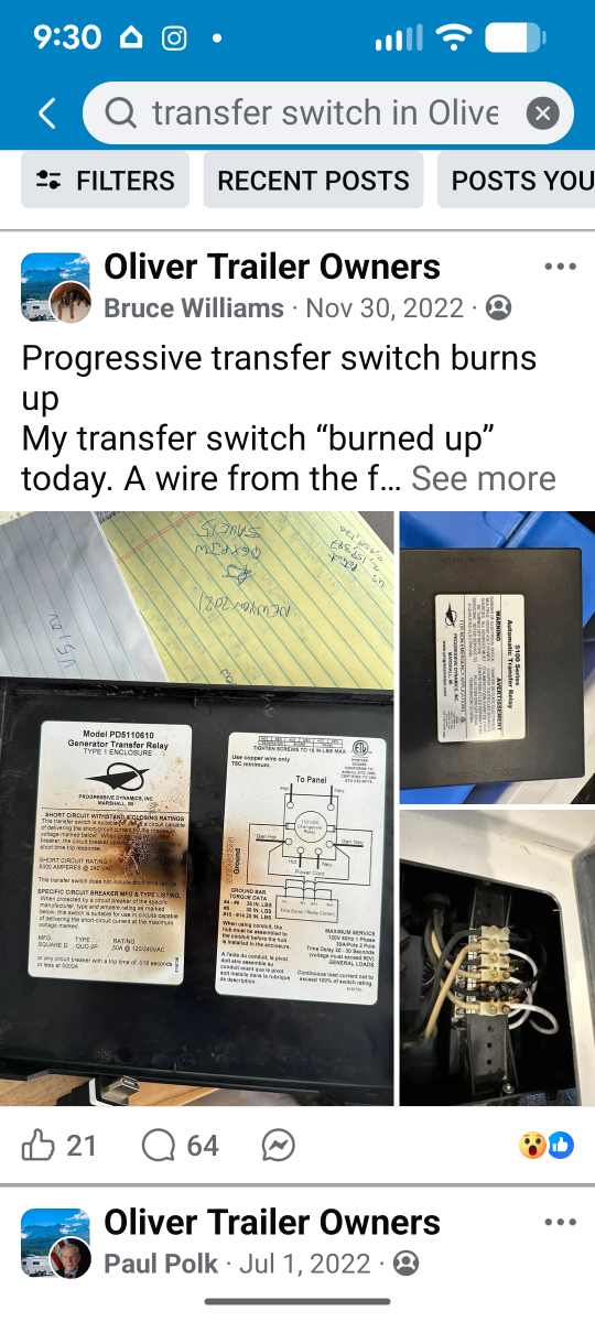

-image.jpeg.9e7303babcb28d7f6badb799734c6e44.jpegALAZARCACOCTDEFLGAIDILINIAKSKYLAMEMDMAMI
From Chris Scharff's transfer switch replacement and another Owner who had burned wires

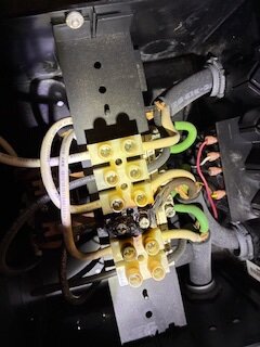

Reminder, the ATR switch box should be an annual inspectable item.  I just checked mine too since I could not find my old pictures. My old box was very difficult, and scary, to push in the sides of the box to release the tabs.  The new box is MUCH easier to push in and release the tabs.
Here is the new style ATR switch box (I only order this type of important items. from eTrailer, NOT Amazon: https://www.etrailer.com/RV-Transfer-Switch/Progressive-Dynamics/PD5110010Q.html

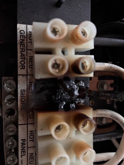

the box is toasted..... imaged attached.  I'll send more about our adventure later.

1 hour ago, taylor.coyote said:
the box is toasted..... imaged attached.  I send more about our adventure later.
Glad you all are safe. The replacement unit will be much better and safer.
