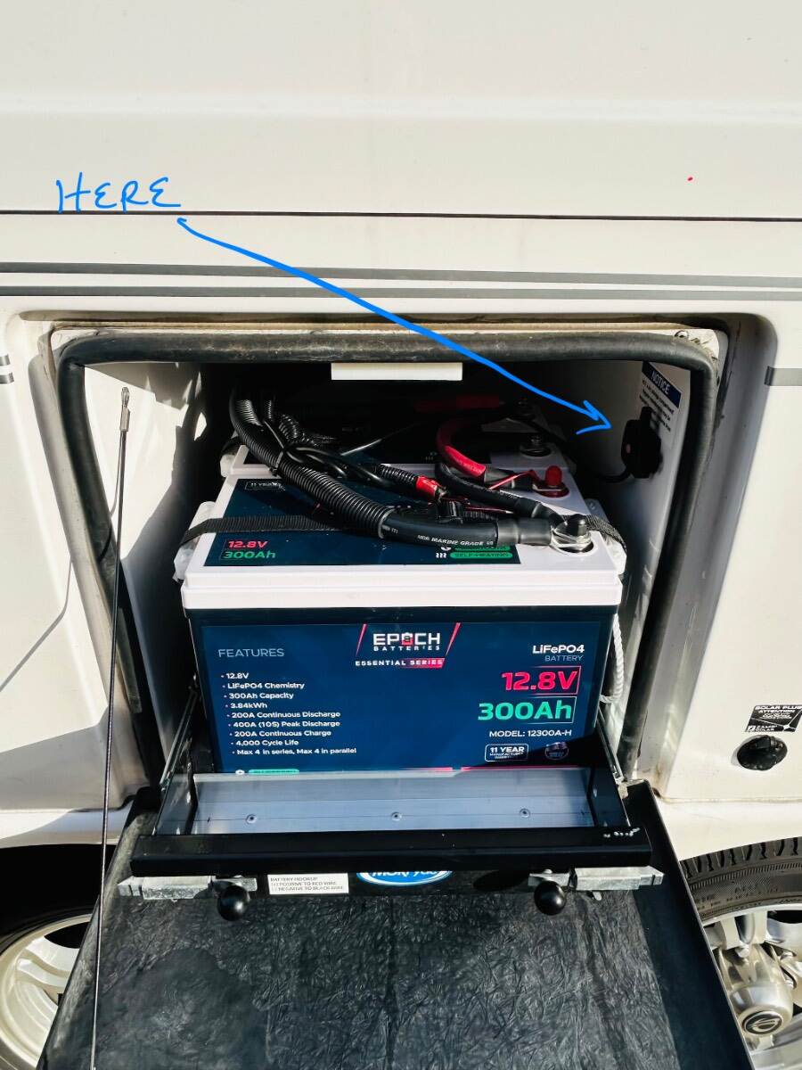

We have been using a TST TPMS for several years. I opted to mount our TPMS relay out of the weather and UV exposure inside the main battery compartment with tiny strip velcro. It has worked flawlessly since installation. All I did was attach it to my battery terminals. Keep in mind this relay creates  a very low parasitic draw on your house batteries. Not an issue in my case, as XPLOR is parked at home and always plugged into 30 amp.
I did the same, works great for both trailer and TV tires!
