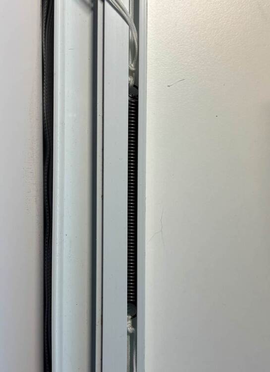

One of my window shades developed a problem.  The outer nylon covering of one of the cords has separated from the inner core and is bunching up between the pleats, preventing the shade from collapsing/folding completely (see photo).  I can only collapse the night shade partially now, leaving a quarter to a third of the shade unfolded.
This thread has been very helpful to understand what I need to attempt and how.  This does seem difficult and potentially frustrating to tackle...  Thank you to those who have shared info and tips!
? Question to those that have replaced broken cords:  Can I dissasemble the shade frame and replace just one of the four cords and leave the others in place?  Do I have to release tension on all four cords and take everything apart and start over?

It's not as difficult as it looks, I would replace them all so you have the same size/age cords in that shade.
Yes, it is possible for you to only restring one side.  But, if one broke then I'd guess that the other side is not far behind.  Besides, since you have to basically take the frame apart to do one side, you might as well go ahead and do the other side while you are there.
