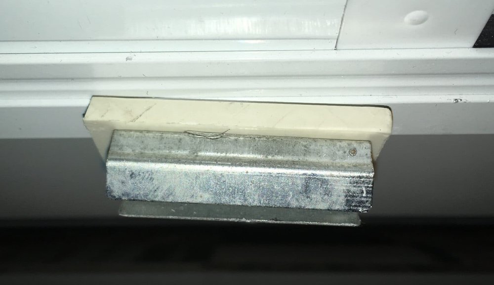

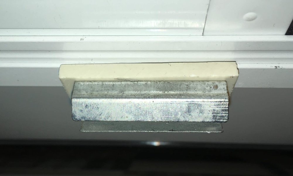

John E Davies Posted September 25, 2017 Posted September 25, 2017 The blind are not secure and you may find one lying on the bed or floor, and it is due to improper installation of the steel brackets. On my trailer, in many cases the bracket did not sit flush and parallel with the others. This is due to the hole in the hard spacer being drilled too small. The hole must be bigger than the screw diameter, so that the screw will pull everything into position. You need to remove all the brackets and open up the spacer holes. Removing the blind frame is simple, grab at the top and bottom and pull hard toward you. When reinstalling, center the frame in the window (left to right), align the bottom brackets with the slot in the plastic, and smack the area at each bracket with your fist. Then do the top side. When the brackets are parallel and aligned, the frame will go on easily and it should stay in place. You can tweek a bracket by bending the two ears, if you find a loose one. Before: After: SAFETY NOTE: when removing a bracket with a power driver, keep your fingers away from the part since it will spin and might slice your fingers! If you want to make your blinds more functional, flip them 180 degrees, so that the dark section is on the bottom. As postioned by the factory: Rotated, now you can tow with the blinds down and the lighter shades will let lots of light into the interior: And you can raise the lower section a few inches for privacy when camping: It's easy to try this configuration and switch back if you don't like it. Now we can talk about the ugly frame color..... John Davies Spokane WA 6 1 SOLD 07/23 "Mouse": 2017 Legacy Elite II Two Beds, Hull Number 218, See my HOW TO threads: Tow Vehicle: 2013 Land Cruiser 200, 32” LT tires, airbags, Safari snorkel, Maggiolina Grand Tour 360 Carbon RTT.

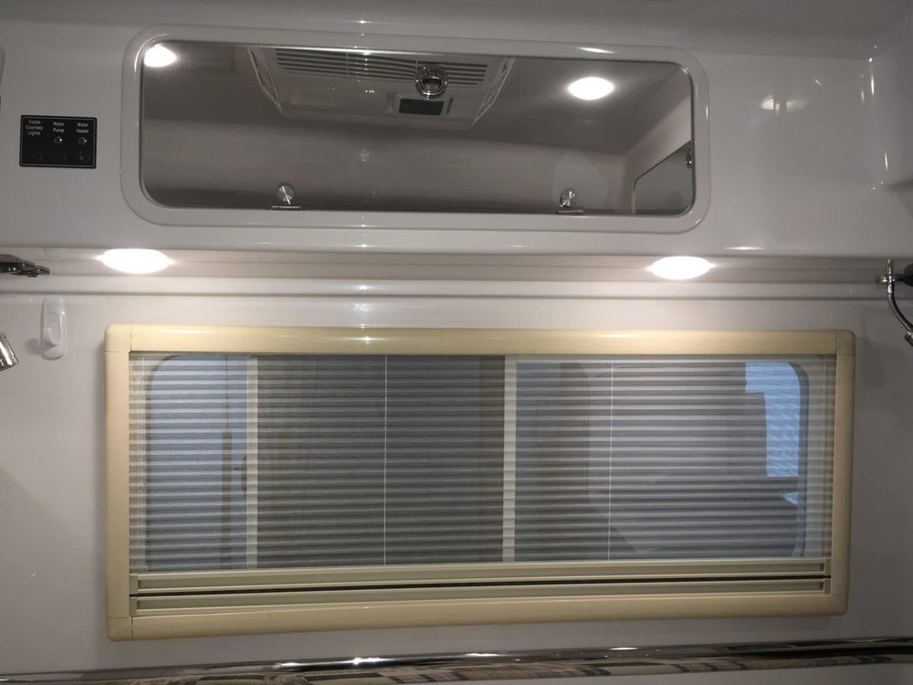

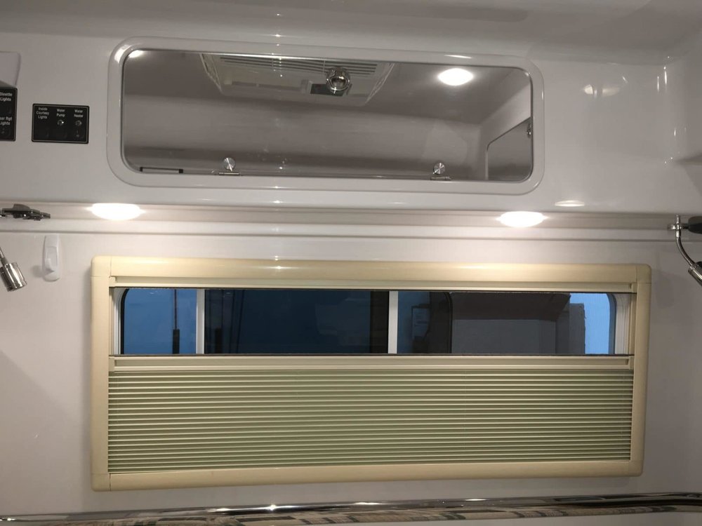

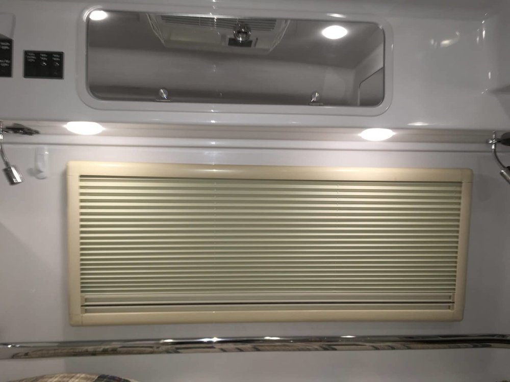

rich.dev Posted December 7, 2022 Posted December 7, 2022 On 9/25/2017 at 6:25 PM, John E Davies said: If you want to make your blinds more functional, flip them 180 degrees, so that the dark section is on the bottom. Thanks John, so glad I found this thread, was hoping I could flip the blinds so the blackout is on the bottom! 🙂 Hope this function will still be possible on the newer 2023 LEII! 2 2023 Elite II, Hull# 1386, Lithium Platinum Package (640AH, 400W Roof Solar, 3000W Xantrex Inverter), added 400W Renogy Solar suitcase with Victron MPPT 100/30 CC, Truma water heater & AC TV: 2024 Silverado 2500HD 6.6L 10-Speed Allison
