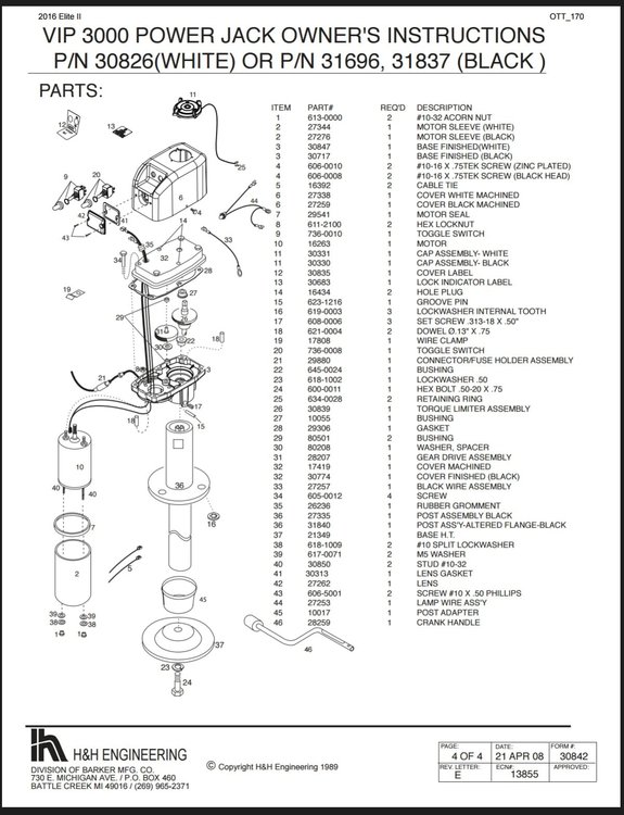

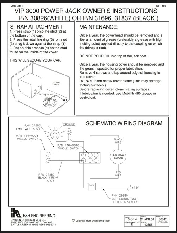

You need to have the 2016 owners manual also, that's what makes it complete... At least for me anyway. There's links to both online manuals in .pdf format on our Oliver Owners Face Book page. Both the front and rear jacks are the same. The only difference in the front is they put the plastic head cover over it that holds the light and the switch being that it's completely outside. Once you pull that off, it's the same as the rear jacks. Hey! A couple fuses was it! you're lucky :) My intermittent problem will be fixed some day... Lol. Here's the jack pages for future reference.
I do agree with the 2017 manual being incomplete, but I won't go on about Oliver's corner cutting for increased profit margins on the 2017's here, these files are from the 2016 manual. They have the same interior design but the head cover of the front jack has been changed since then and needs to be pulled for access.
