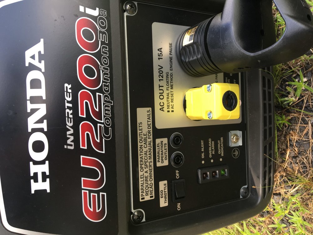

My wife and I just picked up the Oliver last week and are now in Moab. We would like to use the generator I purchased in advance. It is a iGen2200 by Westinghouse. it is similar to the Honda and received excellent reviews for boondocking. I have the 30amp adapter and hooked it up to the Ollie and I get nothing. No AC power and no air conditioner (we did order the EZ Start from the factory).
What am I missing? I looked in the manual and nothing was mentioned. Am I missing a switch or a button somewhere. I assumed that when I hooked up the generator that the Oliver would sense the AC power and revert to that.

Your EMS (surge protector) is probably seeing the generator as a open ground. Look at the display and see if there is a error code. You will need to turn off the EMS at the display under the left side bed in order for the power to pass to the trailer. You will need to get a netural to ground bonding plug and plug into the generator to correct the problem to use the EMS with the generator. Of course bypassing the EMS will leave you unprotected from low or over voltage problems should you have them.

Yep, you can turn off your surge suppressor at the remote display, but the grounding plug mentioned is a much better solution. You should have one tucked in a galley drawer, supplied by Oliver. Just plug it into one of your 110 v outlets on the generator, and your cord in the other outlet. It should work fine. If you don’t have one, try to buy one locally.

Well, I'm an idiot. The wife and I specifically made a stop to buy an adaptor in the middle of NM, and I found one supplied by Oliver in the back. The bad news is that it is just that, an adaptor, not a complete solution as I had to turn off the EMS as instructed above. The good news is that I have two adaptor plugs and the ability to run the AC if need be.

I made one with an extra 115volt male plug and a short piece 1” or so 12ga wire. Bond ground to neutral. With ground on on bottom, neutral should be the plug on the left. Terminal is sometimes silver colored while the hot side is brass colored. Make sure you get the correct one. I suggest using a voltmeter to check voltage between the pins. You should see zero voltage potential between ground and the pin you are grounding to.
