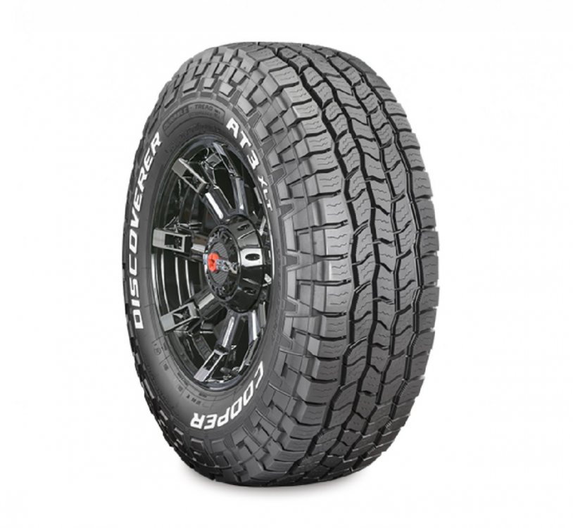

John E Davies Posted January 26, 2020 Share Posted January 26, 2020 There are a whole bunch of Discoverer tires, that is the model range for their LT tires. I guess that narrows it down to 15 possibilities.... http://us.coopertire.com/tires/view-tires?viewalltire=all Eventually a more detailed description will follow. .... my guess is that it will be a standard All Season road tire like the HTP. John Davies Spokane WA SOLD 07/23 "Mouse": 2017 Legacy Elite II Two Beds, Hull Number 218, See my HOW TO threads: Tow Vehicle: 2013 Land Cruiser 200, 32” LT tires, airbags, Safari snorkel, Maggiolina Grand Tour 360 Carbon RTT. Link to comment Share on other sites More sharing options...
Galway Girl Posted January 26, 2020 Share Posted January 26, 2020 Yup...I'll likely see the info and post tomorrow on which specific tire. I note that the 'Oliver University' page hasn't caught up with these production changes yet...and neither the tires or the battery specs are available in downloads. More when I hear it back from Oliver Sales. 2 2019 Elite II (Hull 505 - Galway Girl - August 7, 2019 Delivery) Tow Vehicle: 2021 F350 King Ranch, FX4, MaxTow Package, 10 Speed, 3.55 Rear Axle Batteries Upgrade: Dual 315GTX Lithionics Lithiums - 630AH Total Inverter/Charger: Xantrex 2000Pro Travel BLOG: https://4-ever-hitched.com Link to comment Share on other sites More sharing options...
John E Davies Posted January 26, 2020 Share Posted January 26, 2020 I would not mind seeing these trailers coming with these tires, they are on my shopping list as replacements for my Land Cruiser. They are what I call High Testosterone Tires. (I think Ollies are a little bit effeminate.) For rocky roads they would offer a whole lot more sidewall protection than any regular All season. John Davies Spokane WA 2 SOLD 07/23 "Mouse": 2017 Legacy Elite II Two Beds, Hull Number 218, See my HOW TO threads: Tow Vehicle: 2013 Land Cruiser 200, 32” LT tires, airbags, Safari snorkel, Maggiolina Grand Tour 360 Carbon RTT. Link to comment Share on other sites More sharing options...
Overland Posted January 26, 2020 Share Posted January 26, 2020 I had those Coopers on my X5. I liked them, but they did get pretty loud after about 5k miles. It's hard to compare them to the BFG KO2s I have now, since they're attached to a very different vehicle, but at least visually, the BFGs are far more aggressive. I'm on the fence about AT tires on the trailer - I worry about the loss of wet traction. On the other hand, the treads on my Michelins are so beat up from gravel and tight turns that I really doubt if they're performing much better today than any AT tire would. Back on topic, the Coopers on the new trailers don't bother me at all. Nor do the off brand batteries at the entry level. But - I do question using the off brand for the upgrade. Upgrades are cost-plus items, so free money and something you want to sell as much of as you can. So why go with a brand that will make people have second thoughts? Is the upgrade cost now significantly lower? Link to comment Share on other sites More sharing options...
John E Davies Posted January 26, 2020 Share Posted January 26, 2020 (edited) 5 hours ago, Overland said: I had those Coopers on my X5. I liked them, but they did get pretty loud after about 5k miles. It's hard to compare them to the BFG KO2s I have now, since they're attached to a very different vehicle, but at least visually, the BFGs are far more aggressive. Did you have the AT3 XLT tires? They are a brand new evolution of the AT3, and I read that they corrected the noise problem. Plus they have those nifty sidewalk blocks. I agree about the AT3, I had an older set on a Series 80 and was not real happy with the noise as they wore down. But pretty much every aggressive tire I have tried is that way, to one degree or another. My Nitto Ridge Grapplers have a very soft compound, are wearing rapidly and got really loud at 50% tread. I do like the reports on the BFG KM3, but I haven't run one yet. The tread design is a classic. I like an open mud tread for gravel roads since they don't sling rocks, but finding one that has highway manners and lasts is difficult. Even the "hybrid" designs have a ways to go. John Davies Spokane WA Edited January 27, 2020 by John E Davies SOLD 07/23 "Mouse": 2017 Legacy Elite II Two Beds, Hull Number 218, See my HOW TO threads: Tow Vehicle: 2013 Land Cruiser 200, 32” LT tires, airbags, Safari snorkel, Maggiolina Grand Tour 360 Carbon RTT. Link to comment Share on other sites More sharing options...
Moderators SeaDawg Posted January 27, 2020 Moderators Share Posted January 27, 2020 (edited) I think, personally, there's a difference in evaluating trailer use tires vs suv/ truck use tires, especiallywhen it comes to noise. I don't care how much noise the trailer tires make. No one is (hopefully 🤣) inside to hear it. I've run bfg, goodyear, bridgestone, cooper and others on suvs and trucks the last thirty years. As soon as I find a tire that lasts 4 years, and doesn't generate a ton of noise, it's discontinued, anyway . In the trailer, we've run duros and maxxis, and now, a local brand, ST. Just my opinion. And, we still run on ST tires, not LT, on our trailer. So, I know we are in the small per centage, here. Trailer tires, imo, are meant to be drug around, since they have no driving power on their own. What do I want? Reputable company and warranty. Decent highway speed rating. Stiffer sidewall. Decent rolling resistance, so the trailer drag doesn't kill my mileage on the highway.. Proper load design for trailer weight. Any of Oliver's choices that I have seen, over the last twelve years, have been way and above what I see on other trailers and class c's, too. On those, if a load range c or d barely meets the specs, like my sister's sob trailer, that's what you get. I never have seen that on Oliver trailers. It's always above. A lot of people were happy with the Michelin tires. Unfortunately, they're no longer made for the Ollie size, so let's see how the Coopers work. If Cooper made a tire that fit my 2008 15 rim, I would be on it. I find a lot to like about Cooper. Sherry Edited January 27, 2020 by SeaDawg 2 2008 Ram 1500 4 × 4 2008 Oliver Elite, Hull #12 Florida and Western North Carolina, or wherever the truck goes.... 400 watts solar. DC compressor fridge. No inverter. 2 x 105 ah agm batteries . Life is good. Link to comment Share on other sites More sharing options...
Galway Girl Posted January 27, 2020 Share Posted January 27, 2020 Here's what I heard from Sales this AM about the Specific Cooper Tires being used now on 2020 models. Tires are the Cooper Discoverer HT3 LT225/75R16 Load Rating E * 2680lb per tire* The Discoverer HT3™ is designed for drivers of commercial pickup trucks and vans, optimized for highway driving. Engineered to resist abnormal wear Improved handling, performance and traction Quiet running tread design 50K Mile Warranty M+S Rated http://us.coopertire.com/tires/discoverer-ht3 1 2019 Elite II (Hull 505 - Galway Girl - August 7, 2019 Delivery) Tow Vehicle: 2021 F350 King Ranch, FX4, MaxTow Package, 10 Speed, 3.55 Rear Axle Batteries Upgrade: Dual 315GTX Lithionics Lithiums - 630AH Total Inverter/Charger: Xantrex 2000Pro Travel BLOG: https://4-ever-hitched.com Link to comment Share on other sites More sharing options...
