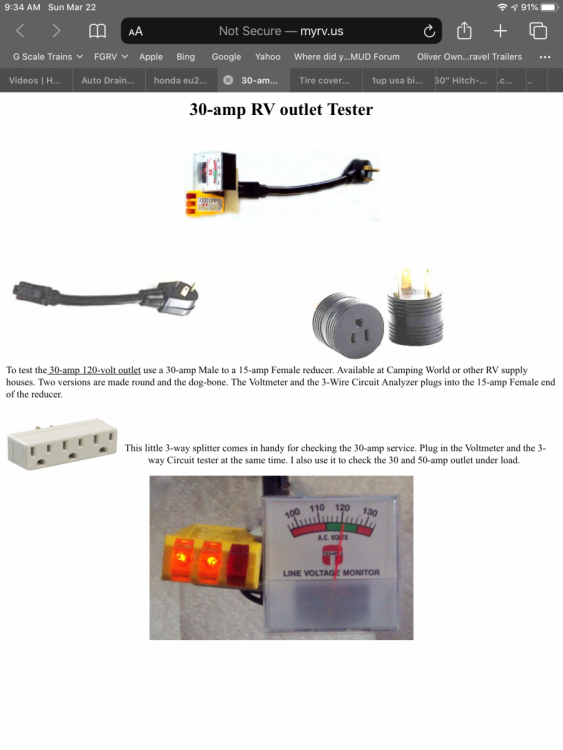

Adding to Mark's post of useful RV tools:
I found this picture that DavidS shared some time back of an electrical gauge and a GFCI tester as well as a 30 to 15 amp adapter.  I keep the electrical gauge plugged in under the curbside bed all of the time just as a reference for my AC power.  You can use it to test pedestal power or anything you plug your Ollie into or to testany of the outlets in the trailer.  I have the other tools Mark posted as well and like most handy people, I have used a radio or a 2 wire test light to confirm the presence of AC power, but that was before I could afford an Ollie.
Invest in the test equipment suitable for your needs and capabilities.  It my save your life.  And don’t forget about YouTube, it’s a great resource for information you don’t know or may have forgotten.

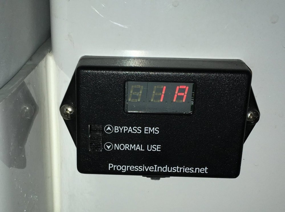

By the way, in the 3rd entry of this post, John E Davies shows a picture of the remote display of the Progressive Industries Surge Protector.  It may be located under the street side bed.  It will show the voltage coming into the trailer in the scrolling display.  John's picture shows the amp reading so keep watching and it will show the voltage reading so you’ll know what that value is.
