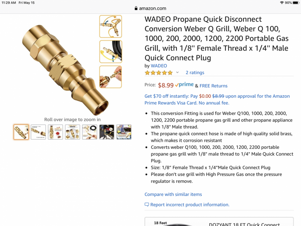

I just found this, per one review this is all I need for the conversion on the Q1200.

That fitting looks like what I used.  It screws on after you remove the regulator.  Here’s a picture of mine.

I actually bought that fitting for my Coleman Suitcase grill I have had for about 20 years.  It didn’t fit, so I bought the Blackstone 17" griddle that it does fit.  That’s putting the cart before the horse.  And now you know the rest of the story.
I do believe there are multiple regulator fitting sizes for 1 lb. gas bottles.  But of course I was trying to retrofit something I bought before Amazon.

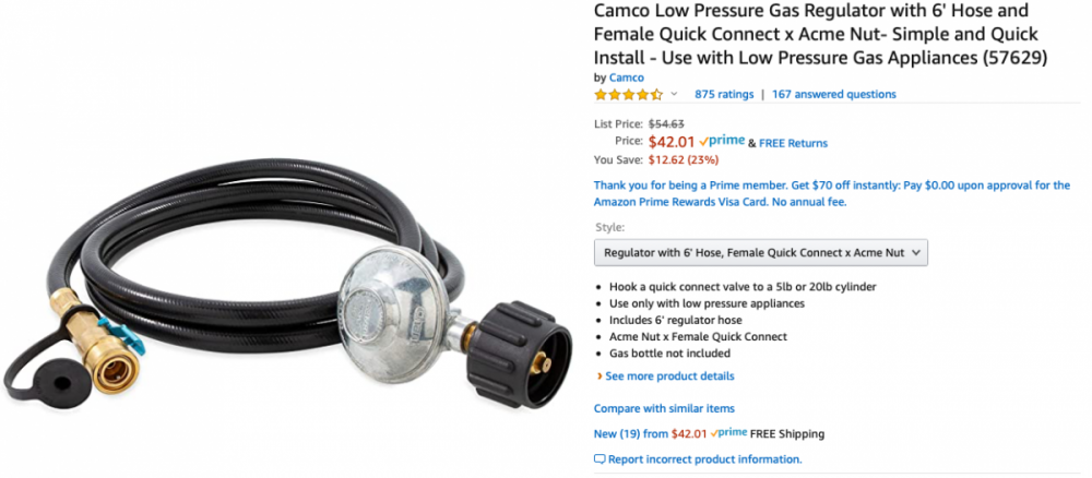

Chuck, I don't know what video you mean. I solved this by getting a hose with quick connect on one end and a regulator that connects to a 20 lb propane tank on the other end. This adapter is not designed for the small, disposable, propane bottles. I bought the adapter hose for $26, but it is currently listed for $42, so you might want to follow it on camelcamelcamel.
