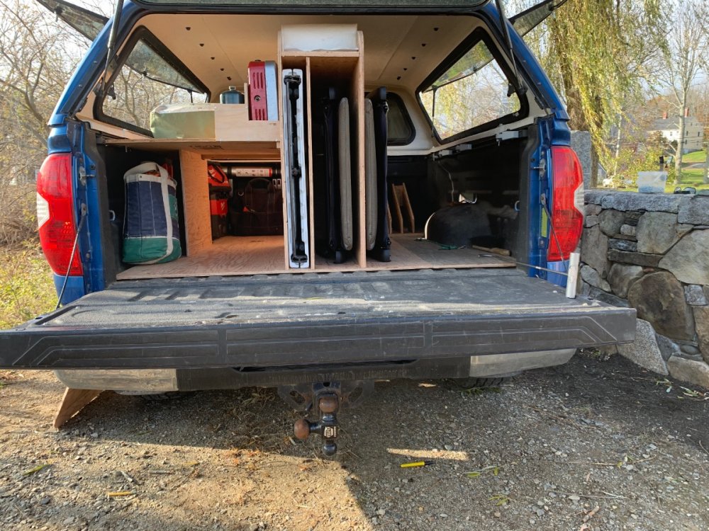

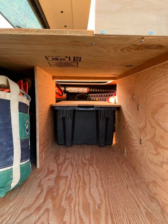

I know I know, this thread ended quite some time ago. But it was quite interesting to me, so I figured I’d add one more thing .
Our TV is a Tundra, Leer cap with the flip up side windows. Plenty of room for our gear in the past.. But we decided we wanted to lug a couple of bikes around, and working out a bike rack without the trailer in hand was unsuccessful.... so the bikes go into the back of the truck..
So I built a storage system into the back of the truck, with space for the bikes, and everything else. There are vertical slots for a folding table and 2 chairs. Street side has a deck 19.5” above the bed with storage for the camp stove and propane bottles, screen room, another chair etc on top. There is a hatch in it to access the area below, where the tools, telescoping ladder, shop vac, power tools, generator, etc get stowed. The generator is easily accessed through an opening next to the bikes. There is also a bait tray ( a plastic tub about 18”x 26” x 11” used to carry lobster bait) with a plywood top.. this gets filled with sea shells, fossils, shark teeth, rocks, pine cones and who all knows what else along the way. The top enables us to store things on top of it. All of this slides out easily to the tailgate with a boat hook. The big cooler slides under the deck behind it. The bikes, which were the cause of all this, back into the curbside of the bed standing up. You can see the plywood receivers I made for the back tires to help hold them upright, and they get strapped to the side of the bed.  I can get our water jugs and other stuff on that side as well.
I can have the whole contraption disassembled in about 15 minutes..
This is a prototypical project, we will give it a try this winter, redesign as needed next summer, rebuild it with more attractive material than CDX plywood and scrap lumber...
DB86208F-518D-4124-B908-66E309FDDB03.thumb.jpeg.efa34815300b41ec92d40b2af8fc2bf3.jpegBCC7A1C0-649E-4D35-A0A5-3D4B040880E9.thumb.jpeg.8aa841374a344f7b7a67c2a8d2b8fba1.jpeg12C32EAD-E5B3-4A6F-8BAE-2E15F682EC54.thumb.jpeg.4f3baae4553d413030aeab1b8ca35755.jpeg7F998A51-1C4E-4D60-BBC2-7EF22E273F33.thumb.jpeg.fbce40e3fc4bca0b6cba6fd9186dea69.jpeg

This is why good threads never die.
Great layout and a tremendous example of a customizable approach to storage.

You are amazing!!!  We don't don't have plans, as of yet, to put a cap on our pickup bed; hoping our 1up rack will work with a dual hitch adapter and we can have a tonneau cover.  Will know in a month or so (delivery December 7).  If the bike rack doesn't work out, a storage solution, such as yours would make a great Winter project!

Mcb,I don’t see two unmolested bikes fitting into that narrow slot. Do you rotate the handlebars so they face fore and aft? Remove the front wheels? Do you add foam padding and strap the frames to each other?
I also don’t understand how you can possibly get to the generator when all that stuff is loaded. It seems to me that a gennie has to be near the back, possibly on a slide so it can be run out onto the tailgate. I would very much like to see a few pictures please.

The front tires are removed, forks turned sideways. The bikes are beaters, so being lashed in fine.. not worried about scratches, just don’t want shifting gear in transit.
The generator is easily accessed with the bikes and one chair removed, which would most likely be the case if I need it anyway, as we’d have camp set up. I can crawl up in there and haul it out without issue. We plan on using the generator far less than we did with our Casita and it’s single group 27 battery.
I have the option to put the generator behind the cooler where it would be easy to rig up a way to slide it in and out and rework the stowing of other gear.
As I said, this winter will be a trial run for us on many levels.. next summer will be one full of design, modification, and tweaking of the truck and new camper.

Yes . . . . can you possibly post a picture of the bikes loaded.  Our pickup is a long bed, so perhaps the wheels won't need to be removed.
The long bed also poses the problem of how to reach cargo up by the cab.

Sure, it’ll be a few days. One advantage of removing the wheels is being able to turn the handlebars, which means the bikes are occupying a much narrower footprint.
