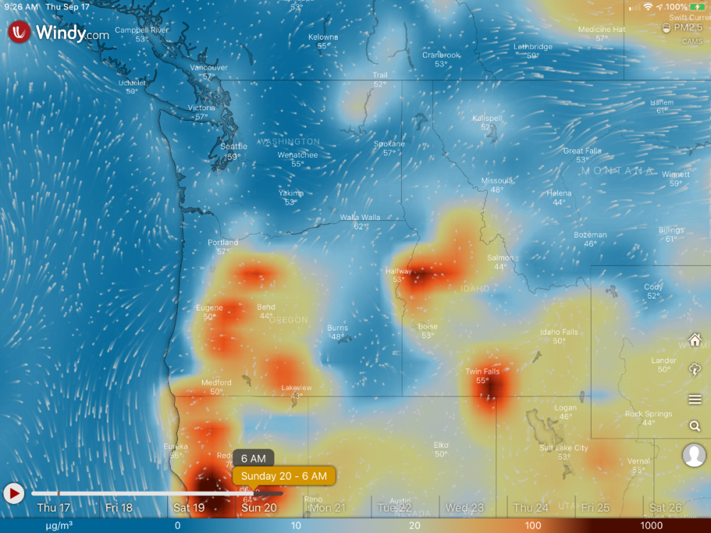

John E Davies Posted September 17, 2020 Posted September 17, 2020 (edited) Jason, the winds are finally shifting to westerly this weekend, you should head north if you can. You will be getting Oregon and NorCal smoke there near Stanley, but it will finally be clear for a while up in the Panhandle. Here is the Sunday morning smoke outlook. John Davies Spokane WA Edited September 17, 2020 by John E Davies SOLD 07/23 "Mouse": 2017 Legacy Elite II Two Beds, Hull Number 218, See my HOW TO threads: Tow Vehicle: 2013 Land Cruiser 200, 32” LT tires, airbags, Safari snorkel, Maggiolina Grand Tour 360 Carbon RTT.
Jim_Oker Posted September 17, 2020 Posted September 17, 2020 Let's hope that smoke forecast holds! The NWS Seattle office "forecast discussion" has a hedging bets sort of feel to it. I read a good discussion about the smoke forecast models written by one of the meteorology folks at UW - tl/dr is "the models are not super reliable at this point." It's at least a little bit encouraging to see some low sensor readings moving up along the coast and a teeny bit inland from there. It does seem like we have a few lows that will come through with more strength than anything we've seen since the smoke moved in, but of course the low that came through this past Monday was originally predicted to be of that nature too. Let's also hope we don't get too many dry-ish lightning strikes with this next round or two of weather... Jim and Yanna, Woodinville WA 2004 Ford E250 camper conversion Oliver Elite II hull #709

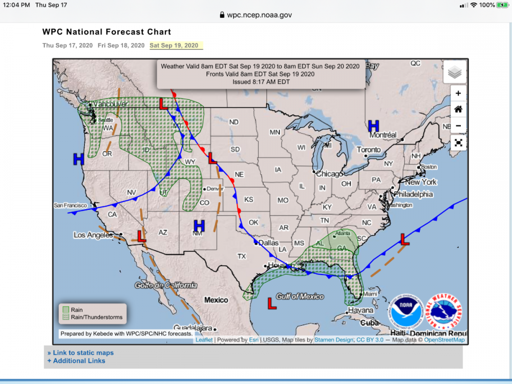

John E Davies Posted September 17, 2020 Posted September 17, 2020 Jim, I seem to have located another weather geek. Remember when forecasts showed frontal boundaries, highs and lows? Those disappeared for the most part because humans had to interpret the raw data, isobars, etc and hand draw the fronts. With computer forecasting that seems to have fallen by the wayside. Though one of my local stations has started to at least show the H and L markers again...., I like this Weather Predictive Center for its old school charts. Here is Sunday: John Davies Spokane WA SOLD 07/23 "Mouse": 2017 Legacy Elite II Two Beds, Hull Number 218, See my HOW TO threads: Tow Vehicle: 2013 Land Cruiser 200, 32” LT tires, airbags, Safari snorkel, Maggiolina Grand Tour 360 Carbon RTT.

Ray and Susan Huff Posted September 27, 2020 Posted September 27, 2020 On 9/17/2020 at 12:11 PM, John E Davies said: Jim, I seem to have located another weather geek. Remember when forecasts showed frontal boundaries, highs and lows? Those disappeared for the most part because humans had to interpret the raw data, isobars, etc and hand draw the fronts. With computer forecasting that seems to have fallen by the wayside. Though one of my local stations has started to at least show the H and L markers again...., I like this Weather Predictive Center for its old school charts. Here is Sunday: John Davies Spokane WA Yep! High pressure moving into the PNW is pushing out the rain. Warm weather on the way. Indian Summer (pardon me, if this term is not PC) Our local meteorologists show us the H/L pressure lines. We've had some really great weather reporters in the past, usually those who began before computer weather modeling became the norm, but the good ones seem to move on to more renown positions or they retire. What I don't like are the new generation of forecasters who talk so fast you can't keep up. I guess this is a sign of old age . . . . . I'm sounding like my mother Ray and Susan Huff Elite II Twin "Pearl" - Hull#699; delivered December 7, 2020 2013 F350 6.7l diesel Super Duty 4x4 long bed crew cab 1UP-USA Heavy-duty bike rack 2017 Leisure Travel Van Unity Twin Bed (sold)
