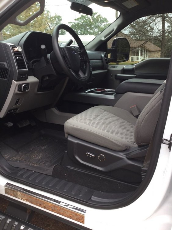

We are choosing to keep our dependable 2013 F-350 SD diesel 4wd crew cab long bed to tow our Elite II.  55K trouble free miles, but the interior was looking "used".  Installed these custom fitted seat covers from Cover King and detailed the interior.  Everyone says it looks like a new pickup!

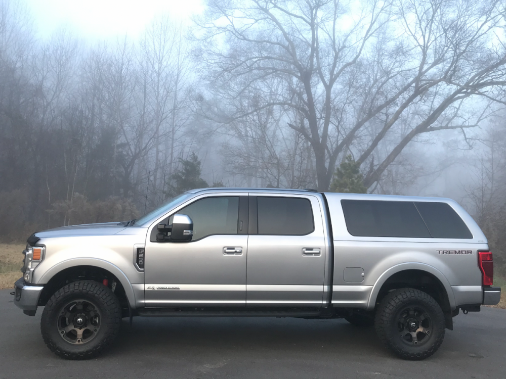

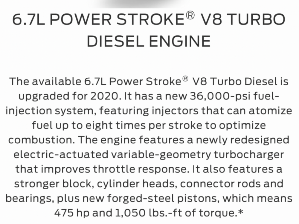

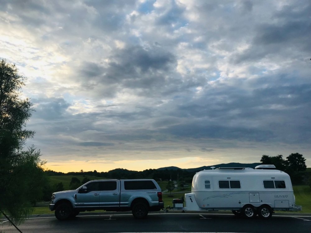

We recently opted to purchase a 3/4 ton 2020 F250 Lariat Ultimate with the “Tremor” package. We wanted more long distance travel comfort, better road sight distance when traveling and touring. This truck sits approx 4” higher than a stock F250, no weight distribution hitch, larger fuel tank, and all the hp and torque we could ever possibly need.
So a simple no to all questions you asked. We also have the tow haul pkg, trailer anti sway pkg and a bunch of other options. Mileage is around 20-21 highway when not towing. We are getting ready to take a trip towing the Ollie and will learn more about towing mileage.
As previously stated there are lots of options out there so enjoy being in the buyers seat! As long as you are happy in the end that is all that counts!  So far we really like the power, handling and most of all comfort level in this truck. Welcome to the forum!
