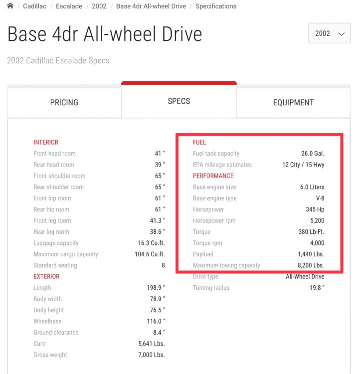

Moonlight Mile Posted October 20, 2020 Share Posted October 20, 2020 (edited) Getting the Elite 1 in Jan, tow vehicle would be a 2002 Escalade with a hitch thingy (tech talk! Ha!) on it. Manual says tows up to 7800. Dealer seems to be saying I should do the “upgrade” to an Anderson hitch? I think that’s what they’re saying The Escalade has 168k miles on it and I am now concerned and thinking even if it CAN pull the Elite 1, should I add the option for the Anderson hitch to my build? OR, should I shop CarMax and find a Ram 1500 or Ford F 150 (used, say, 2017 models and upward, with “tow package”)? Lowest miles possible etc. Etc Really don’t know what to do and the more I read with all the ways people tow, Anderson v not, Ram or Ford and which one etc. more confused I get! i want to have a good SAFE setup. If I can NOT break the bank but have that too, I am game. thanks all Edited November 13, 2020 by SeaDawg 2021 Elite 1 -- Hull #731 Ram 1500 Rebel 4x4 Now Sold Link to comment Share on other sites More sharing options...
John E Davies Posted October 20, 2020 Share Posted October 20, 2020 (edited) Chill out, your Escalade will be 95% fine for an Elite, I would not even use the Andersen for this setup. Just make sure your truck is in good mechanical condition, all fluids fresh; brakes, tires and shock absorbers in good shape, and go for it. It won’t have the many safety and towing features of a new truck. Just try it out for a season, that will give you the basic towing education, and you can decide if you want to trade it in on a newer tow vehicle. You will need a brake control unit, plus a GM adapter wiring harness, I suggest the Tekonsha Prodigy P3. Other than that it should be fine as is, assuming it is in very good shape. With the Andersen you could safely tow an Elite II, so the smaller trailer should be a piece of cake for this truck. OTH if it is not in good shape AND if it is not economically practical to make it so, trade it in and get something a few years old. It is up to you to decide if you are ready to spend a lot to fix it up. On a nearly twenty year old vehicle, that is a big factor. So, if it is a beater, get rid of it, if it is a gem, keep it. If you don’t know, take it to a good independent shop and ask them to perform a full safety inspection, which will give you a list of all the good and bad things. John Davies Spokane WA Edited October 20, 2020 by John E Davies 1 1 SOLD 07/23 "Mouse": 2017 Legacy Elite II Two Beds, Hull Number 218, See my HOW TO threads: Tow Vehicle: 2013 Land Cruiser 200, 32” LT tires, airbags, Safari snorkel, Maggiolina Grand Tour 360 Carbon RTT. Link to comment Share on other sites More sharing options...
Overland Posted October 20, 2020 Share Posted October 20, 2020 19 minutes ago, John E Davies said: I would not even use the Andersen for this setup I'd refer to the owner's manual. That, or there should be a sticker on the Escalade's hitch somewhere (often the bottom) that lists the maximum tongue weight. If it says 500lbs without weight distribution, then you should use the Andersen. 1 1 Link to comment Share on other sites More sharing options...
Ray and Susan Huff Posted October 20, 2020 Share Posted October 20, 2020 (edited) 6 minutes ago, Overland said: I'd refer to the owner's manual. That, or there should be a sticker on the Escalade's hitch somewhere (often the bottom) that lists the maximum tongue weight. If it says 500lbs without weight distribution, then you should use the Andersen. There are many factors to consider for the Escalade besides tow capacity: payload capacity (cargo you may plan to carry in it); transmission suitability for towing; overall construction (is the Escalade built on a pickup chassis or passenger car?) You might look at some GM forums and see what others have to say about towing with the Excalade. Edited October 20, 2020 by Susan Huff 1 Ray and Susan Huff Elite II Twin "Pearl" - Hull#699; delivered December 7, 2020 2013 F350 6.7l diesel Super Duty 4x4 long bed crew cab 1UP-USA Heavy-duty bike rack 2017 Leisure Travel Van Unity Twin Bed (sold) Link to comment Share on other sites More sharing options...

Moderators SeaDawg Posted October 21, 2020 Moderators Share Posted October 21, 2020 (edited) We've never used an Anderson on our tow vehicles. 2004 Volvo xc90, 2008 ram 1500, 2005 1500 Silverado. The Elite is lighter and smaller than the II. More choices in tow vehicles . I suspect your big Escalade (same platform as Hummer?) would be fine. But, if you want a truck, find a 1500 that feels good when you drive it. If you're going to be changing up anyway, I'd recommend 4x4. You definitely do not need a 3/4 ton truck to comfortably tow an Elite I. There are many suvs that would also work. Edited October 21, 2020 by SeaDawg 1 2 2008 Ram 1500 4 × 4 2008 Oliver Elite, Hull #12 Florida and Western North Carolina, or wherever the truck goes.... 400 watts solar. DC compressor fridge. No inverter. 2 x 105 ah agm batteries . Life is good. Link to comment Share on other sites More sharing options...

Overland Posted October 21, 2020 Share Posted October 21, 2020 My bad, I read over the part where you said Elite 1. I agree with the others, you’re definitely ok without the Andersen. 2 Link to comment Share on other sites More sharing options...
Moderator+ ScubaRx Posted October 22, 2020 Moderator+ Share Posted October 22, 2020 We pulled our former Oliver Elite Hull # 026 with a 2007 Tahoe LTZ V8. No Andersen Hitch (don't think it was even on the market back then) and never needed it. We had that combo for 5 years from 2008-2013, never a problem. Then we got an Elite II, much heavier and we pull it with a 2017 2500HD Diesel. A new Elite will weigh around 4000 pounds loaded and ready to travel. Bottom line, your Escalade should do a fine job with an Elite. I would feel comfortable towing with it. 1 Steve, Tali and our dog Rocky plus our beloved Storm, Maggie, Lucy and Reacher (all waiting at the Rainbow Bridge) 2008 Legacy Elite I - Outlaw Oliver, Hull #026 | 2014 Legacy Elite II - Outlaw Oliver, Hull #050 | 2022 Silverado High Country 3500HD SRW Diesel 4x4 Link to comment Share on other sites More sharing options...

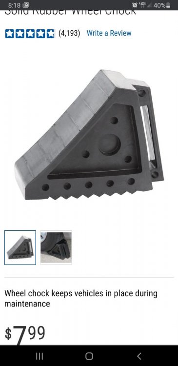

Moderators SeaDawg Posted October 23, 2020 Moderators Share Posted October 23, 2020 Make sure you buy good chocks. Those won't come with your trailer. 4 x harbor freight chocks, with coupon, probably 22 bucks. 1 2008 Ram 1500 4 × 4 2008 Oliver Elite, Hull #12 Florida and Western North Carolina, or wherever the truck goes.... 400 watts solar. DC compressor fridge. No inverter. 2 x 105 ah agm batteries . Life is good. Link to comment Share on other sites More sharing options...
Moderators SeaDawg Posted October 23, 2020 Moderators Share Posted October 23, 2020 Harbor freight often has these on sale for 5.99. With a 20 per cent off coupon, even better. Best chocks around. For the price. 1 2008 Ram 1500 4 × 4 2008 Oliver Elite, Hull #12 Florida and Western North Carolina, or wherever the truck goes.... 400 watts solar. DC compressor fridge. No inverter. 2 x 105 ah agm batteries . Life is good. Link to comment Share on other sites More sharing options...
Moonlight Mile Posted October 23, 2020 Author Share Posted October 23, 2020 (edited) 6 minutes ago, SeaDawg said: Make sure you buy good chocks. Those won't come with your trailer. 4 x harbor freight chocks, with coupon, probably 22 bucks. Thank you! Yet another thing I did NOT know I needed to buy in advance of delivery. I know this is off-topic for this thread, but while I'm here, I was gonna get a generator and it sounds like people store them in the basket (Elite I addon I am getting), is that correct? I can't see leaving a generator in a basket unsecured (and by secure I mean both "not moving while underway" AND "not being subject to easy THEFT." I can search for this around the forums too, but I think I need the exact dimensions of the "basket" for the ELITE 1, first, before buying any generator (not that I have a clue what KIND to get). Heh. Edited October 23, 2020 by SherMica 2021 Elite 1 -- Hull #731 Ram 1500 Rebel 4x4 Now Sold Link to comment Share on other sites More sharing options...
