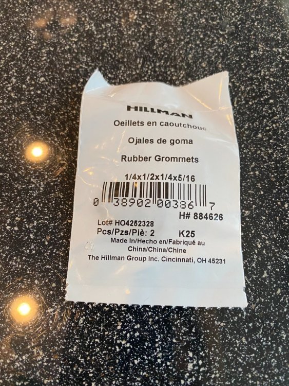

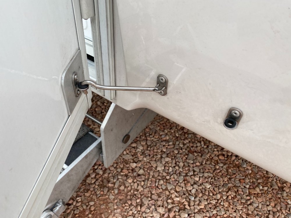

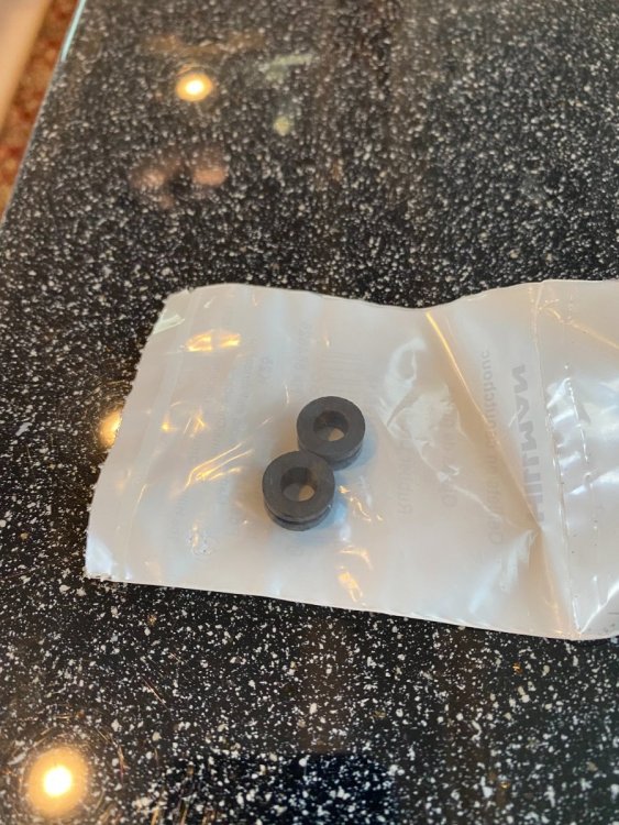

As delivered from the Oliver factory, we had rubber grommets on both door hook receivers to provide a snug fit for the hook and also provide a bit of cushioning, rattle reduction when hooked.
Mike & Carol:
As you see, the grommets are shaped like a rubber donut with a slit all the way around the outside.
They are specified by size which includes:  (more than anyone want's to know.)
  • Full Outer Diameter - This will be slightly smaller than the stainless steel mounting plates
  • Inner Hole Diameter - This is the ~ the same diameter as the latch pin
  • Grommet Thickness - (they come in square shoulder or round shoulder) thicker are harder to put on..
  • Slit thickness - this is ~ the thickness the stainless mounting bracket.
  • Slit depth - it ends up being about 1/2 the difference between the outer and inner grommet hole sizes.
When inserting the grommets squeeze them together a bit and force  one side into the slit and wiggle.
A little soap on the outside helps the slip on.
I ended up buying 2 each of few different sizes and one of them fit perfectly....

Perhaps "we" are beating this to death - but - note that (at least on mine) the thickness of the metal on the door hanger is different from that on the hull.  Thus, it requires two different sizes of grommets.  I wish that these grommets were made with a material that lasted a bit longer.  But, if they did then I wouldn't know how to get them inserted in the metal hanger holes.
It appears as though this door hook changed around 2018. Mine and the hook shown in the picture above provided by FrankC are stainless. See Seachoice Products #36181.
