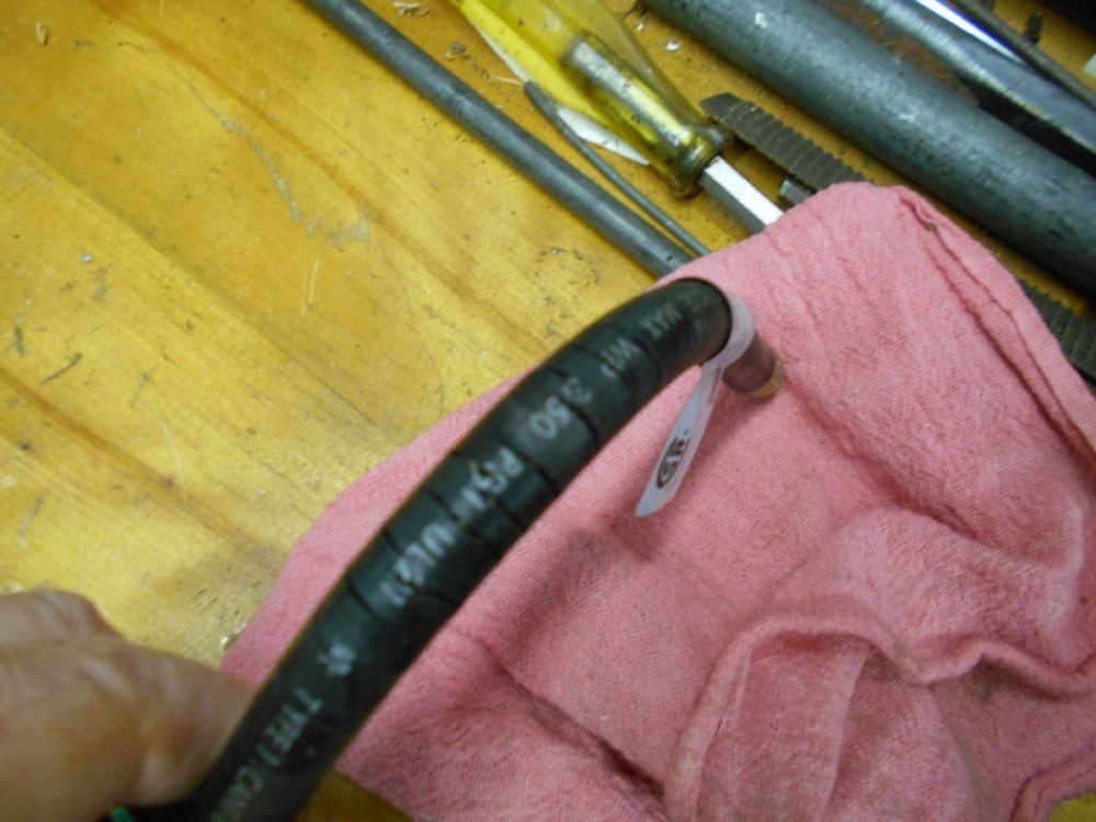

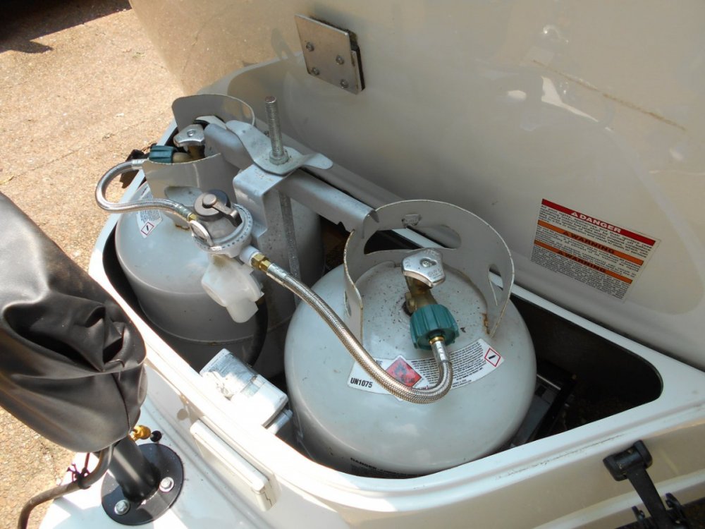

This should be a close enough topic:  Has any Oliver owner had to replace the (2) high pressure propane hoses yet?
Whilst camping this week, I opened the propane tank valve and heard a hiss coming out of the 4 year old hose on the primary side (right tank). I promptly closed it and proceeded to shift over to the left tank and did not hear anything and got the green indicator for a full tank. It Seemed OK and went on a recovered the tanks with the fiberglass lid.
Later, My wife, who has an acute sense of smell, caught the non mistakable odor of propane. Immediately closed the left tank and examined both hoses and they were severely cracked and obviously leaking. We did then enjoy camping sans propane via campfire.
Now I am looking at the etrailer website for appropriate hoses and wondering if anyone else has experienced this and is there a better replacement?

I’d be interested in any recommendations for replacement hoses, too.  Ours are over 5 years old, looked okay when we started this trip but will go check them as soon as the rain stops!  Mike
I just reinstalled a bottle and checked my hoses, one is leaking at the crimp. They are going on five years old and are rock hard. This is the part, shipping is expensive.
https://www.amazon.com/dp/B00PM95NEM/?coliid=I20IDOXDDJULOK&colid=1X5H11EH41351&psc=1&ref_=lv_ov_lig_dp_it
I found an eBay source and ordered two for $40 delivered. I would not buy a steel braided one for a couple of reasons. You cannot inspect the rubber to see if it is deteriorating, and no name brands are more likely to fail, with poor quality construction and materials. There is no reason to buy a steel braided hose unless it is to reduce chafing.
I also ordered a couple of brass 1/4” pipe thread “street elbows”, I am going to install them between the regulator body and the small internal check valve fitting that the hose connects to, to give a better angle at that connection. The OEM setup puts a severe strain on the hose because it has to twist sharply.

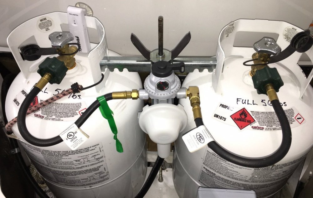

Edit, still waiting on new hoses, but I went ahead and installed the 90 degree elbows. Here is a shot showing the OEM setup and the modified setup. The latter lets the hose lie naturally without that horrible tight reverse bend. It also gives a little extra clearance for removing the  bottle.
I just finished replacing those (2) high pressure hoses using those recommended by etrailer per my previous post. They seem to be much more robust and hopefully more immune to the elements.
The OEM hoses were severely cracked as seen in the rather poor photo below. The next photo shows the replacement hoses. One tip should you need to replace these is to use PTFE type thread sealer (like OATEY'S) on the pipe threads.
