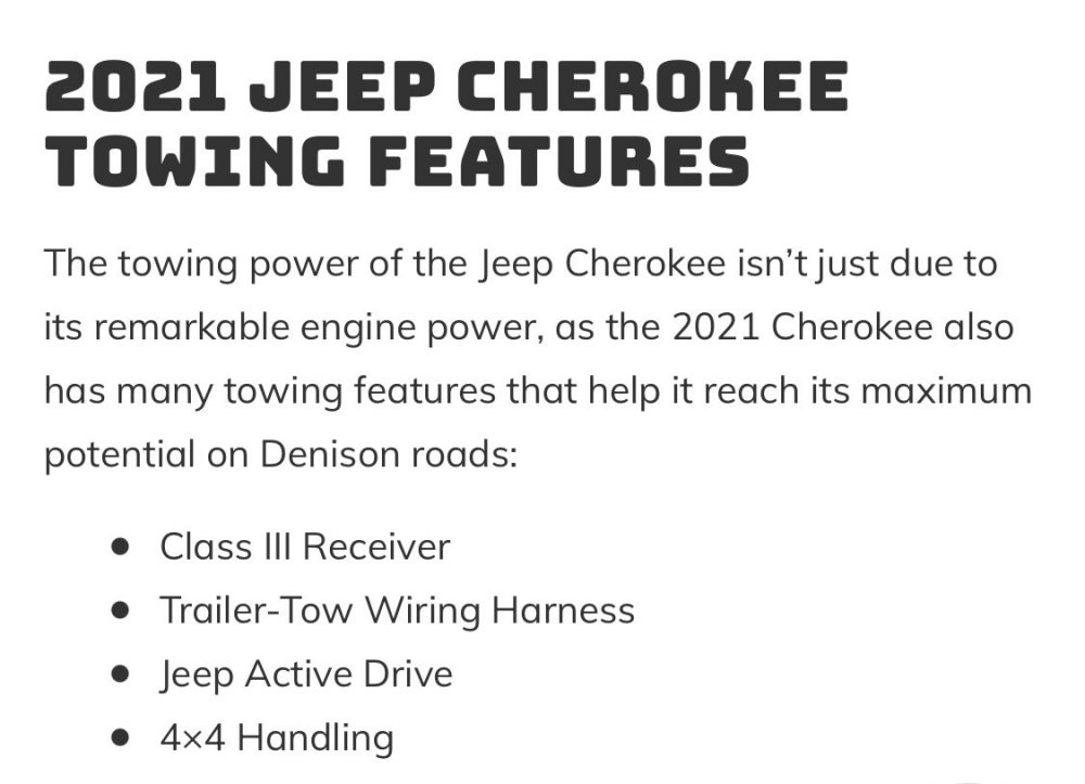

I don’t want to sound harsh but I’ve owned two Jeep Cherokees, a 2014 and a 2019 (both with the V-6 engine), and while they are great little SUVs, I think they would be terrible tow vehicles, even for the smaller Elite I.  The payload capacity is really limited, there isn’t much room for carrying the typical camping gear, and the towing specs are marginal for an Elite I with any options or water in the tanks, food in the fridge and pantry, etc.  And does yours have the optional Jeep trailer tow package with the necessary 7 pin electrical trailer connector port near the back bumper, and the 2” receiver for towing?   If it doesn’t have the towing wire harness with connector already installed, that makes it really expensive and complicated to install a trailer brake controller.
@bhncb, I'd love to see a published equation for figuring frontal area. It's a really good point, but not exactly sure how to figure it with the rounded shorter (and trolley roof)  front of an Elite. Our is a little over 6' at the front, (not counting tires height) and 6'6" at the bellybutton,  but narrows top and bottom. The accessories on top surely increase drag, but if I were so inclined to reach back to high school math, and did proper measurements,  I'd probably be close to the 40 sf limit. Maybe out, maybe in. The back, of course, is far more squared off.
@FrankC, your experience with two cherokees is important.  Did you tow anything with them?
We have a friend in NY state with a lesser capable Cherokee model than the Trailhawk. He tows a big 4x4 utv, a lot. Traded up from a 2up to a heavier side by side, recently,  and is buying an aluminum trailer vs steel, to stay within the limits.
