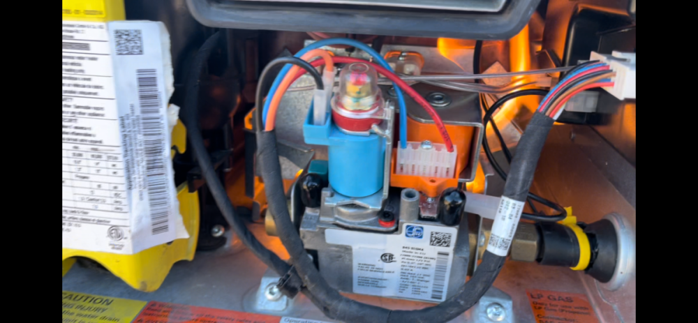

Our hull 505 in service Aug 2019 has a major Truma burner fail at 29 months. (2 yr wty)
The burner box no longer contains flames on startup and we smelled burning plastic before we shut it down.
Pix from video shows symptom of flames engulfing wiring and controls.
We will try to get a whole new unit for install and send dead one back to Truma for analysis.  I’ll be asking Truma for some adjustment to warranty.
we are lucky this happens while daylight and I could take action immediately.Any one else had the same promlem?  Is it a design flaw?  Doesn’t seem like an Aging type of failure.

I can't get your videos to load but the photo looks pretty scary.  Glad you noticed quickly and got it shut off.  Did just turning off the unit close the valve or did you have to turn off the gas?  It would have been reassuring if the unit had detected the problem and shut itself down on it's own.  Maybe with a little more time it would have?  It does look like the flame was contained within the box so that's something I suppose.

This has happened a few times, the burner supports break and drop down causing the flames to direct outside the burner box enclosure.
we smelled plastic and flipped off the outside switch on the unit which shut down the gas supply and the flames stopped.
I now notice the door fins are warped from the heat.

On our Hull 505 -Elite II the Truma water heater failed with fire coming outside the box and starting to melt wiring etc.  (Pix attached)
Symptoms:
When the Truma was igniting we heard unusually loud huffing noises followed by a loud whoosh.  Every so often there would be a loud whoosh and a pop. (Blowing itself out.)
On one incident I went outside, opened the door and saw flames outside the burner assembly engulfing controls.  I turned off unit and flames stopped.
Cause?
It appears the burner and the copper flue box may have  gotten out of alignment after 13k miles on chassis.
Given the plastic smell I decided to replace the whole unit.

After removal and visual check I couldn’t see any obvious defects in the old unit, other than the lower edges of the copper burner box were slightly folded inward. Maybe  Truma can see something when they tear into the unit.
