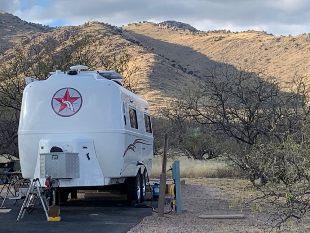

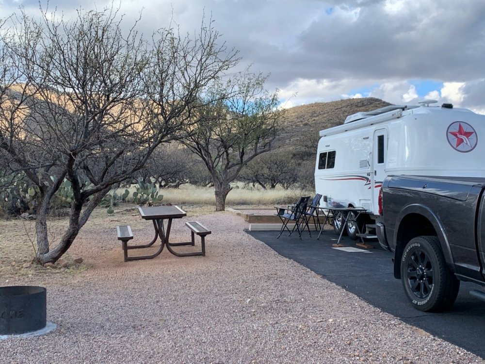

We camped in Kartchner Caverns a couple of weeks ago.  Enjoy Cochise County (Tombstone, Bisbee, Sierra Vista).  We lived there for many years.
Our site last month at Kartchner Caverns…
