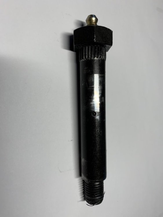

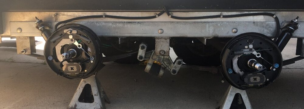

Fargoman Posted February 13, 2022 Author Share Posted February 13, 2022 I couldn't un-stick the zerk that wasn't accepting grease, and decided to replace it. When I removed the curb-side rear wheel to make it easier to get a ratcheting socket on the zerk, I discovered that there are 14 zerk grease fittings, not 12 as mentioned in my original post. With both wheels on I hadn't noticed the 'hidden' zerk on the bolt that attaches the E-Z Flex system to the subframe. I had assumed that bolt would have had a zerk in the bolt head like the bolts that attach the leaf springs to the E-Z Flex, like in John Davies photo above. I mention this with the hope that some other new owner realizes that there are two zerks that are not readily visible without removing a rear wheel or crawling under the trailer. 1 2021 Legacy Elite 2 Twin Bed | Hull Number 894 (9/16/21 delivery) | Ram 1500 Longhorn 4x4 3.0L EcoDiesel 3.92 axle Link to comment Share on other sites More sharing options...
Frank C Posted February 13, 2022 Share Posted February 13, 2022 38 minutes ago, Fargoman said: I couldn't un-stick the zerk that wasn't accepting grease, and decided to replace it. When I removed the curb-side rear wheel to make it easier to get a ratcheting socket on the zerk, I discovered that there are 14 zerk grease fittings, not 12 as mentioned in my original post. With both wheels on I hadn't noticed the 'hidden' zerk on the bolt that attaches the E-Z Flex system to the subframe. I had assumed that bolt would have had a zerk in the bolt head like the bolts that attach the leaf springs to the E-Z Flex, like in John Davies photo above. I mention this with the hope that some other new owner realizes that there are two zerks that are not readily visible without removing a rear wheel or crawling under the trailer. There are actually 16 zerk fittings in total. There are FOUR hidden ones (2 on each side of the trailer) on the EZ flex links where the links are attached to the subframe bolts, one facing forwards and one facing backwards on each side of the trailer. You found two of them. See photo. I always crawl under the trailer to get to those 4. Sorry about the bad photo, really hard to get the phone in there for a picture. The photo shows the forward facing zerk on the link on the right in the photo. There is rearward facing zerk on the other link on the left in the photo. 5 Link to comment Share on other sites More sharing options...
Fargoman Posted February 14, 2022 Author Share Posted February 14, 2022 Thanks for pointing that out Frank. In retrospect, knowing that there are two E-Z Flex links per side I should have looked further. I had seen an earlier post about zerk fittings that mentioned a total of 14 and figured that "Hey, I found the two hidden ones!" 1 2021 Legacy Elite 2 Twin Bed | Hull Number 894 (9/16/21 delivery) | Ram 1500 Longhorn 4x4 3.0L EcoDiesel 3.92 axle Link to comment Share on other sites More sharing options...

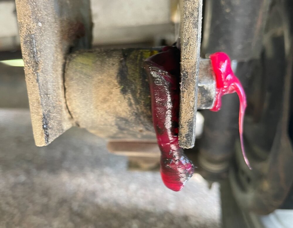

Fargoman Posted February 19, 2022 Author Share Posted February 19, 2022 The replacement zerk fitting did not solve the problem of the wet bolt accepting grease, so I submitted a ticket to Oliver. Jason responded quickly, saying that they would send a replacement bolt, and that I could replace the bolt myself, or have a local service facility do the work and submit a reimbursement claim to Dexter. Coincidentaly, two days earlier a friend had highly recommended a local family-owned RV service facility, so I opted to have them perform the work. When I went there to schedule the repair, they told me to bring the trailer by that afternoon so they could determine if the bolt was truly faulty, or just needed a more powerful grease gun than the mini-grease gun I use. The bolt was indeed faulty, and they had a replacement in stock (the one from Oliver had not yet arrived), so they set about replacing the bolt. It took close to an hour, but they only charged for half an hour of labor (work stopped for a while as everyone in the shop had to come inspect and drool over my exotic fiberglass trailer. A happy ending to a small, but nagging problem, and I now have a trusted local repair facility to turn to when things get above my pay grade. Attached is a photo of the offending bolt. I'm not sure if the wear is normal after only 3500 miles or indicative of a lack of sufficient grease. 9 2021 Legacy Elite 2 Twin Bed | Hull Number 894 (9/16/21 delivery) | Ram 1500 Longhorn 4x4 3.0L EcoDiesel 3.92 axle Link to comment Share on other sites More sharing options...
Wolfepack Posted June 4, 2022 Share Posted June 4, 2022 Getting set to do my first lube of the zerks and found this from Oliver. It does show the placement of the 16 zerk fittings (8 per side). Pretty helpful for a newbie like myself: https://support.olivertraveltrailers.com/portal/en/kb/articles/dexter-ez-flex-overview-maintenance Is there a favorite grease? From what I've read elsewhere it seems Dexter recommends a lithium complex red grease, but I haven't seen that directly in the Dexter manual. Patrick and Danielle Wolfe / 2022 LE II Tail #22-1052 / 2023 GMC 2500HD SLT 6.6L Gas Link to comment Share on other sites More sharing options...
John E Davies Posted June 4, 2022 Share Posted June 4, 2022 1 hour ago, Wolfepack said: Is there a favorite grease? From what I've read elsewhere it seems Dexter recommends a lithium complex red grease, but I haven't seen that directly in the Dexter manual. You can use any decent chassis grease, but IMHO the very best is Redline CV-2, for suspension zerks as well as wheel bearings and jack gearboxes. John Davies Spokane WA. 3 SOLD 07/23 "Mouse": 2017 Legacy Elite II Two Beds, Hull Number 218, See my HOW TO threads: Tow Vehicle: 2013 Land Cruiser 200, 32” LT tires, airbags, Safari snorkel, Maggiolina Grand Tour 360 Carbon RTT. Link to comment Share on other sites More sharing options...
