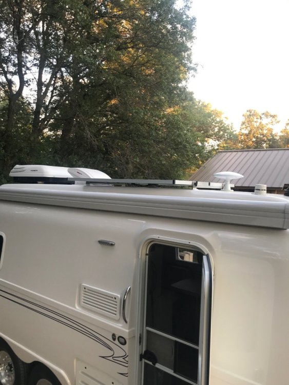

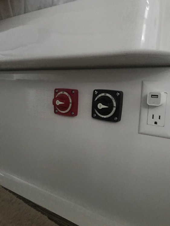

I am actually on day 3 of a 2 week shake down test of my recent self install of: 2-Zamp 170w panels, a Zamp 3 port roof box, Victron 100-30 solar charger, 2 - 100ah SOK lithium batteries, a blue sky cutoff switch for the solar panels as well as the appropriate circuit breaker and the proper sized cables and lugs.
I had previously installed a blue sky battery cut off and a Victron 712. My 2019 has the PD4060 with the lithium jumper.
Our camping style doesn’t call for an inverter and I want a less complicated system. I did all of the work myself and have probably $3k total in it, including the harbor freight lug crimper tool and wire locator.
I learned a lot and the project was fun. I totally relied on AndrewK’s instructions and lots of advice / encouragement from Andrew as well as ScubaRX and Mike Mossy.  These guys are the best!!
I have kept the PD charger circuit breaker switched off when we plug in and batteries are quickly getting back to 100% by midday from the panels.
  I’ll give further thoughts as I get more familiar using the system.
The Install took probably 2 full days by my self but knowing what I know now, to do it again I could pull it off in 10-12 hours. Probably less with some help.
So far I really am impressed
A38C4E73-8D11-404E-ADCA-2AC2DC74B031.thumb.jpeg.27155d92c7a922c47c2f82f74a2911ed.jpegF203202C-FB75-4CBA-869B-1DFEC4AA0467.thumb.jpeg.98334456eb26eb3646059cdb025911a5.jpeg
@carnivore, your install looks great! Did Oliver install the backing plates in the roof during manufacture?

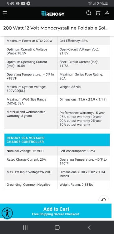

I think the renogy 200 watt suitcase system weighs in quite a bit less than zamp, under 40 pounds.
I agree. Unless you build your own, with flexible panels, these aren't flyweight. But, I can manage 40 pounds, on my own.
I will add that my 100w Renogy suitcase with charge controller and an extra 20’ 10A  cable weighs in at 31 pounds.
Not light, for sure. From renogys website, 36 pounds for 200 watt suitcase. (But less than zamp legacy)
I wonder if that includes the cable?

Seadawg,  yes, the backing plates were part of the standard construction, at least on our 2019.
Thanks. I understood that at some point, solar became so popular that backing plates were in every trailer.
In 2008, ours were a tough retrofit.
Keep us posted on your system. It looks so very professionally done.

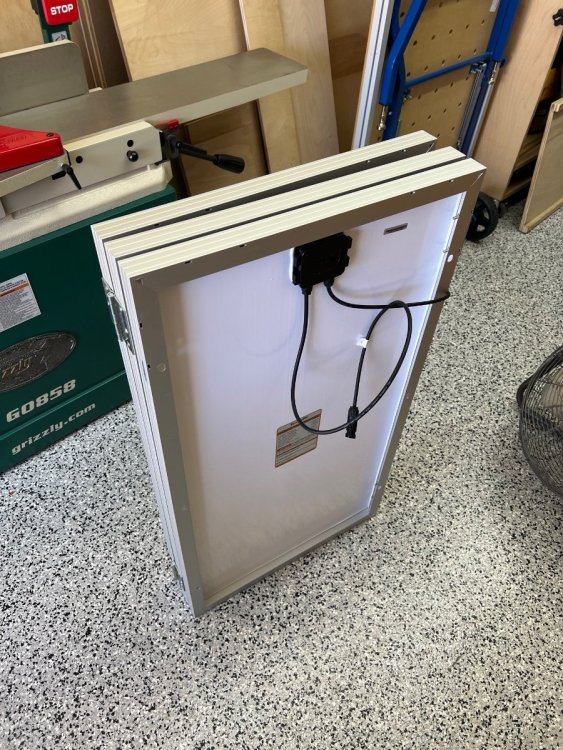

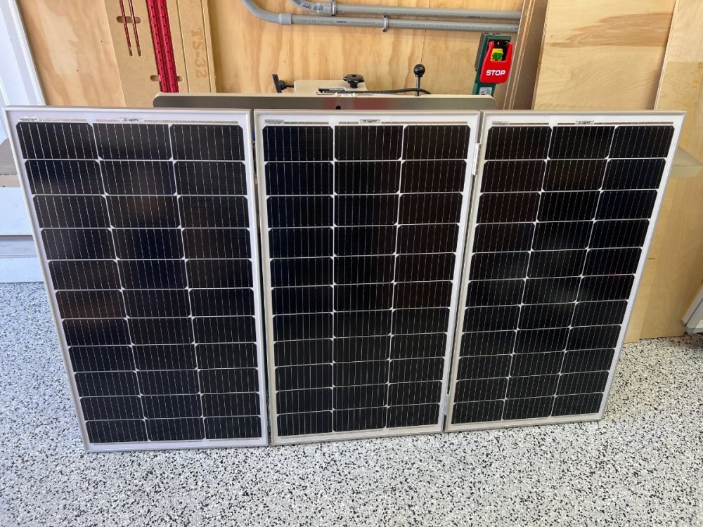

This trifold panel setup I made weighs about 45 lbs.  300 watts for around $305.  I added a victron 100/50 that connects to the zamp port for easy deployment. The panels are Bougerv.
John
