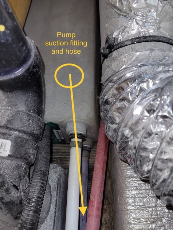

Does you trailer have the fresh tank modification that allows almost all the water to be drawn out (I can’t remember what it’s called - just on my first cup of coffee!).  I don’t know when the factory started doing that, we had ours done by service later but some owners did it themselves.
That's a good thought, Mike. Hull 179 would certainly be in the group of trailers before the factory started the pickup tube mod. She won't be able to see a leak if there's no water in the line...  @Margaret, you might make a quick call to the previous owners and find out if they ever had the pickup tube mod done at the factory.
No need to call, it takes a few seconds to look and see. The older trailers have two lines coming out of the rear (vertical) end of the tank. The pickup tube mod added a third suction line at the TOP corner. Without that mod the tank only supplies 2/3 of its rated capacity, meaning 10 gallons is unusable - the pump sucks air. If the tank is full or the tongue is raised, it should work fine otherwise…

Oliver corrected our 12V pump fresh water tank pickup tube for free during a plant visit a few years ago. They also fixed the 12V ground to frame issue for free during that visit.
Here is a picture of the older design, no top pickup tube. Yellow shows where the new fitting and line are located.
