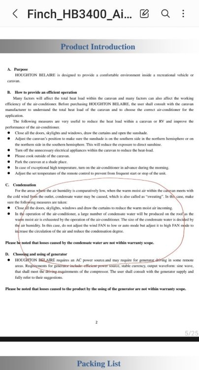

Interestingly enough, in the Houghton 3400 (13.5 btu) manual I found online, houghton suggest running the fan on high instead of low or auto in low humidity...

We don't have auto low, but we do have a dehumidifier mode on our 9500, which I tried in the sideyard one day. It seemed to work, but I have no data to bCk it up other than seeing some condensate drip off the roof...

This actually talks about sweating in a low humidity environment, not high.
2010 Elite II Hull #45, the first LE2 sold.  2020 Toyota Tundra TRD Off Road 4WD 5.7 with 38 gallon tank, 4.30 axle and tow package.
Oops. Thanks for the catch. See what I get for speed reading with too little caffeine...
I fixed my post. I think I now understand why the folks in the video might have run theirs on high... when it made no sense to me...

Their humidity problem is undoubtedly being caused by either the unit being oversized (my guess) or they aren't running it in dehumidifying mode or low speed fan setting (if that unit has such features) while operating in humid conditions.
