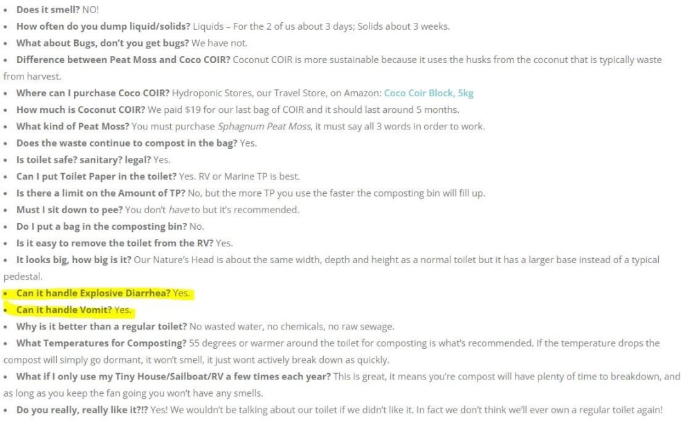

PAndrews Posted October 21, 2022 Posted October 21, 2022 The attached clip is from a customer's online review of the Nature's Head compositing toilet. They claim that it handles explosive diarrhea and even vomit with no problem. I've also included a link to the website I got the list of FAQs from... https://www.gonewiththewynns.com/compost-toilet-big-questions 1 Phillip Andrews Oliver Travel Trailers Sales and Delivery Specialist

Steph and Dud B Posted October 21, 2022 Posted October 21, 2022 7 hours ago, PAndrews said: They claim that it handles explosive diarrhea and even vomit with no problem. No doubt it can. As an isolated incident. Not so sure if it's a daily occurrence. Again, not something the average person would have to worry about. But, if there's another camper in a similar situation it's something to consider. Stephanie and Dudley from CT. 2022 LE2, Hull #1150: Eggcelsior. Tow vehicle: 2016 GMC Sierra 6.0 gas dually 4x4. Our Oliver journey: Steph and Dud B's RV Screed Where we've been RVing since 1999:
