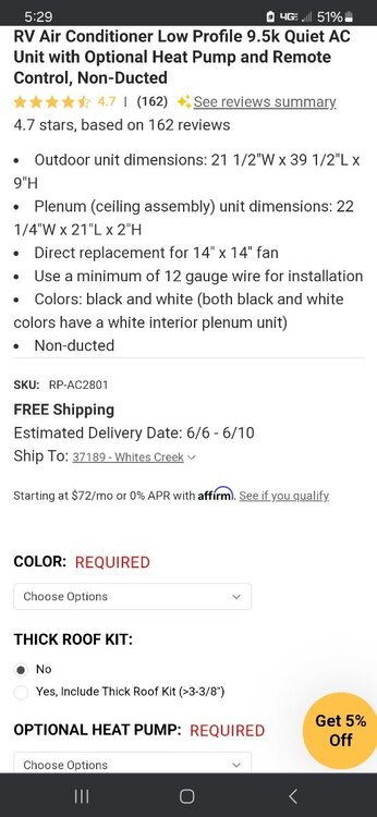

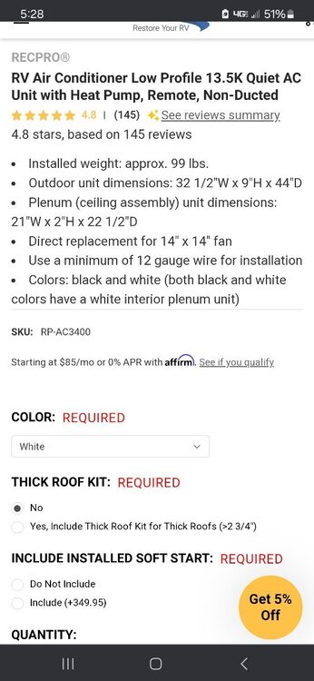

COST:  Here are the RecPro graphics for the 48V and 12V models:
Conclusion:  Why pay $950 more for a 48V for the same capacity?

Agreed @Geronimo John, as always you provide a solid engineering basis. It was a late night find, looked cool at the time! First thing I thought this morning is at a campsite, the 48V DC version is not a simple plug into shore power.
Which model did you install? Do you believe the 9.5k unit is adequate cooling for the Oliver? I'm thinking so, we do not plan on extended summer camping in the east. At 1590W it appears it can run off our 2KW inverter, agree?
I realize on my current 450AH lead-acid batteries it would not run for long, but later adding 600AH Epoch LI should do the trick. RV Air Conditioner Low Profile 9.5k Quiet AC Unit with Optional Heat Pump and Remote Control, Non-Ducted - RecPro

@Geronimo John so I’m thinking to change my mind to the 13,5K model. Went on RecPro to see it’s not only more expensive but + $350 for the easy start option. Yikes! Is it the 9.5K unit doesn’t need it? Also the 9.5K showed heat pump option, not sure if I care about that. The 13.5K model did not show the option, so it must be standard. Came to $1700 total, free ship plus tax and through 6/3 store wide 10% OFF. I’ll likely wait for the next sale, since I’m not sure and not traveling soon. Thanks
Been reading older Houghton threads here. It seems several have stated the soft start is not required, even off inverter to small generator, please comment. That would be a good save at $350!
Also, what is the Oliver roof thickness at the AC opening? I have not read this being discussed. An option for the "thick roof kit" for >2 3/4". Likely it's less since this has not been mentioned. Thanks

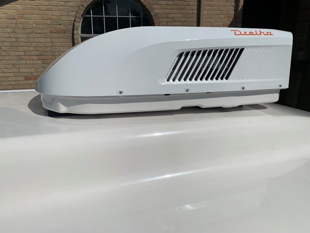

I installed a Dreiha Atmos 4.4 from SDG; 15K AC/12K Heat 120V. I featured my self-install in a post in Ollie Modifications titled ‘Dreiha Atmos 4.4 Home Install’, September 18, 2024. Also checkout @rideadeuce’s install and post titled ‘Dreiha Atmos 4.4 Installed by SDG’, July 17, 2024.
Edited by Ronbrink
