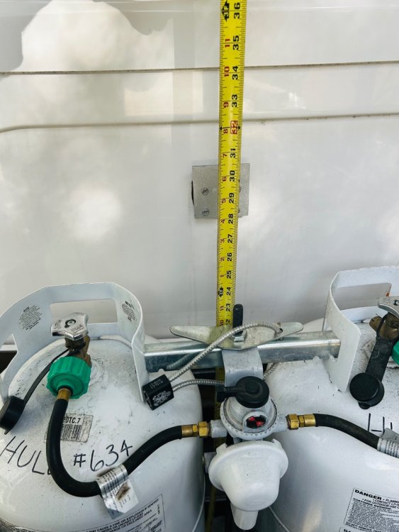

Geronimo John Posted January 27, 2023 Posted January 27, 2023 (edited) I was reading John Davies post for improving the propane tank hoses and it reminded me of a mod I made several years ago. My shorter OEM Propane tanks leaves a lot of excess all-thread to spin up and down at every tank service. I thought about cutting the all-thread shorter, but discarded the idea as the next owner down the road may be a cold weather camper and want the taller tanks. My solution was to grab out of my garage a pair of washers and some tubing that would fit over the all-thread. I cut the tubing to leave about an inch of all-thread showing. One washer on each side of the tubing and I only have to spin off the wing nut about an inch. Saves time and knuckle damage. Cost: $0.00 GJ Edited January 27, 2023 by Geronimo John Picture cut and pasted from John Davies hose mod thread. 1 8 TV: 2019 F-150 SuperCrew Lariat, 3.5L EcoBoost, 10 Speed Trans, Max Tow, FX-4, Rear Locker OLLIE: 2018 OE2 Hull 342, Twin Bed. OLLIE DIY’s: Timken Bearings, BB LiFePO4's, Victron 712 Smart, 350 Amp Master Switch, Houghton 3400, Victron Orion DC - DC, 3000-Watt Renogy Inverter, P.D. 60-amp Converter, Frig Dual Exhaust Fans, Kitchen Drawer Straps. Front Wardrobe Shelves, Snuggle Shelf. TV DIY’s: 2 5/16" Anderson System, Nitto recon’s, Firestone Rear Air Bags, Bilstein 5100’s, Mud Flaps & Weather Tech all, installed Ham Radio (WH6JPR).
Patriot Posted January 28, 2023 Posted January 28, 2023 I opted to go a different route and use the wing nut as a lock. I used a drill bit and an old firearms cable lock to at least try and secure the tanks. I could have used a padlock I suppose. This cable lock has molded plastic around the lock and won’t rattle or bang on the tanks under tow. Can it be defeated? Yes as most locks can be. It may slow a thief down. When I switched over to 30# tanks I installed a shorter threaded rod readily available at Lowe’s or HD. Patriot🇺🇸 1 5 2020 OLEII - Hull #634 aka- “XPLOR” 2021 F350 6.7 liter Diesel Lariat Ultimate Tremor aka - “Beast of Burden” Truma Aventa 13.5 AC, Alcan 5 leaf pack, Alcan HD shackles & HD wet bolts, 5200lb never lube axles.XPEL 10 mil PPF front both front corners, 30 lb LP tanks, Sea Biscuit Front Cargo Storage box. ⚡️⚡️11/2025- Lithium upgrade to XPLOR - (2) Epoch 300ah Lithium batteries, Victron 3000W MultiPlus-II, Victron GX Touch 70, Victron Cerbo GX, Victron Smart Solar MPPT, Victron Smart Shunt, Victron Orion XS 1400 DC-DC charger, RV Soft Start. Zamp 90W suit case solar panel for 420W of solar.⚡️⚡️ North Carolina

Ollie-Haus Posted January 28, 2023 Posted January 28, 2023 1 hour ago, Patriot said: I opted to go a different route and use the wing nut as a lock. I used a drill bit and an old firearms cable lock to at least try and secure the tanks. I could have used a padlock I suppose. This cable lock has molded plastic around the lock and won’t rattle or bang on the tanks under tow. Can it be defeated? Yes as most locks can be. It may slow a thief down. When I switched over to 30# tanks I installed a shorter threaded rod readily available at Lowe’s or HD. Patriot🇺🇸 These are all great little fixes that I'm sure I'll utilize once Ollie-Haus arrives. I'm OCD about fixing the little things that can be improved for everyday use. BTW I recognized that Springfield Armory pistol lock you used on your tanks immediately!😆 I own more than one version of the XDm line they offer and each comes with the same lock. You've discovered a better use for it. 😉 5 What's today?............. the most frequently asked question as a retiree 🙄 Chris and Stacie Neuhaus and Cohen the fearless Border Terrier, Greenfield, Indiana 2021 Ford F350 7.3L Tremor (Redzilla) LE2 #1373 - Ordered 10/21/22 - Delivered 05/10/23

Patriot Posted January 28, 2023 Posted January 28, 2023 49 minutes ago, Ollie-Haus said: These are all great little fixes that I'm sure I'll utilize once Ollie-Haus arrives. I'm OCD about fixing the little things that can be improved for everyday use. BTW I recognized that Springfield Armory pistol lock you used on your tanks immediately!😆 I own more than one version of the XDm line they offer and each comes with the same lock. You've discovered a better use for it. 😉 That’s all a part of making your Ollie yours! 👍🏻👍🏻😊 2 2020 OLEII - Hull #634 aka- “XPLOR” 2021 F350 6.7 liter Diesel Lariat Ultimate Tremor aka - “Beast of Burden” Truma Aventa 13.5 AC, Alcan 5 leaf pack, Alcan HD shackles & HD wet bolts, 5200lb never lube axles.XPEL 10 mil PPF front both front corners, 30 lb LP tanks, Sea Biscuit Front Cargo Storage box. ⚡️⚡️11/2025- Lithium upgrade to XPLOR - (2) Epoch 300ah Lithium batteries, Victron 3000W MultiPlus-II, Victron GX Touch 70, Victron Cerbo GX, Victron Smart Solar MPPT, Victron Smart Shunt, Victron Orion XS 1400 DC-DC charger, RV Soft Start. Zamp 90W suit case solar panel for 420W of solar.⚡️⚡️ North Carolina

Geronimo John Posted January 28, 2023 Author Posted January 28, 2023 9 hours ago, Patriot said: I opted to go a different route and use the wing nut as a lock Our approaches tackle different topics. Mine saves time and knuckle damage. I do note that your all-thread rod is MUCH shorter than the one that came on my 2018 OE2. With your shorter all-thread this mod may not be necessary. But it still raise the wing nut up away from the tank shrouds a bit. Yours mod would for sure improve security and is also really easy to do. With your fire arms lock, you have spare cable to raise your wing nut up as well as improving security too. I like it! 1 3 TV: 2019 F-150 SuperCrew Lariat, 3.5L EcoBoost, 10 Speed Trans, Max Tow, FX-4, Rear Locker OLLIE: 2018 OE2 Hull 342, Twin Bed. OLLIE DIY’s: Timken Bearings, BB LiFePO4's, Victron 712 Smart, 350 Amp Master Switch, Houghton 3400, Victron Orion DC - DC, 3000-Watt Renogy Inverter, P.D. 60-amp Converter, Frig Dual Exhaust Fans, Kitchen Drawer Straps. Front Wardrobe Shelves, Snuggle Shelf. TV DIY’s: 2 5/16" Anderson System, Nitto recon’s, Firestone Rear Air Bags, Bilstein 5100’s, Mud Flaps & Weather Tech all, installed Ham Radio (WH6JPR).

Patriot Posted January 29, 2023 Posted January 29, 2023 2 hours ago, Geronimo John said: Our approaches tackle different topics. Mine saves time and knuckle damage. I do note that your all-thread rod is MUCH shorter than the one that came on my 2018 OE2. With your shorter all-thread this mod may not be necessary. But it still raise the wing nut up away from the tank shrouds a bit. Yours mod would for sure improve security and is also really easy to do. With your fire arms lock, you have spare cable to raise your wing nut up as well as improving security too. I like it! Thanks! As a side note I have no intention of ever bumping up to 40# LP tanks. 30 pounders are plenty for our needs. I was curious to just measure and see if 40# would fit to help answer dewdev’s question. I’ll take a pass on be bending the wing nut up as it really has not posed any concerns for me when removing it. Once it’s loose it just about spins off. Onward! Patriot🇺🇸 3 1 2020 OLEII - Hull #634 aka- “XPLOR” 2021 F350 6.7 liter Diesel Lariat Ultimate Tremor aka - “Beast of Burden” Truma Aventa 13.5 AC, Alcan 5 leaf pack, Alcan HD shackles & HD wet bolts, 5200lb never lube axles.XPEL 10 mil PPF front both front corners, 30 lb LP tanks, Sea Biscuit Front Cargo Storage box. ⚡️⚡️11/2025- Lithium upgrade to XPLOR - (2) Epoch 300ah Lithium batteries, Victron 3000W MultiPlus-II, Victron GX Touch 70, Victron Cerbo GX, Victron Smart Solar MPPT, Victron Smart Shunt, Victron Orion XS 1400 DC-DC charger, RV Soft Start. Zamp 90W suit case solar panel for 420W of solar.⚡️⚡️ North Carolina

Patriot Posted January 29, 2023 Posted January 29, 2023 11 minutes ago, dewdev said: Patriot: You firearms cable lock is a great way to secure the tanks. Is security of the propane tanks really necessary? Has anyone had their tank(s) stolen? If so, I will be looking to secure my tanks as well. Thanks dewdev, Along with @topgun2 I have not heard of any Oliver owners having their tanks stolen. And hope it remains that way. This mod along with the fact that my 30# tanks are not as common as the 20# tanks may possibly serve as a real deterrent or may not. I also write my hull# on the tanks as I don’t swap them out I just get them refilled. Patriot🇺🇸 3 2020 OLEII - Hull #634 aka- “XPLOR” 2021 F350 6.7 liter Diesel Lariat Ultimate Tremor aka - “Beast of Burden” Truma Aventa 13.5 AC, Alcan 5 leaf pack, Alcan HD shackles & HD wet bolts, 5200lb never lube axles.XPEL 10 mil PPF front both front corners, 30 lb LP tanks, Sea Biscuit Front Cargo Storage box. ⚡️⚡️11/2025- Lithium upgrade to XPLOR - (2) Epoch 300ah Lithium batteries, Victron 3000W MultiPlus-II, Victron GX Touch 70, Victron Cerbo GX, Victron Smart Solar MPPT, Victron Smart Shunt, Victron Orion XS 1400 DC-DC charger, RV Soft Start. Zamp 90W suit case solar panel for 420W of solar.⚡️⚡️ North Carolina

Geronimo John Posted February 1, 2023 Author Posted February 1, 2023 On 1/28/2023 at 2:19 PM, Patriot said: I’ll take a pass on be bending the wing nut up I as well. Being in Honolulu and Ollie on the mainland, I could not grab a picture of my mod, but wanted readers to "see" the topic. So I borrowed John D's picture. TV: 2019 F-150 SuperCrew Lariat, 3.5L EcoBoost, 10 Speed Trans, Max Tow, FX-4, Rear Locker OLLIE: 2018 OE2 Hull 342, Twin Bed. OLLIE DIY’s: Timken Bearings, BB LiFePO4's, Victron 712 Smart, 350 Amp Master Switch, Houghton 3400, Victron Orion DC - DC, 3000-Watt Renogy Inverter, P.D. 60-amp Converter, Frig Dual Exhaust Fans, Kitchen Drawer Straps. Front Wardrobe Shelves, Snuggle Shelf. TV DIY’s: 2 5/16" Anderson System, Nitto recon’s, Firestone Rear Air Bags, Bilstein 5100’s, Mud Flaps & Weather Tech all, installed Ham Radio (WH6JPR).

MAX Burner Posted March 11, 2023 Posted March 11, 2023 Well, Patriot - I totally copied your great idea for the LPG tank crossbar wing nut & Springfield XD slide-lock mod... "Tanks" a lot, brother! 1 1 Art, Diane, Magnus & Oscar (double-Aaarrf!) (SOLD) 2022 TUNDRA (SOLD) 2017 LE II; Hull #226 "Casablanca" HAM call-sign: W0ABX

Patriot Posted March 11, 2023 Posted March 11, 2023 2 hours ago, MAX Burner said: Well, Patriot - I totally copied your great idea for the LPG tank crossbar wing nut & Springfield XD slide-lock mod... "Tanks" a lot, brother! Haha! Looks great! And a fine use of the XD cable lock. Tank you! Just passing it forward! 😅 Patriot🇺🇸 1 1 2020 OLEII - Hull #634 aka- “XPLOR” 2021 F350 6.7 liter Diesel Lariat Ultimate Tremor aka - “Beast of Burden” Truma Aventa 13.5 AC, Alcan 5 leaf pack, Alcan HD shackles & HD wet bolts, 5200lb never lube axles.XPEL 10 mil PPF front both front corners, 30 lb LP tanks, Sea Biscuit Front Cargo Storage box. ⚡️⚡️11/2025- Lithium upgrade to XPLOR - (2) Epoch 300ah Lithium batteries, Victron 3000W MultiPlus-II, Victron GX Touch 70, Victron Cerbo GX, Victron Smart Solar MPPT, Victron Smart Shunt, Victron Orion XS 1400 DC-DC charger, RV Soft Start. Zamp 90W suit case solar panel for 420W of solar.⚡️⚡️ North Carolina
