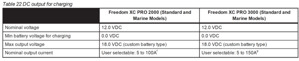

HDRider Posted May 2, 2023 Author Share Posted May 2, 2023 19 hours ago, ScubaRx said: The onboard charger is 45-150 amps depending on the type you have. Do you know the capabilities of the onboard charger that comes with the 2023 Lithium Pro package? Jeff & Cindy - NE Arkansas - 2023 Legacy Elite II - Twin Bed - Hull #1423 TV - 2015 Silverado 2500 Duramax 4x4 Link to comment Share on other sites More sharing options...
Galway Girl Posted May 2, 2023 Share Posted May 2, 2023 I believe you have the 3000 Watt Xantrex Pro Charger with that package. The OUTPUT Current for charging is user selectable from 5 to 150 Amps. If you are running on Shore Power/30A connection then this setting is usually set for 150Amps. If you are running connected to a generator (not shore power) then what it delivers will depend upon the power output available from the generator. If 1 4 2019 Elite II (Hull 505 - Galway Girl - August 7, 2019 Delivery) Tow Vehicle: 2021 F350 King Ranch, FX4, MaxTow Package, 10 Speed, 3.55 Rear Axle Batteries Upgrade: Dual 315GTX Lithionics Lithiums - 630AH Total Inverter/Charger: Xantrex 2000Pro Travel BLOG: https://4-ever-hitched.com Link to comment Share on other sites More sharing options...
johnwen Posted May 2, 2023 Share Posted May 2, 2023 1 hour ago, Galway Girl said: I believe you have the 3000 Watt Xantrex Pro Charger with that package. The OUTPUT Current for charging is user selectable from 5 to 150 Amps. If you are running on Shore Power/30A connection then this setting is usually set for 150Amps. If you are running connected to a generator (not shore power) then what it delivers will depend upon the power output available from the generator. If Galway Girl, Thanks for your outfitter's guide. I've ordered several items from it :) John 1 Oliver II #996 "Bessie", 2019 Silverado LTZ 5.3, Veterans https://wenandjohnsadventure.com/ Link to comment Share on other sites More sharing options...
